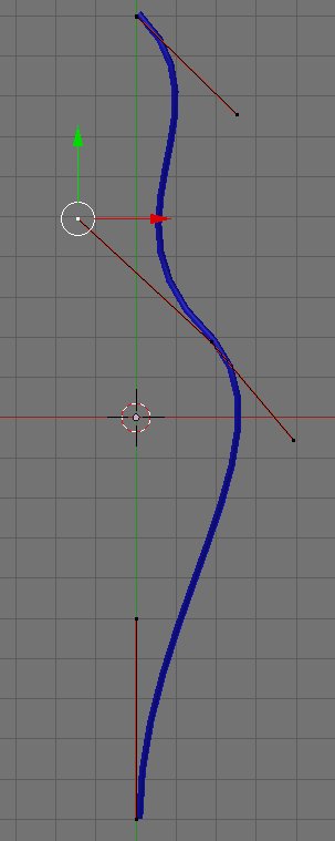

I can't appropriate to control point the negative value...
Why?????
To set the necessary form, I need a negative value!
At the same time the curve doesn't cross null value...
Look attachment:
Download 'lathe.jpg' (27 KB)
Preview of image 'lathe.jpg'

P0,P3 belong a curve, P1 of P2 don't belong a curve.
If P1 = (-2,2), they won't be replaced by a point (2,2).
Other curve will turn out absolutely.
In order that all points of a curve were in positive coordinates, not
necessarily that P1 and P2 also were in positive coordinates.
In the case provided by me the ideal surface of revolution shall turn out.
Restriction from povray is unjustified.

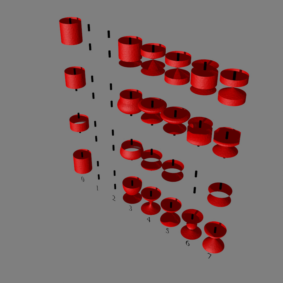

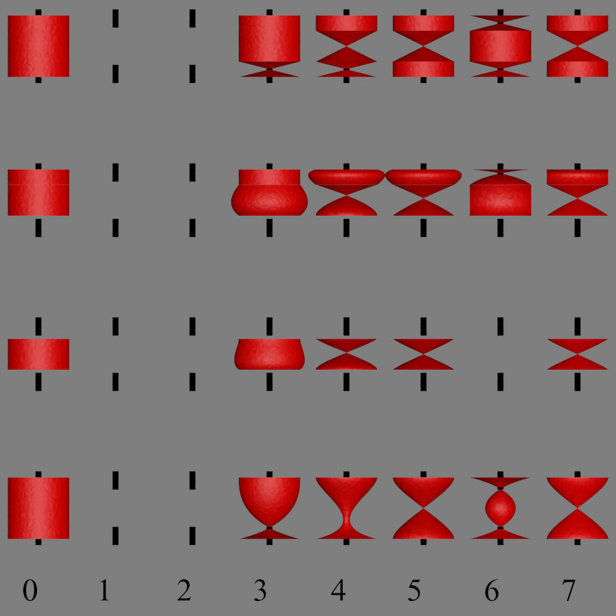

OK some test results from negative lathe spline values with the current
parse checking off. All splines used have 4 points.
The four rows, top to bottom, are linear, quadratic, cubic and bezier
splines respectively.
The columns 1-7 are:
0 - All X coordinates are positive.
1 - All X coordinates are negative.
2 - All X coordinates are 0.
3 - First point's X coordinate is negative.
4 - Second point's X coordinate is negative.
5 - First and second point's X coordinates negative.
6 - Second and third point's X coordinates negative.
7 - Third and fourth point's X coordinates negative.
I think I covered all the cases somewhat, but if not let me know.
To my eyes we get what one might expect(1) with negative coordinates, so
running with better warnings or no checking at all of the points in the
spline is probably OK.
Bill P.
(1)- except perhaps that quadratic is a bit noisy, but probably it is
not much used.
Download 'orthographic.jpg' (85 KB) Download 'perspective.jpg' (80 KB)
Preview of image 'orthographic.jpg'
Preview of image 'perspective.jpg'
