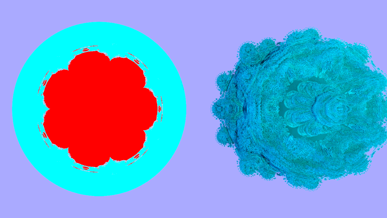

Here is an Image, taken with the characteristic function (0 or 1) of the
mandelbulb. I can see no flaws with this isosurface.
Best regards,
Michael

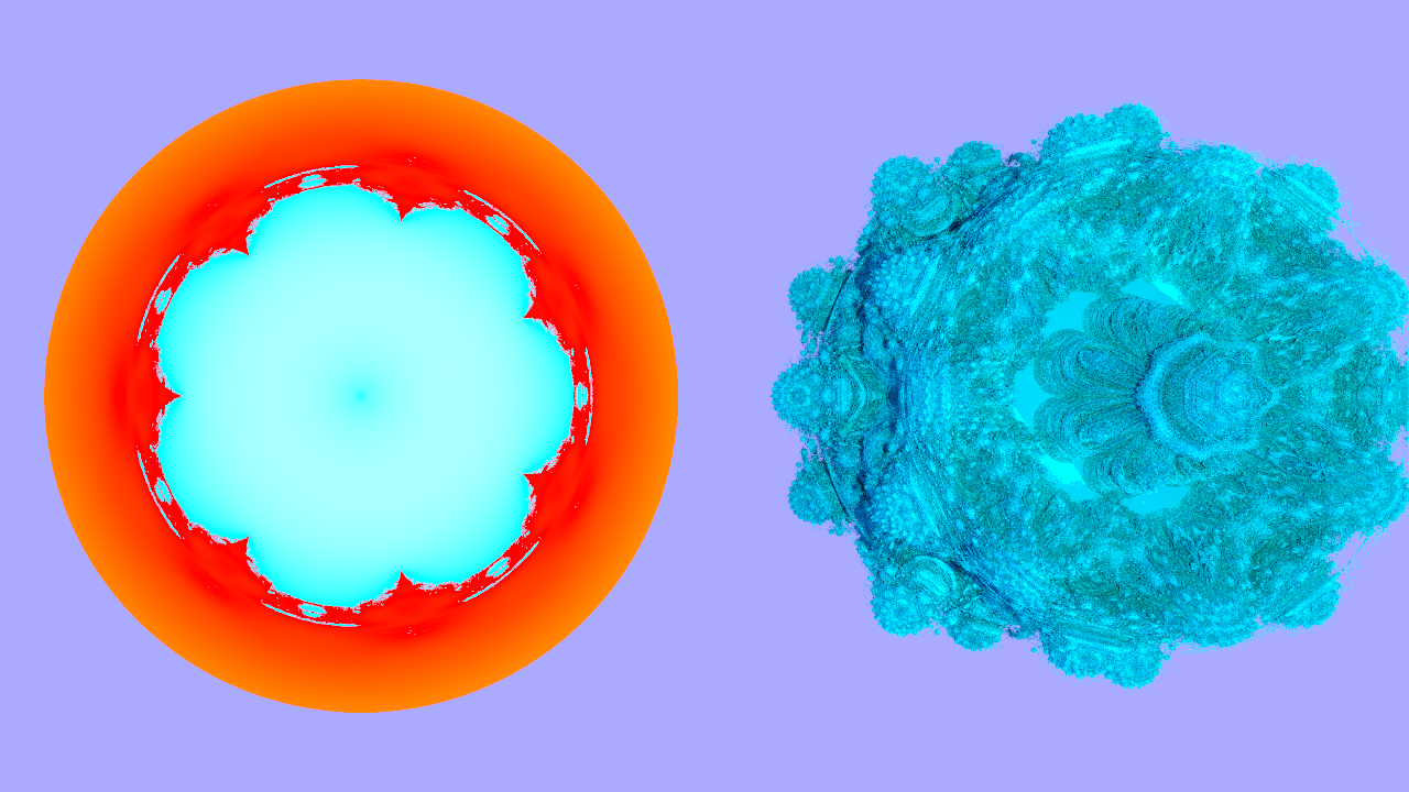

Here is the first of two technical images,  the third can be ruled out. As I
first studied the discussion between Waggy and Tor Olav I misunderstood the
given explanations there. See
http://news.povray.org/povray.binaries.scene-files/thread/%3C4b2c7b3f%40news.povray.org%3E/
Tor Olav states there that his distance estimation function has to be improved
likely. And Waggy explained the idea behind this functions but I was to stupid
to comprehend this at first reading. In fact the original code of Tor Olav
rendered 31 minutes, but yielded a very smooth superset of the mandelbulb only.
There exists a lot of alternative formulas to generate mandelbulb like
structures. One of them is the use of the inbuild functions f_th and f_ph from
functions.inc, which return polar coordinates. Tor Olav uses this approach but
it is different from the mandelbulb first posted ever. I changed this in his
code to the original formula.
Despite the claim within the POV-docs that atan2(A,B) can handle the value B=0
("Returns appropriate value even if B is Zero") I get range violations in this
case and the render fails. So I had to use a work around. Simple, but may the
one or other can use it (see code below).
I still kept Tor Olav's wonderful technique to turn a recursive function into an
iterative one since recursive function calls are not supported by POV
officially. In most cases they work, but it is not guaranteed.
Here is the image using the distance estimation function proposed by Scott. I
still observe some problems (there seems to be some kind of bridges at the
right). To the left is an visualisation of the mandelbulb function as a pigment
function taken at the middle of the container object. It uses
   color_map {
      [0 Red ]
      [0.5 Yellow ]
      [1 Cyan ]
I rendered this to get a better understanding of the distance estimation
function (orange to red here). Note that Cyan indicates negative values close to
zero here (and not close to one).
Rendering time was 18 h 28 m. I think Scott's GPU approach will be a little bit
faster then POV.
Best regards,
Michael

From: scott
Subject: Re: isosurfaces problems
Date: 16 Nov 2015 03:21:08
Message: <564991f4$1@news.povray.org>
The Max_Iterations limit will control how smooth or detailed the surface
is. 64 is really a bit OTT for a render that shows the entire
mandelbulb, I primarily put it that high so that when you zoomed right
in there was still a lot of detail. You might try reducing it to speed
things up.
>     color_map {
>        [0 Red ]
>        [0.5 Yellow ]
>        [1 Cyan ]
That's a good idea, I hadn't thought of that - it's interesting to see
what the range of values actually is.
> faster then POV.
Well mine (obviously) depends on the GPU you have available, if you have
a card older than a year or so then it's highly probably it will take an
infinite amount of time to complete :-) On a modern nVidia 970 it can
manage of the order of 10fps, which means after 5-10 seconds you've got
a nice anti-aliased image (once you stop moving the camera it
continually averages the new frames together).

along the ray POV determines the largest sphere that doesn't intersect
the surface. It then moves the radius of this sphere along the ray and
repeats. The radius of the "largest sphere" is determined by the
function value at that point divided by the "max_gradient".
The fact it takes longer with the D.E. function might be because you
have not optimised "max_gradient" in the isosurface. "max_gradient"
needs to be chosen specifically for each function you use in an
isosurface. In your D.E. version I was able to reduce it from 1000 to
0.5 without any obvious impact on the image (you will probably need to
experiment a bit to determine the optimum value). Max_Iterations
probably doesn't need to be as high as 64 for a wide-angle shot of the
entire mandelbulb.
