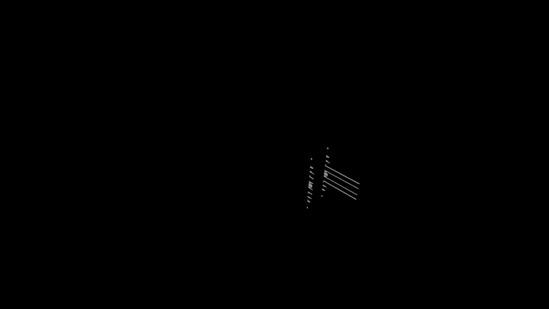

The antennas on the right side should be identical to the antennas at the left
side, but they aren't. Unless I miss to discover since several hours an error on
my side, I think, I have discovered a serious programming fault in the new
POV-Ray 3.7.
Please test my scene source code and give me a feedback. Thanks.
On a side note: it seems I also discovered another programming fault: when
animating (clock), the final video show some sort of black vertical line (a
cut-out?) where nothing is supposed to be. Please view here the video:
https://www.facebook.com/video.php?v=1032986830049905&set=vb.100000157941289&type=3

difference
 union
  box { < -62.5, -200.0, -325.0 > < -61.0, 200.0, -300.0 > }
  box { <  61.0, -200.0, -500.0 > <  62.5, 200.0, -300.0 > }
 HullCommandFrontCutout(125,10.0,150.0,275.0,TextureHullSide)
 texture { TextureHullSide }

Subject: Re: POV-Ray 3.7: Symmetry Compromised?
Date: 29 Mar 2015 07:20:55
Message: <5517e017$1@news.povray.org>
> POV-Ray 3.7.
The fault is all yours.
Replace:
by:
     box { < -62.5, -200.0, -500.0 > < -61.0, 200.0, -300.0 > }
in your difference block and all is symmetrical.

From: Sven Littkowski
Date: 29 Mar 2015 22:05:00
Message: <web.5518ae3efbee1e085189b500@news.povray.org>
Yeah yeah yeah, just give it to me...   :-)
Thanks, I will try out that correction.
Date: 29 Mar 2015 23:20:00
Message: <web.5518c0c2fbee1e085189b500@news.povray.org>
Sometimes, so it seems, it's hard to see the forest because of all the trees...
Date: 30 Mar 2015 03:09:33
Message: <5518f6ad$1@news.povray.org>
I do agree indeed. I plodded along that same road so many times... :-)
From: jhu
