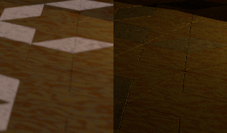

I'm working on a scene using textures from stones.inc, and I've noticed large
differences in the appearance of certain textures when rendered with radiosity.
the left side is without radiosity, the right side is with.  The primary texture
is T_Stone43 and the secondary is T_Stone39
I know that this is the result of ambient values in the textures, but the
difference seems a little severe even so.
I can't really experiment with the settings much, as my scene takes almost two
days to render with radiosity, and that's using -RVP and giving povray top
priority on processor usage.

On the left, the ambient part of the textures makes them visible.
On the right side, there is NO ambient, and obviously, there is no
actual light and no object with emission in it's finish.
When rendering using radiosity, the ambient component of the textures is
turned OFF. You need to add emission float to the finish to make the
texture glow.
You can add a skysphere whitch, by default, is emissive.
You can add at least one actual light_source.
You can add some large object with
texture{pigment{rgb 1}finish{emission 1}}

There is light, it's just not in this area.
I have six light sources.  There is no difference in lighting between the two
samples. Granted the part I'm wondering about is in moderate shadow, but it
should be receiving some of the light.  The primary texture is at least the same
color when rendered with radiosity, which indicates to me that the color of the
secondary relies too much on it's ambient value.

Adding to the finish(es) an emission value that matches the existing ambient
value should fix that issue completely when using radiosity.

This is all because the textures were designed before radiosity got
widespread use (maybe even before the feature ever existed), and they
were quite obviously designed for effect, rather than from physical
principles.
Materials from stock commercial 3D models (like, say, from Renderosity,
DAZ3D or the like) suffer from this very same problem: Someone starts
with their favourite light setup, tweaks a figure's material until it
looks good, and then sells it for money. But it never fits with other
people's models, because they are tweaked to look best with some other
light setup.

So I guess the question is: Does the emission keyword supercede ambient? should
the textures in the libraries be updated to reflect that?
>> www.McGregorFineArt.com
NO ! and NO !
> and thanks for the tips on HDRI.  Now I just need a step-by-step tutorial on how
> to use it in scene.
> Regards,
> A.D.B.
ambient is meant as a cheap alternative to diffuse inter-reflection that
radiosity does.
emission is meant for textures that actualy *emit* light. Adding
emission to most textures will wrongfully make them emit light in
radiosity scenes.
emission never supercede ambient, they are totaly different beasts.
Most textures using high ambient are probably for simulating some amount
of translucency. For example, PinkAlabaster is a fairly translucent
stone and the texture for it have a high ambient. Beter done using
subsurface that ambient, but much slower...
If you look at the metal textures, they have insane ambient that looks
resonably good when alone with a black background. Add any environment,
and it becomes unrealistic and often bad looking.
