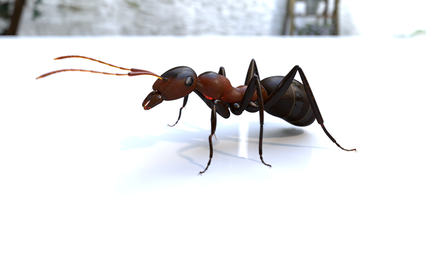

Hi,
Thought I was getting used to using SSLT but I think I have something wrong
somewhere as my poor ant looks like he is about to spontaneously combust..
I am probably doing something stupid so feel free to point it out, I have had a
few attempts at adjusting the SSLT settings but I seem to go from not much
effect to burning him, any ideas/tips would be really appreciated (the most
appreciated thing would be faster SSLT though ;-)
I am trying to make something similar to
http://jonlieffmd.com/wp-content/uploads/2012/02/Ant-individual-.jpg where the
light can be seen to pass through parts of the ants body.
The ant is made of a few blobs (don't think they are the issue though).
My fear is that it is just not enough samples..
Subsurface settings in global_settings:
global_settings {
#if(useSubSurface)
  mm_per_unit 10
  subsurface { samples 50, 10 radiosity on}// do another render with this on..
#end
Texture for the part that seems to glow:
#declare antMat = material {
texture
  gradient y
  scale 2
  turbulence 0.025
  translate <0, 0.075, 0>
  omega 0.7
  lambda 2.8
  triangle_wave
  texture_map
    [ 0.45  pigment{ granite  triangle_wave colour_map { [ 0.0 color rgb
antColourLight*0.8 ] [ 0.0 color rgb antColourLight*0.2 ] [ 1.0 rgb
antColourLight*0.7 ] } turbulence 0.2 omega 0.65 lambda 3.2 scale 0.1 }
            finish { specular albedo 0.1 roughness 0.0015 diffuse albedo 0.6,
0.2 brilliance 0.9 reflection { 0.005, 0.025 fresnel on } conserve_energy
            #if(useSubSurface)
              subsurface { translucency <.4, .6, 0.1>*9 }
            #end
            normal { granite 0.2 scallop_wave scale 0.007 turbulence 0.3 omega
0.7 }
     [ 0.6  pigment{ granite triangle_wave  colour_map { [ 0.0 rgb antColour*0.2
] [ 1.0 rgb antColour*0.1 ] } turbulence 0.5 omega 0.8 lambda 2.5 scale 0.1 }
            finish { specular albedo 0.1 roughness 0.0015  diffuse albedo 0.5,
0.1 brilliance 1.2 reflection { 0.005, 0.035 fresnel on } conserve_energy
            #if(useSubSurface)
              subsurface { translucency <.4, .6, 0.1>*2 }
            #end
0.7 }
   scale <0.35, 1, 2>
 interior { ior 1.6 }
Lighting is an HDR probe plus 1 area light.
Any help/tips greatly appreciated.
Thanks
Sean
Download 'ant.png' (447 KB)
Preview of image 'ant.png'

Am 02.06.2014 19:07, schrieb s.day:
Blobs? Are you serious? That's one hot hell of an ant you have there!
(No surprise it's about to combust ;-)) I'd have expected it to be some
commercial mesh model.
No, the samples are probably ok, they just affect how noisy the result is.
Are those perhaps transitions between multiple separate blob objects?
Probably a major obstacle you're facing is that ants /are/ pretty
translucent inside, it's mostly the exoskeleton that gives them their
tint. Maybe layering a semi-transparent non-SSLT texture (or a
semi-transparent SSLT texture with low translucency) over a
high-translucency texture might do the trick.
Thanks, I guess it is actually 13 blobs, one for each leg, antennae and mandible
then the head and each section of the body. The eyes are just spheres and the
hairs are cones so not 100% a blob ant but close.
Ahh, that is good to know as now I have started using SSLT I seem to find images
without it a bit less interesting but did not want to have to increase the
samples too much due to lack of patience ;-)
No, that section is made from a single blob, I did have some artifacts at one
point where the mandibles met the head with an earlier version but that has been
corrected with the latest mandibles (still need to do a bit of work on the
texture of these I think they are too shiny).
Now I know it is not samples maybe I can lower them a bit and try some different
options/variations as it will be a bit faster, it seems increasing the
mm_per_unit helps to reduce the glow but getting it just right is the problem as
if I reduce it too much the effect is no longer as good.
Thanks again for responding your advice is always very helpful.

Am 03.06.2014 00:49, schrieb s.day:
Leave the mm_per_unit setting be; it should always match the actual
scale of the object.
Any effect that can be achieved by tweaking mm_per_unit can also be
achieved by tweaking the materials' translucency.
> Thanks
> Sean
Why you don`t adapt your gradient texture?
From my perspective, it's a povray prob (of sslt), not your adaption.
Personally speaking I always use gray colors for sslt, but I'm far of being
experienced like you... (I admire your starfish...)
