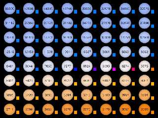

I used CIE.inc from LightsysIV to display black body colors at various
temperatures.  As the temperature increased, I expected the color to become
yellower before it turned white.  Instead, I could not discern any change in
hue.
I figured that the change in hue might be too subtle for me to detect, so I
#debugged the hues.  Too my surprise, after becoming slightly yellower, the hue
doubled back on itself and got redder, then onto magenta, violet, and blue.
Is this right?  If so, why do candle flames (glowing soot particles) look
yellower than glowing coals?  Could it be a whitepoint issue?  Floating point
accuracy?  That warning that splines are an experimental feature?
The attached image shows my results, with a fully-saturated swatch to the lower
right of each sample.

	Looks right to me, the color goes from red (cool) to blue (hot),
going through yellow and magenta:
http://en.wikipedia.org/wiki/File:PlanckianLocus.png (the magenta
appears white on this image).
		Jerome

Am 10.10.2011 19:23, schrieb Cousin Ricky:
> hue.
> Is this right?
Yes.
Because the flame of a candle is far away from being a perfect blackbody
radiator.
As the whitepoint of sRGB (the default color order system from CIE.inc)
this temperature. And only *close* because the sRGB whitepoint is
defined as a D-illuminant (and is implemented as the Daylight macro
within CIE.inc) and this is not quite identical to blackbody.
> Floating point
Looks good to me.
