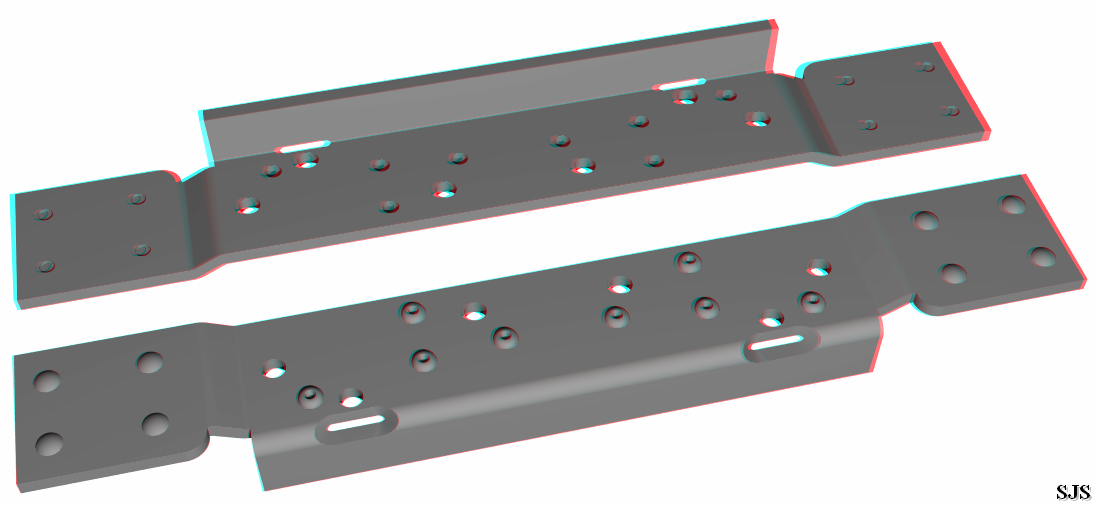

A gray scale anaglyph viewable with red/cyan 3d glasses.
A door hinge attachment plate that would be welded on the inside of a steel
frame. Both sides of the same style. This would be called a convertible hinge
plate. A standard weight hinge will fit ontop of the bumps (with dimple) and
removing the bumps (grinder or drill) would accommodate a heavy weight hinge.
The four bumps on the ends are for resistance spot welding.
To be fixed:
Four of the holes should be threaded.
The slot in the 90 degree bent part needs fixing. I should be using only half of
the  sheared cone.
Comments welcome:
Stephen S
