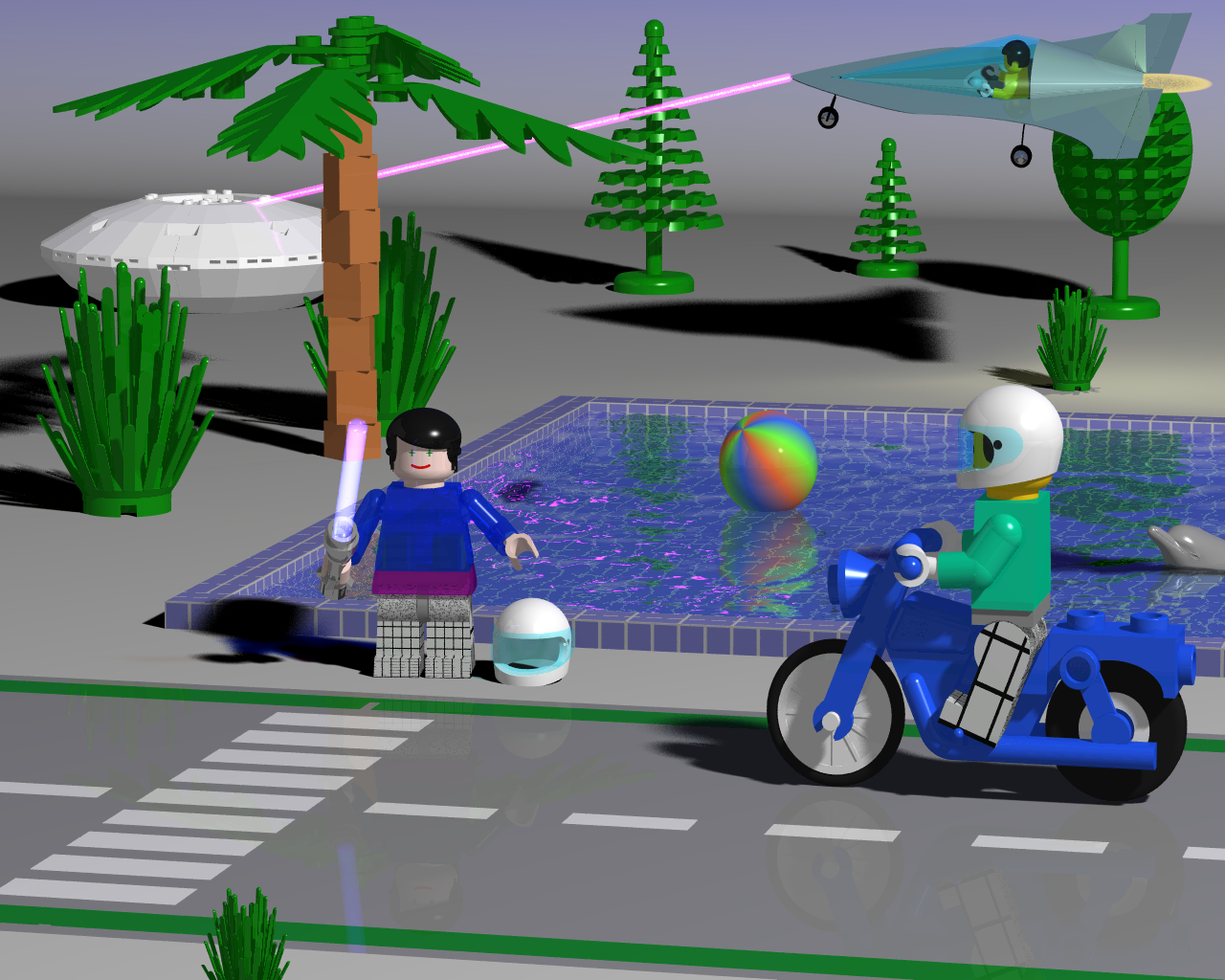

Free dolphin for the texture geniuses.
http://www.3dnuts.com/models.shtml
Takes 2 minutes to access with poseRay.
4 models in the 3ds file, 2 are dolphins.
Dolphin7 is the first one @ 500kb.
Download 'lego_pool_04e.png' (683 KB)
Preview of image 'lego_pool_04e.png'
