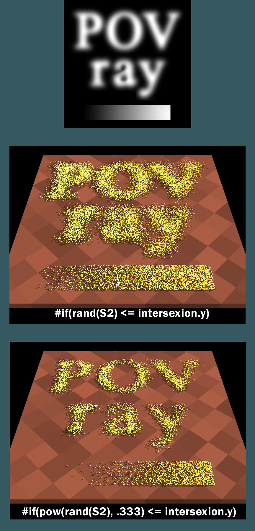

Here's a simple demonstration, using lots of small spheres as the 'sprayed-on'
objects (intersexion.y is the height found at any point on the masking HF):
#declare mask =
height_field{jpeg "my blurry image.jpeg"} // this is never seen, just used as a

#declare intersexion =
trace(mask,trace_position, <0,-1,0>) // no norm used here, to keep things simple
#if(rand(S2) <= intersexion.y) // This is the KEY! If *true* a sphere is made.
sphere{0, .001 translate <intersexion.x,0,intersexion.z> // the many small
                                                         // spheres

How this works: If intersexion.y is, say, .2--corresponding to a low point on
the HF and a relatively dark pixel in the blurry image_map--and if rand(S2) has
an equal chance of being *anywhere* between 0 and 1 (which it does), then there
is only a 20% chance that rand(S2) will be <= .2, and thus only a 20% chance of
an object being made in that case. (Said another way: If rand(S2) is greater
than .2, no object is made.) If intersexion.y is .9999--representing a very
high point on the HF and a bright pixel in the image_map--then rand(S2) has a
99.99% chance of being at or below that value...meaning that an object WILL be
made, no question. Taken as a whole, the code thins out the number of objects
in the 'blur zone'--more objects in brighter areas, less in darker areas. The
result looks like objects sprayed through an airbrush!
For everything to work as-expected, the blurry image_map grayscale values need
to go from pure black to pure white, so that the resulting traced y-values of
the HF go reliably from 0 to 1. (BTW, "smooth" doesn't have any effect on a HF
when tracing it--that's purely a lighting trick based on normals.) Changing <=
in the code to >= has the effect of inverting the image_map's grayscale
values...resulting in MORE objects in the dark areas, LESS in the bright areas.

fact that a HF's height is in the range of 0 to 1 allows its y-values to be
'bent' with an exponent, while still remaining in the 0-to-1 domain. This
creates, in effect, a non-linear blur--a 'curving slope' of the HF's parts--and
a corresponding subtle change in the 'chance' of an object being made. Hard to
describe, but visually useful. Example:
#if(pow(rand(S2), .333) <= intersexion.y)

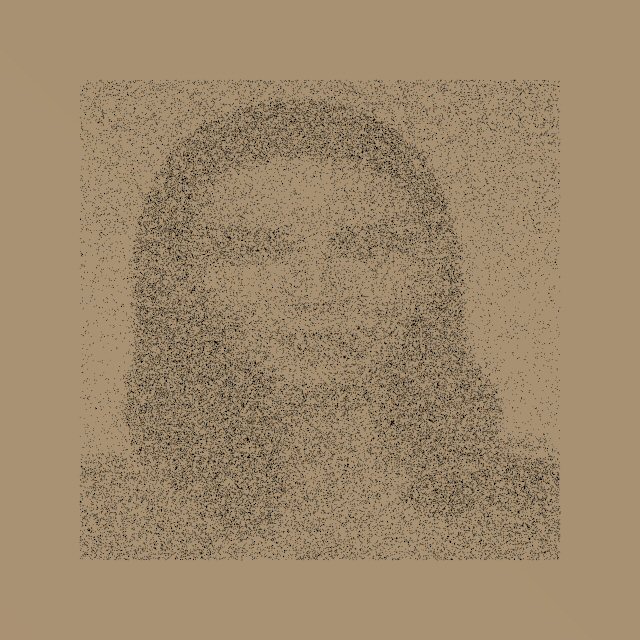

Just a very rapid example, taking a random photograph I had, without
particular blurring I must say, but still a nice result.
Thanks again, Kenneth!!
Download 'Kenneth airbrush.jpg' (103 KB)
Preview of image 'Kenneth airbrush.jpg'

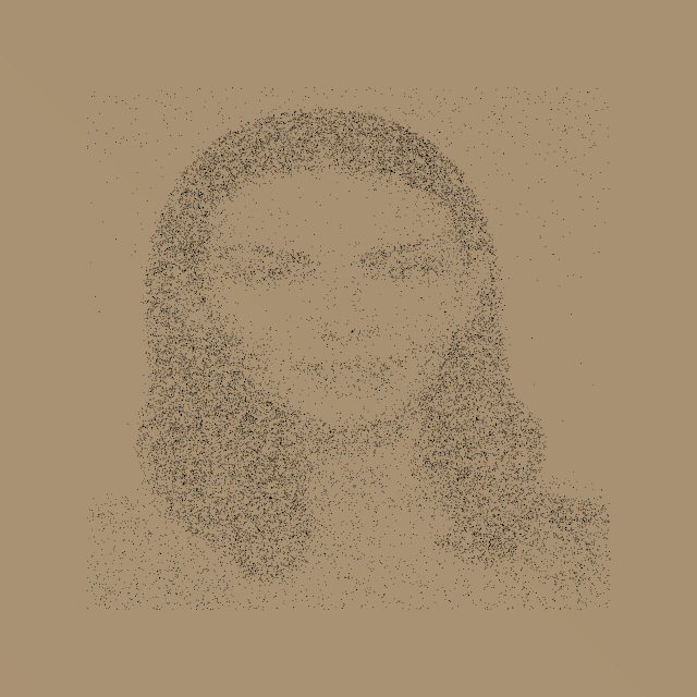

Subject: Re: Tracing an object through a soft-edged mask; or objects as airbrush 'spray'
Date: 13 May 2008 04:38:32
Message: <48295388@news.povray.org>
...and using  pow(rand(S2), .333)....
Download 'Kenneth airbrush2.jpg' (67 KB)
Preview of image 'Kenneth airbrush2.jpg'

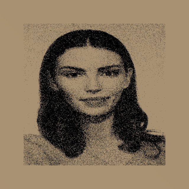

Date: 13 May 2008 04:59:46
Message: <48295882@news.povray.org>
...and increasing the number of objects (x10 Kenneth's example).
And now I stop!  :-)
Download 'Kenneth airbrush3.jpg' (103 KB)
Preview of image 'Kenneth airbrush3.jpg'
