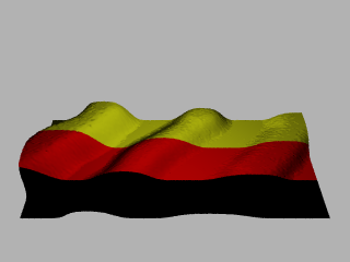

I have a problem with a height_field :
I have made a flag in the wind for an still picture with a height_field and
it looks like ok for me, but now i have to animate the waves of the
height_field image_map ! Is this possible ??
Thanks
Tom33
Download 'height_field.bmp' (226 KB)

Sorry, i will not animate the image_map !! I will animate the height_field
map to simulate wind ;o)
