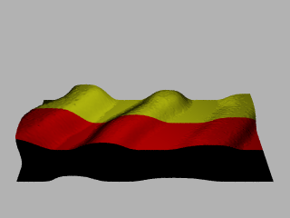

Hi,
I have a problem with a height_field :
I have made a flag in the wind for an still picture with a height_field and
it looks like ok for me, but now i have to animate the waves of the
height_field image_map ! Is this possible ??
Thanks
Tom33
Download 'height_field.bmp' (226 KB)

Sorry, i will not animate the image_map !! I will animate the height_field
map to simulate wind ;o)

thanks for this two methods, yesterday i found Christoph Hormanns Wave
Include-Files like your second method !
I post it in the german www.povray-forum.de in this thread:
http://www.povray-forum.de/viewtopic.php?t=139
Here my small flag-animations:
http://www.povray-forum.de/Tom33/height_field_ani1.avi
http://www.povray-forum.de/Tom33/height_field_ani2.avi
Now, I will try it with your first method ;o)
