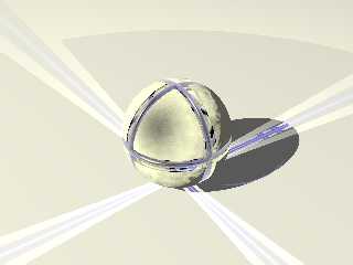

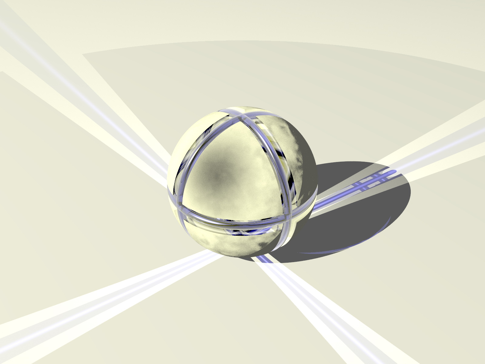

I am currently working on an image where I want some tubes to shine and glow
like neon light. I have added an image to show you the blue tubes I want to
be used as neon lights.
Anyone got a solution for good realistic neon lights? I am currently trying
to accomplish it using multiple lights in the tubes, but that increases the
rendertime bigtime too. Anyone got a better and maybe faster way to do
this?
Kind regards,
NumbC
Download 'test001.jpg' (178 KB)
Preview of image 'test001.jpg'

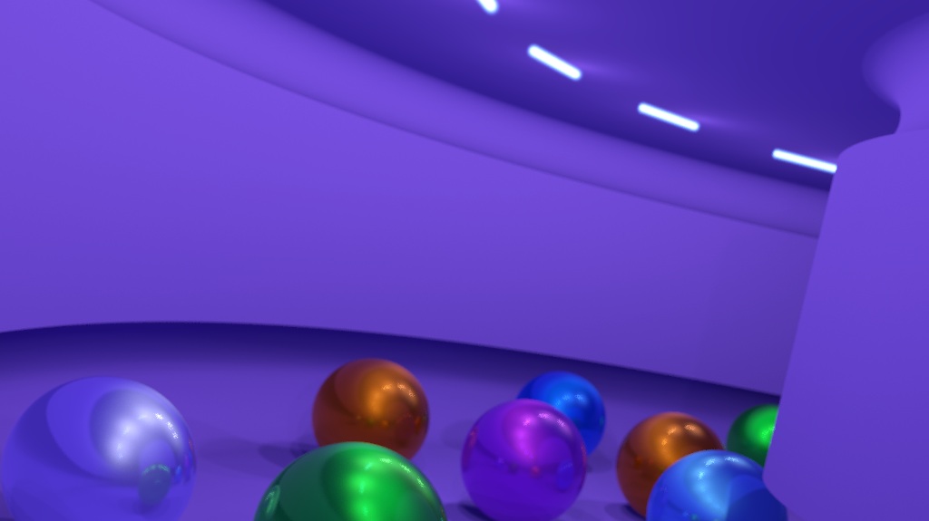

From: Joanne Simpson
Subject: Re: Neon Tubes (Anyone can tell me how to make them emit light)
Date: 7 Sep 2005 21:55:00
Message: <web.431f98c3fb56d428500142a10@news.povray.org>
> As the tubes are transparent, using emiting media should be considered, but this
will also increase
> rendering time.
Emitting media is surprisingly fast. In the image below (of neon tubes)
http://news.povray.org/povray.binaries.images/thread/%3Cweb.42d71153a5704711500142a10%40news.povray.org%3E/?ttop=217682
&toff=100
I used an emitting media with a density map to get some variability in the
light. I also used some scene lighting to get a bit of a hazy glow in the
atmosphere around the lights.
I seem to remember it only took a few minutes, but sadly I lost the file
when my computer was replaced.
Joanne
http://www.onewhiteraven.com

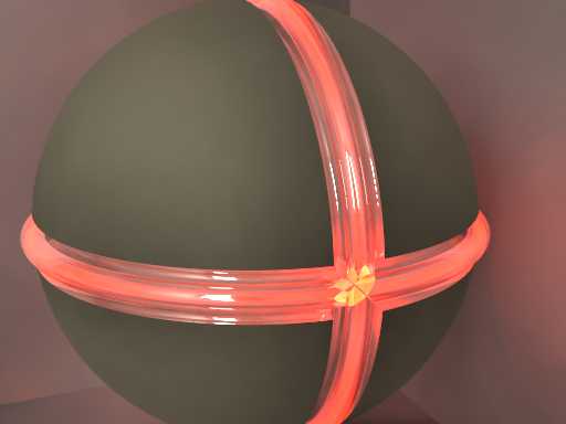

From: Mike Raiford
Date: 8 Sep 2005 09:56:48
Message: <43204320$1@news.povray.org>
I'm with everyone else:
radiosity+emitting media.
It seems your neons are torroidial, so use a torus function, something like:
#declare neon_light =
torus
     2, 0.1
         pigment { color rgbt 1 }
         finish { ambient 4.0 diffuse 0 reflection 0.5}
             hollow
         interior
             media { emission rgb <1, 0.01, 0.001> *15
                 density
                    function { f_torus(x,y,z,2,0.05)}
The radiosity block I used:
     radiosity
        pretrace_start 0.08
        pretrace_end 0.01
        low_error_factor .8
        count 100
        nearest_count 20
        recursion_limit 4
        error_bound 1
        brightness 1
        media on
I'll attached a file of what this will look like. Please excuse me if
the object looks similar. I liked it and wanted to make it look the same
(but makes a darn good demo-scene) :)
Adjust the colors in any way you wish. I chose a more typical red for
the neon.
~Mike
Things! Billions of them!

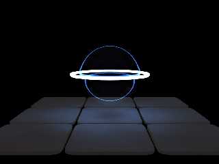

From: NumbC
Date: 9 Sep 2005 06:20:00
Message: <web.432160abfb56d428726bd13c0@news.povray.org>
Thanks for the replies.
I did manage to get a fake sorta glow using emitting media, but I still
can't get the tubes to emit light. The effect I want at this point is to
have no light in the scene and use the tubes to light up.
I will spend this weekend to get better results and post them when I have
something worth showing.

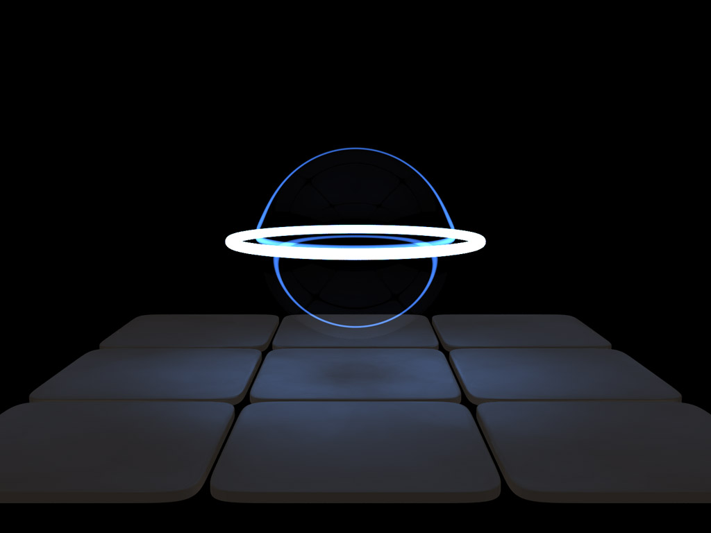

From: NumbC
Date: 9 Sep 2005 10:30:01
Message: <web.43219c41fb56d428726bd13c0@news.povray.org>
Glad you liked it and go ahead and use the idea ;) Love to see your end
result.
I couldn't wait until I got home so I started a new scene during my
lunchbreak at work. I have attached an example render which looks much more
promising than what I got earlier. I placed no lightsources in this scene
so the result is definately what I'm after.
And yes I know ... this sorta thing should be animated (on my to-do list)
LOL
I hope you like it and I will continue experimenting this weekend.
NumbC
Download 'neon test 004.jpg' (68 KB)
Preview of image 'neon test 004.jpg'
