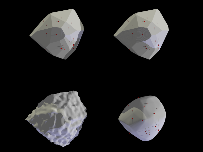

For creating a voronoi cell we need nearest neighbours. The simplest way
to create those is with creating random points on a sphere. For
constructing a cell that's all that's needed.
top left: intersection of planes
rop right: intersection of isosurface planes
bottom left: noisy isosurface version
bottom right: blob
ingo

From: clipka
Subject: Re: voronoi cell
Date: 11 Feb 2019 13:09:04
Message: <5c61ba40@news.povray.org>
Am 11.02.2019 um 11:10 schrieb ingo:
Note that limiting your neighbor points to a sphere surface will create
a special case of voronoi cell, in which all surfaces are touching an
inscribed sphere.
For a more generalized case, use random points _in_ a sphere.
(Also, simply using radom points comes with a non-zero probability that
the cell will be "open" because all neighbors happen to occupy the same
hemisphere.)
From: ingo
Date: 11 Feb 2019 13:55:35
Message: <XnsA9F3CAB443AD6seed7@news.povray.org>
> inscribed sphere.
as can be easily visualised by using some 500 points, approximating this
sphere.
Not tried that yet, was using on sphere to have some control over the size
of the result, it reduces the shapes variation though. Tried random on a
few ellipsiods, resulting in tiny objects. Maybe a cylindrical object?
> hemisphere.)
Yep, that happens.
ingo
From: clipka
Date: 11 Feb 2019 14:13:21
Message: <5c61c951$1@news.povray.org>
Am 11.02.2019 um 19:55 schrieb ingo:
Maybe discard points that get too close for comfort?
From: ingo
Date: 11 Feb 2019 14:19:18
Message: <XnsA9F3CEB9010F9seed7@news.povray.org>
and before you know you are generating points on a smaller sphere. But
yes, given a certain range that works.
It is kind of adding a 'weight' to a point on a sphere. Depending on the
weight the plane moves more or less towards the centre.
ingo
