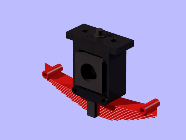

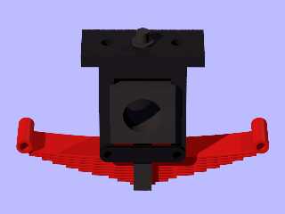

HI,
I made this leaf spring using segments of a rounded tube.
It looks fine when viewed straight-on but assumes a funny angle at the
ends when viewed from the side.
What is going on?
difference{
     union{
             // tube radius outside - inner radius - border radius -
hight - 0 = union, 1 = merge
             object{ Rounded_Tube(351.5,350.0,0.5,18,0) rotate<90,0,0>
translate<0,343.2,0> bounded_by{box{<-55,-500,-1>,<55,500,20>}}}
             object{ Rounded_Tube(353.0,351.5,0.5,18,0) rotate<90,0,0>
translate<0,343.2,0> bounded_by{box{<-53,-500,-1>,<53,500,20>}}}
             object{ Rounded_Tube(354.5,353.0,0.5,18,0) rotate<90,0,0>
translate<0,343.2,0> bounded_by{box{<-47,-500,-1>,<47,500,20>}}}  // 94
             object{ Rounded_Tube(356.0,354.5,0.5,18,0) rotate<90,0,0>
translate<0,343.2,0> bounded_by{box{<-42,-500,-1>,<42,500,20>}}}  // 84 ////
             object{ Rounded_Tube(357.5,356.0,0.5,18,0) rotate<90,0,0>
translate<0,343.2,0> bounded_by{box{<-36,-500,-1>,<36,500,20>}}}  // 72
             object{ Rounded_Tube(359.0,357.5,0.5,18,0) rotate<90,0,0>
translate<0,343.2,0> bounded_by{box{<-30,-500,-1>,<30,500,20>}}}  // 60
             object{ Rounded_Tube(360.5,359.0,0.5,18,0) rotate<90,0,0>
translate<0,343.2,0> bounded_by{box{<-24,-500,-1>,<24,500,20>}}}  // 48
             object{ Rounded_Tube(362.0,360.5,0.5,18,0) rotate<90,0,0>
translate<0,343.2,0> bounded_by{box{<-16,-500,-1>,<16,500,20>}}}  // 36
             object{ Rounded_Tube(363.5,362.0,0.5,18,0) rotate<90,0,0>
translate<0,343.2,0> bounded_by{box{<-12,-500,-1>,<12,500,20>}}}  // 24
             object{ Rounded_Tube(365.0,363.5,0.5,18,0) rotate<90,0,0>
translate<0,343.2,0> bounded_by{box{<-06,-500,-1>,<06,500,20>}}}  // 12
             cylinder{<-55,0,-1>,<-55,0,19>,3.75}
             cylinder{< 55,0,-1>,< 55,0,19>,3.75}
         cylinder{<-55,0,-2>,<-55,0,20>,2.25}
         cylinder{< 55,0,-2>,< 55,0,20>,2.25}
Download 'a.png' (49 KB) Download 'b.png' (39 KB)

I've not tested it, but try adding:
clipped_by { bounded_by }
after each bounded_by{} statement.
Or, as Cousin Ricky recently suggested, in place of manual bounding
create each spring leaf as an intersection of a 'bounding box' with each
rounded tube.
Bounding - whether added manually or automatically - is only used to
determine whether the real 'ray -> shape/surface' intersection code for
the basic shape is run(a). In other words, ray -> surface intersections
'can be' outside the bounding.
Bill P.

You are incorrectly using bounded_by as an alternative for an intersection.
ANY ray that hit the bounded_by shape will cause the bounded_by object
to be evaluated, even if that part is actually outside the bounded_by
object. Even if that part is in front of the bounded_by shape.
Instead, you should use an intersection or add clipped_by{bounded_by}
The first will close the object. You see the surface of the intersecting
object.
The second will leave the ends open. Adding an interior_texture will
make it obvious.

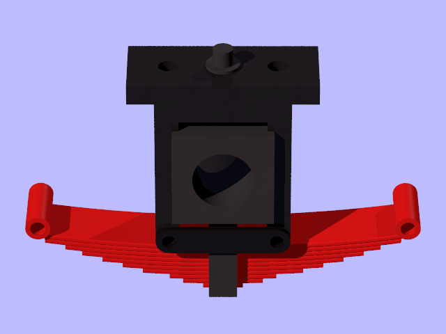

Thanks Alain and Bill P - intersection fixed it :-)
m@
