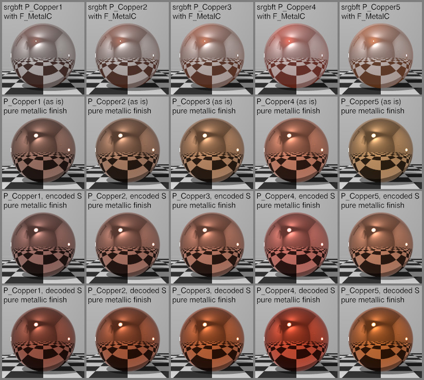

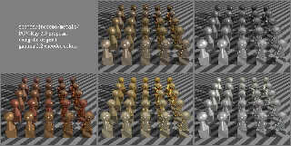

When Thomas de Groot challenged Alain and me to write improved
metals.inc, one of my first thoughts was "Why bother? It's a lost
cause."  Alain's solution was to just replace all the ambients with 0,
but I think that's too simplistic.  That file and golds.inc were written
before POV-Ray had metallic reflection.  File golds.inc goes through an
elaborate ritual to compensate for this deficiency, while metals.inc
ignores the problem completely.  Everything about those two files
screams "OBSOLETE!"  But the challenge still gnaws at me.

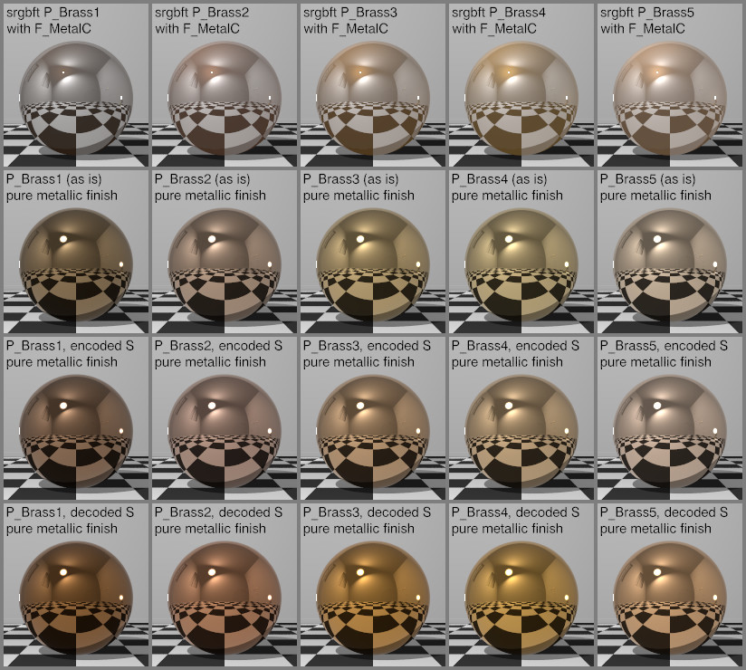

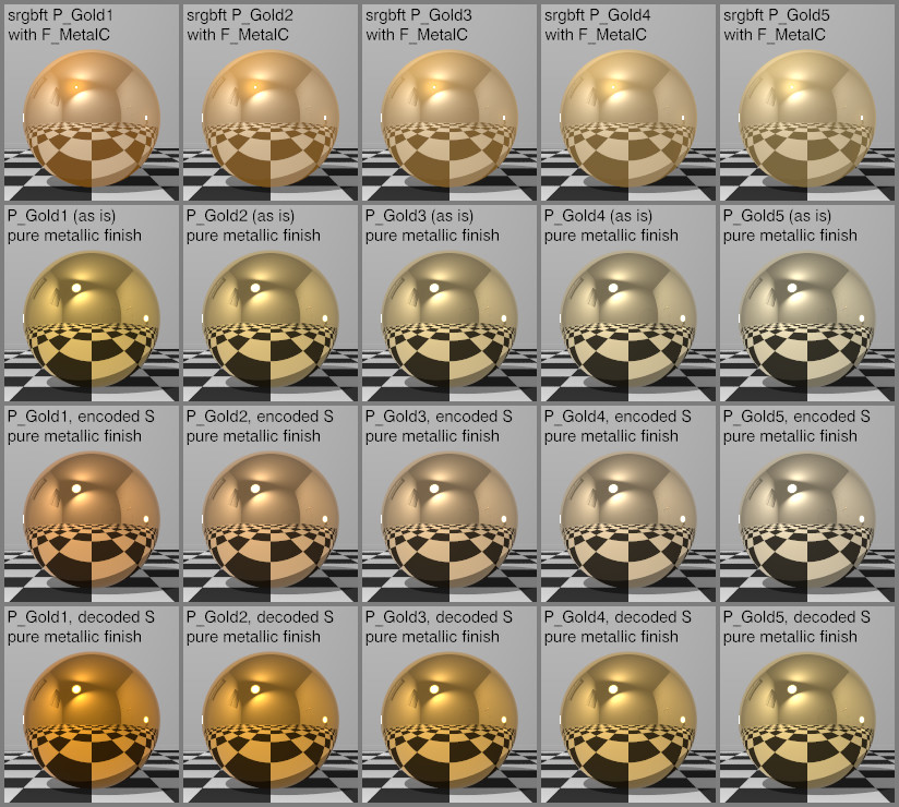

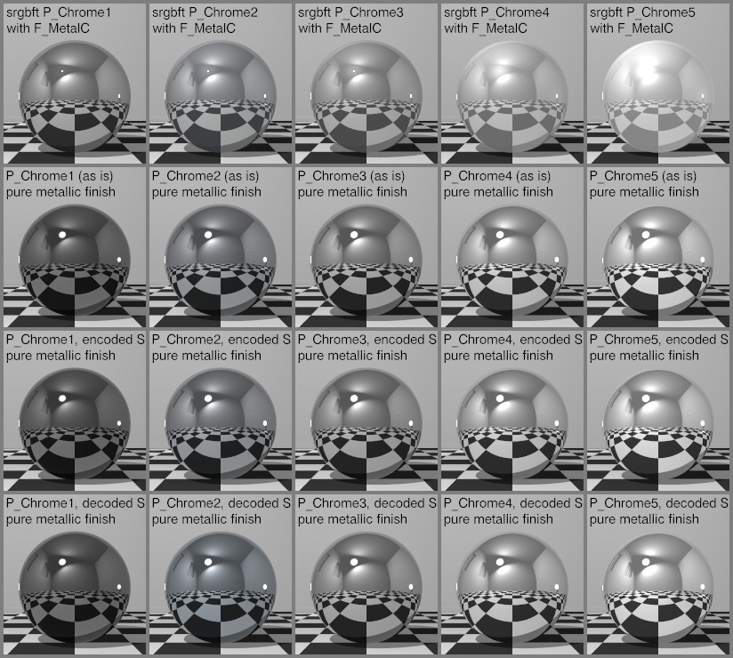

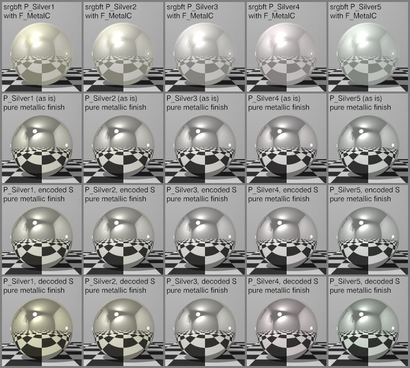

One question that must be answered is should we assume that the colors
are gamma pre-encoded?  Image stock_metal_gamma-srgb.jpg assumes that
they are, and uses the srgbft keyword to decode them.  Image
stock_metal_gamma-linear.jpg assumes they are not, and just uses the
colors as-is.  Comparing them, it seems to me that the colors were not
pre-encoded, unlike those in colors.inc.
Both images use assumed_gamma 1, and the spheres use this finish:
  finish
  { ambient 0 diffuse 0
    reflection { 1 metallic }
    specular albedo 1 metallic
    roughness 1 / 3000
Of course, any improvements to these files will cause old scenes to look
different.  Better, but different.

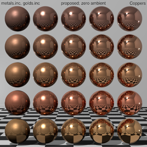

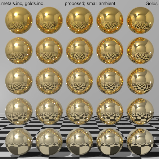

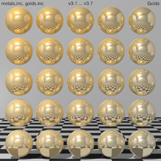

From: Cousin Ricky
Subject: Re: Colors from golds.inc and metals.inc
Date: 23 Feb 2022 18:31:30
Message: <6216c3d2@news.povray.org>
On 2022-02-22 11:48 (-4), Thomas de Groot wrote:
> Op 22-2-2022 om 14:36 schreef Cousin Ricky:
> I truly appreciate your thoughts and efforts. To address your last
> comment: I am increasingly convinced that trying at all costs to find
> solutions, at the same time preserving the aspect of old scenes, is a
> dead end. I would strongly be in favour of making those textures up to
> date, whatever the costs.

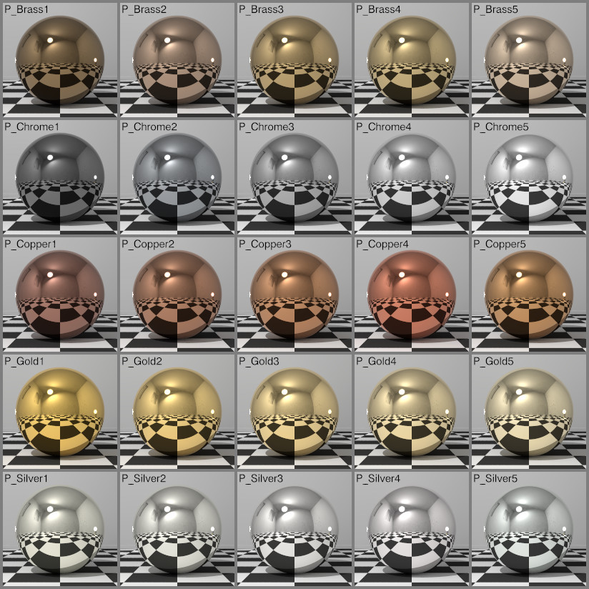

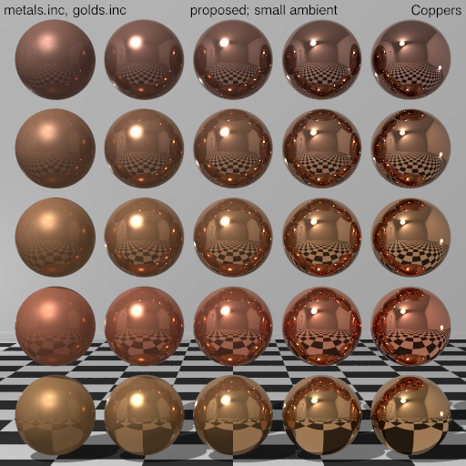

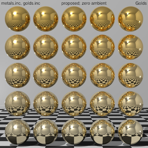

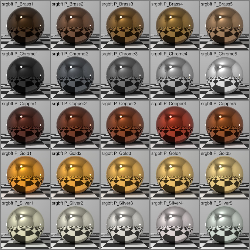

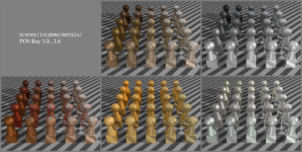

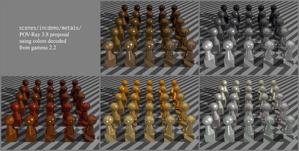

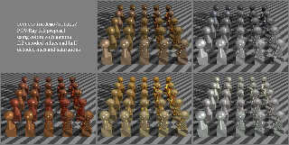

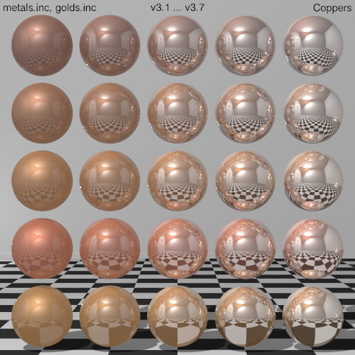

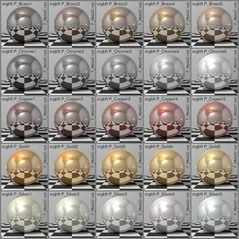

Heard, loud and clear.  Plus, I went back and rendered the old metal
textures, and I don't think they will be missed.  The portfolio scenes
don't give a realistic impression of how hideous they are.

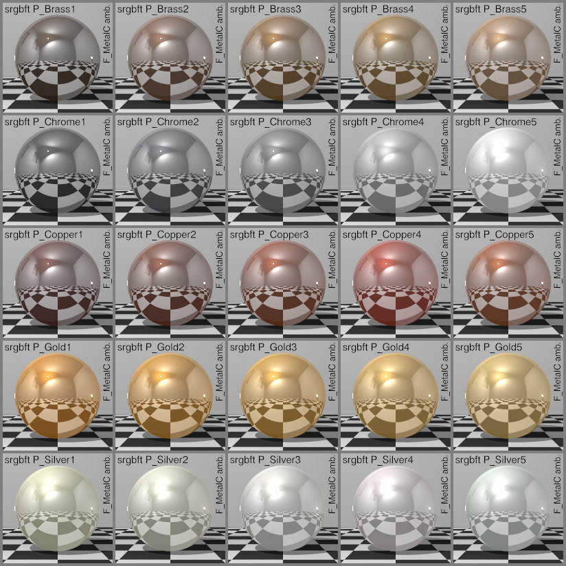

The ambients all default to zero, but for maximum flexibility, the
revised include files retain a provision for a small ambient.  I
included this provision due to my experiments last November.
All these images were rendered without radiosity, because with radiosity
in POV-Ray 3.8, the ambient issue becomes moot.  But as I wrote in the
OP, the high ambient values are not the only problem with the textures
as they have been.
If you all like these, I will post the revised include files to p.b.s-f
(and also figure out how to do branches and pull requests).
Download 'metals31inc2.jpg' (90 KB) Download 'metals38inc02.jpg' (105 KB) Download 'metals38inc07.jpg' (101 KB) Download 'metals31inc5.jpg' (92 KB) Download 'metals38inc05.jpg' (125 KB) Download 'metals38inc10.jpg' (121 KB)
Preview of image 'metals31inc2.jpg'
Preview of image 'metals38inc02.jpg'
Preview of image 'metals38inc07.jpg'
Preview of image 'metals31inc5.jpg'
Preview of image 'metals38inc05.jpg'
Preview of image 'metals38inc10.jpg'

Op 24/02/2022 om 00:31 schreef Cousin Ricky:
Perfect!
I vote for the addition of a small ambient.

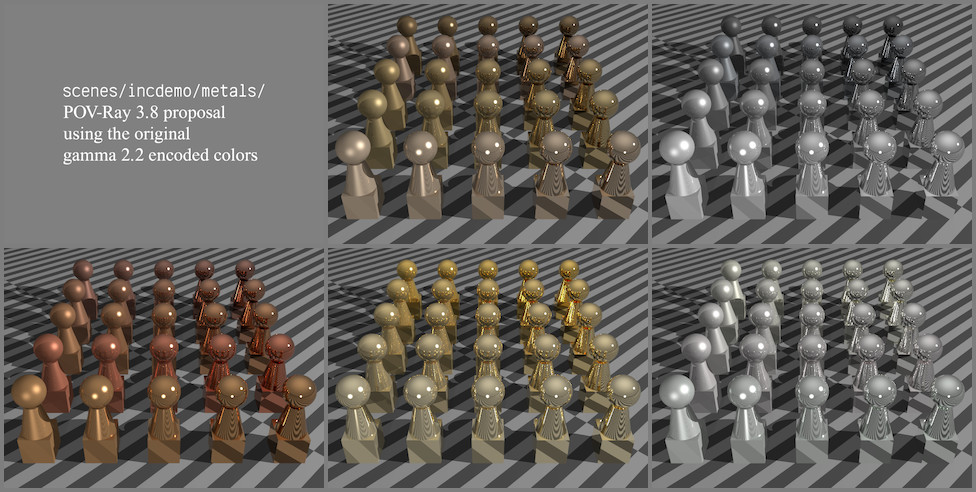

I discovered that the demo scenes from POV-Ray 3.0 explicitly set
assumed_gamma to 2.2, suggesting that the pigment colors were gamma
pre-encoded.  However, as the first OP image shows, this results in
metals that are too dark when used with a realistic finish.  It appears
that the old finishes exaggerated the luminances of the colors while
reducing their saturations, so it seems best to leave the colors as-is,
as if they were not pre-encoded.
Not gamma-decoding the colors does result in hue drift, but I think the
drift is in a better direction.
The attached images show the old finishes without and with radiosity.
Since they were rendered with POV-Ray 3.7, the ambients were
automatically suppressed for the radiosity renders.  The radiosity image
shows that the ambients were not the only problem with the old finishes;
the reflection { metallic } introduced in POV-Ray 3.5 really makes a
difference.
Download 'stock_metalc_gamma-srgb-a.jpg' (211 KB) Download 'stock_metalc_gamma-srgb-r.jpg' (211 KB)
Preview of image 'stock_metalc_gamma-srgb-a.jpg'
Preview of image 'stock_metalc_gamma-srgb-r.jpg'
From: Cousin Ricky
Date: 28 Feb 2022 14:06:36
Message: <621d1d3c@news.povray.org>
On 2022-02-27 13:09 (-4), Cousin Ricky wrote:
In POV-Ray 3.7, the assumed_gamma in the demo scenes was changed to 1,
and the results look horrible, further confirming that the colors are
gamma encoded.  As assumed_gamma 1 is the recommended setting going
forward, one would think these colors should be decoded for the new
include file; but decoding the colors is more problematic than not.
On second thought...
I massaged the colors in an attempt to eliminate the hue drift while
keeping them suitable for linear gamma and metallic reflection.
The top row of each image uses the original F_MetalC, but with the
colors decoded to retain the gamma 2.2 look when using assumed_gamma 1.
The second row uses the 2.2 encoded colors to maintain somewhat high
luminance with an updated metallic finish.  A drift in hue away from the
top row is evident.
The third row maintains the original hues, while using the 2.2 encoded
saturations and values.
The bottom row maintains the original hues, while using the decoded
saturations and 2.2 encoded values.
I believe the third row best matches the original colors as presumably
intended by the POV-Team, although, for the brasses and golds, the
second row seems closer to colors I see in real life.  What do you think?
Download 'stock_metal-massaged-bs.jpg' (197 KB) Download 'stock_metal-massaged-cr.jpg' (172 KB) Download 'stock_metal-massaged-cu.jpg' (205 KB) Download 'stock_metal-massaged-au.jpg' (207 KB) Download 'stock_metal-massaged-ag.jpg' (176 KB)
Preview of image 'stock_metal-massaged-bs.jpg'
Preview of image 'stock_metal-massaged-cr.jpg'
Preview of image 'stock_metal-massaged-cu.jpg'
Preview of image 'stock_metal-massaged-au.jpg'
Preview of image 'stock_metal-massaged-ag.jpg'
From: Bald Eagle
Date: 28 Feb 2022 17:00:00
Message: <web.621d450f93c26a371f9dae3025979125@news.povray.org>
Regarding the brass, I have a chunk of brass sitting next to me and, 4th row,
P_Brass4 decoded S pure metallic finish looks best.
P_Brass3 in that row is too dark/orange, and the second row is too
pale/unsaturated.
Most of the other colors look like crap, unless we're talking about oxidized or
heat-discolored metal.
The finish in that first row is an atrocity.  It's like there's a fog or haze.
The first brass looks like steel, and the second in the 4th row looks like
copper.
For the chromes, I'm comparing it to a pair of nail clippers - presumably chrome
plated like everything else - and P_Chrome3 in row 2 or 3 look the closest in
color tone.
For the copper, I have a 3-foot section copper rain gutter, and a 6-foot copper
downspout.   Keep in mind that pure copper rapidly acquires a thin oxide layer
that darkens the color, so I'm comparing as-is, not buffed / polished /
chemically cleaned.   The lighting also heavily factors in.
But I'd have to say that I favor P_Copper3 in the 4th row above all others, with
2 and 5 in that same row as possible alternates.
For the gold, I have a Canadian 1/4 oz 0.9999 coin.
Also, some 1 g fine gold rectangles.
This one is the hardest to determine by far.  It's extremely sensitive to angle
and lighting....
It seems to my eye to fall between the 1st and 2nd in the 4th row - but neither
one really captures the peculiar shade of orange that the metal has.
Shining a white LED onto it to get "better" light makes it a LOT more yellow.
So --- we might need a real-life Cornell Box with standardized illumination to
eliminate the many influential variables.
For the silver, I'm comparing to a 1 oz silver round.
And wow - this is devilishly hard as well.
Numbering from left to right, top to bottom, I'd say it falls somewhere in the
range of 6, 7, 8, 9, 11, 12, 13, 14, 18
16 and 17 are too yellow, and 19 is too - purple?
It's also hard to compare to the renders, since it's hard to say if I'm looking
at the color of the metal or the color of the reflection.
Maybe a different set of spheres with some normal / micronormal finishes to give
a more matte appearance might help in future assessments.
Not sure what else we have, but I'd say that at some point in the future we
ought to strive to have have iron, steel, nickel, aluminum, tin, and zinc.
And maybe titanium nitride.
I'm sure they're all wildly similar, but maybe trying to look at the real world
objects and figure out rendering textures for them might teach us to see what
we're overlooking, discover better lighting and environment for objective
observation, and maybe lump a few of those metals/platings into a catch-all
texture that works for all of that group.
No idea what, if any, effect alloying with chromium, molybdenum, vanadium, etc
would have.  I'm sure there's a difference between different steels, high
carbon, stainless, etc.   My neighbor endeavors to be a bladesmith, so maybe
he's got some bar stock samples I can look at.
Great work so far, as usual - that's a lot of meticulous work and a lot of
renders.  It's a pretty nuanced topic, for sure.
From: Cousin Ricky
Date: 28 Feb 2022 17:59:00
Message: <621d53b4$1@news.povray.org>
Of course it is!  That is one of the finishes we're trying to replace.
Date: 1 Mar 2022 02:35:40
Message: <621dcccc$1@news.povray.org>
Op 28/02/2022 om 22:56 schreef Bald Eagle:
> pale/unsaturated.
[snip]>
I do not have real-world examples at hand, but /instinctively/ I would
choose the third row. The fourth appears too saturated to me. However,
taking into account any outside lighting which might influence the hue
of an object, I would also plead for real-world examples as texture basis.
Anyway, excellent work indeed.
From: Alain Martel
Date: 1 Mar 2022 09:31:24
Message: <621e2e3c$1@news.povray.org>
That haze comes from the insane ambient that those finishes have.
It's the main reason that prompted this whole thread.
> gamma encoded.
Wouldn't you know it, I happened to look at the one (1) scene that had
been changed.  All except copper are still at 2.2.

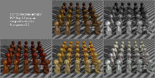

I have rendered several variations of the demo scenes from the
scenes/incdemo/metals directory in the POV-Ray distribution.
Image incdemo-metals-old.jpg is a montage of the original metal demos.
Note that assumed_gamma was explicitly set to 2.2 for these scenes.  The
ambient on the ground plane was set to an outrageous 0.45, but it
doesn't seem that bad due to the non-linear tracing.  The baked-in
ambients don't look that bad at this unrealistic scene gamma, but the
"harder" finishes are much lighter than the softer ones, which doesn't
seem realistic to me.
The remaining scenes all use my new finishes, and have assumed_gamma 1,
and ambient 0.1 set on the ground plane.
Image incdemo-metals-encoded.jpg uses the original metal colors as
declared.  The colors are considerably less saturated, and the hues are
noticeably different.
For image incdemo-metals-decoded.jpg, the colors are decoded from gamma
2.2.  The colors are all very dark, and do not lighten up for the
"harder" finishes.  This darkness is why I proposed not decoding the HSV
values.
For image incdemo-metals-encv.jpg, only the hue and saturation are
decoded.  However, the colors now look too strong.
For image incdemo-metals-half.jpg, the saturation is half-decoded.
Because reducing the saturation affects our *perception* of hue (even
though the hue is mathematically unchanged), I also half-decoded the
hue.  As for why changes in saturation affect our hue perception, I have
no ides; you'll have to ask a color scientist.
Download 'incdemo-metals-old.jpg' (162 KB) Download 'incdemo-metals-encoded.jpg' (170 KB) Download 'incdemo-metals-decoded.jpg' (171 KB) Download 'incdemo-metals-encv.jpg' (179 KB) Download 'incdemo-metals-half.jpg' (175 KB)
Preview of image 'incdemo-metals-old.jpg'
Preview of image 'incdemo-metals-encoded.jpg'
Preview of image 'incdemo-metals-decoded.jpg'
Preview of image 'incdemo-metals-encv.jpg'
Preview of image 'incdemo-metals-half.jpg'
