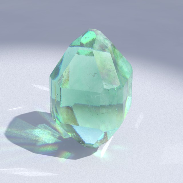

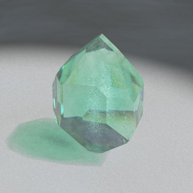

Continuing Sam's investigations on crystal shapes and materials, and
using KrystalShaper as the primary crystal builder.
This is a crystal of apophyllite. The coloured variety is
Fluorapophyllite-(K).
I based the material on the one given by Sam in the "Alum" post in
September last, including Alain's comments. I then added surface normals
from the crystal experiments by Jaime Vives Piqueres, as also a more
'cloudy' aspect using a bit of scattering media, and a density block.
Finally, I added photons. Possibly, the hue should be a tiny bit more
bluish-green...
The environment makes use of a hdri map and a spotlight. The render
makes use of a, non-optimal, stochastic setting, which explains the
grainy aspect. However, I am still experimenting.
Download 'krystalshaper_apophyllite_004d.jpg' (75 KB)
Preview of image 'krystalshaper_apophyllite_004d.jpg'

This looks so promissing! Thanks for sharing!
I'd like to see a cleaner render - without the really grainy stuff, and a nice
clean, smooth background.  But I like the crystal - it looks pretty cool.   Does
the software export vertice information?
Thinking that maybe any calculation runs can be saved to some sort of include
file.
-BW
The crystal is very realistic, and I agree with Bald Eagle, a different
background could increase this realism.
Another thing: the crystal is vertical and gives a strange feeling to be
unaffected by the gravity... have you thought of adding a rock or
something else as a base?
Paolo

Op 24/10/2021 om 23:04 schreef Bald Eagle:
The software exports a set of intersected planes (which are used here)
/and/ a set of unioned cylinders representing the ribs. Vertice info can
be derived from those last, obviously. I have not looked seriously at
that part of the code.
> file.
Oh yes indeed. A lot of streamlining can be made on the code. Not sure
if I want to go all that way though, but I shall post a scene file when
I have cleaned up the whole mess. For the time being I am content with
trying to obtain as 'realistic' a crystal as possible.

Well, yes. It is a change from granites. ;-) But I have /no/ intentions
to turn this into a monster macro!
Subject: Re: Fluorapophyllite-(K)
Date: 25 Oct 2021 02:34:23
Message: <61764fef$1@news.povray.org>
Op 25/10/2021 om 00:08 schreef Paolo Gibellini:
Jaime did that indeed (adding a rock) and I probably shall do the same,
possibly all posed on some dark velvet cloth...
> Paolo
I understand the image as a very nice technical demonstration of shaping
and texturing gems. A base would hide some of the caustics. I think I
will have a look into this issue. I played a bit with photons too.
Best regards
Michael

Op 25/10/2021 om 08:47 schreef MichaelJF:
>> different background could increase this realism.
>> be unaffected by the gravity... have you thought of adding a rock or
>> Paolo
Correct. My primary purpose was to demonstrate the crystal by itself,
without the - secondary - scene additions.
It is my understanding that part of the caustics would probably remain
visible on a supporting rock. Jaime's images show them iirc.

Hey Thomas, it looks good!
I agree with Bald Eagle that a cleaner render would be nice, but of course that
would drive up the render time, should you wish to increase the number of
samples. I mean, you're using scattering media + caustics, and we all know how
that goes.
How long did this take to render? The file name says 004d, so I really hope it
wasn't 4 days ':/
I'd like to discover a cheap and realistic way to add internal fractures to
mineral renders. Apophyllite is one of those minerals prone to being found in a
fractured state. I have two ideas in mind, but both are rather expensive: 1)
height fields intersecting not only each other, but also the crystal shape
(which is itself an intersection); or 2) isosurfaces. Both can be very, very
slow. Sometimes I wish media had an ior block.
Is there an online POV-Ray render farm anywhere? :P

Op 27/10/2021 om 01:09 schreef Samuel B.:
Thanks Sam! It turned out rather well indeed. It is a bit out of the way
in terms of colours, but I liked the wikipedia example too much to let
it pass.
> that goes.
I was indeed fully aware of the grainy render, and - at this stage - it
was on purpose for experimentation's sake, as otherwise I would loose
way to much time waiting for the render to finish before starting the
next try. As always, a project starts rendering fast and gradually slows
down along the way when better settings and more stuff are added.
> wasn't 4 days ':/
Oh no! That is the version number ;-) This render was pretty fast: less
than an hour iirc.
Ah... yes indeed. I have not considered your first method, but
considered the isosurface one. However, I also cringe at the implied
render time.
Another thing I would like to do is model more asymmetric crystals, like

Crystal replaced by a mesh2 version. Less grainy by not using
stochastic. Render time about 27 minutes. Collected photons, about 1 GB.
Additional scene developments pending.
Download 'krystalshaper_apophyllite_004f.jpg' (54 KB)
Preview of image 'krystalshaper_apophyllite_004f.jpg'
It's looking better and a little less noisy now. It also seems a bit more
bluish. Looking online, this mineral has a range of hues spanning between
colorless, pale yellow, and pale/bluish green. All seem to be valid.
>> wasn't 4 days ':/
> than an hour iirc.
Thank goodness, lol. That makes more sense.

Op 27/10/2021 om 22:44 schreef Samuel B.:
Yes, in between renders I added a bit more blue.
Date: 28 Oct 2021 10:38:45
Message: <617ab5f5@news.povray.org>
Op 27-10-2021 om 22:44 schreef Samuel B.:
>>> wasn't 4 days ':/
>> than an hour iirc.
Strange. Somehow, I must have changed something, but now renders take a
much longer time, more in the range of several hours (and photons jumped
to 3Gb). I do not remember what is different. :-/
Date: 28 Oct 2021 11:27:11
Message: <617ac14f$1@news.povray.org>
Op 28-10-2021 om 16:38 schreef Thomas de Groot:
Found the culprit! :-)
I had changed 'union' to 'merge' in the mesh2 object. In this particular
case of well-behaving crystal faces, that is unnecessary. The render
speed difference is dramatic indeed.

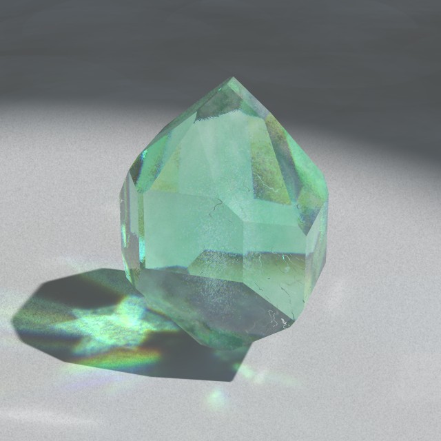

this is a randomised version of the apophyllite crystal. I also changed
the light probe and tweaked the scattering media (which still remains a
second choice), and brought the photon spacing to more natural levels
(0.01).
> (0.01).
The shape does look more natural. But the scattering media makes it seem a bit
glowy. Maybe some absorbing media would help counteract that?
Sam
Date: 31 Oct 2021 03:32:54
Message: <617e46a6$1@news.povray.org>
Op 30/10/2021 om 23:48 schreef Kenneth:
> A beautiful crystal, Thomas-- and with those VERY nice caustics.
Thank you indeed Kenneth.
> Long ago, I rendered a "Merry Christmas" image (which I can't find,
> unfortunately), that had some objects made of translucent ice, with an ior. I
> wanted internal 'cracks' to show up inside the ice-- so IIRC I accomplished that
> as part of its 3-D texture, not as actual geometry. It looked decent enough to
> fool the eye. Something *kind of* like this pseudo-code example:
> pigment{
>     gradient x
>     pigment_map{
>              [0.49 --ice color --]
>              [0.49 bumps (?)
>                   -- some scale ---
>                    pigment_map{
>                        [0.3 -- ice color --]
>                        [0.3 rgbt <1,1,1,.7] // translucent white
>                    scale 50 // to scale down the size of the warp effect
>                    warp {turbulence .2}
>                    scale 1/50
>              [0.51 same as 0.49]
>              [0.51 -- ice color --]
> The general idea is to have a very thin slice of translucent white (somewhat
> broken up) to appear inside the ice-- like a crack or fracture. Perhaps
> something similar might work for your crystal.
That is an interesting possibility which I shall try. I'll be back!
Thanks for this!
Date: 31 Oct 2021 03:37:22
Message: <617e47b2$1@news.povray.org>
Op 31/10/2021 om 02:05 schreef Samuel B.:
>> (0.01).
As I said, scattering is bad, and here even more so: it acts as a vulgar
fog inside the crystal ;-)
I am currently experimenting with very tiny air bubbles as inclusions
and distributed in a gaussian way. It looks promising but needs some
more tweaking/thinking.

I didn't answer you fully there, I am afraid. The only media used here
is an absorbing media which takes care of it all (with the ior too of
course). I experimented with the scattering media in addition to the
absorbing one, because Jaime did something like that in his crystal
experiments.
http://www.ignorancia.org/index.php/galleries/latest-images/crystals-and-mushrooms/
However, I did not find it to work as expected.
Date: 1 Nov 2021 12:04:16
Message: <61801000$1@news.povray.org>
Warning! No photons! :-)
After a good three hours render, this is the crystal with 'fluid'
inclusions added: 15000 little hollow spheres with an ior of 1.0.
Not sure how 'natural' this is looking. I have seen crystals with
concentrations of 'bubbles' more or less like this. Maybe I have
exaggerated a bit; maybe there should be less 'bubbles'...
Personally, I like it but I am interested in your verdicts.
Download 'krystalshaper_apophyllite_006a.jpg' (64 KB)
Preview of image 'krystalshaper_apophyllite_006a.jpg'
From: jr
Date: 2 Nov 2021 07:30:00
Message: <web.6181211d4f1e127bd6c295506cde94f1@news.povray.org>
hi,
very nice, "like".  :-)  I'd be interested to see a version where the "bubbles"
are confined to a smaller volume within, and also "off-centre", a little.
regards, jr.
Date: 2 Nov 2021 11:42:44
Message: <61815c74$1@news.povray.org>
Op 2-11-2021 om 12:29 schreef jr:
> hi,
Smaller volume: yes, that would be interesting
off-centre: ok
From: Bald Eagle
Date: 2 Nov 2021 16:50:00
Message: <web.6181a3b84f1e127b1f9dae3025979125@news.povray.org>
So, to me, it still looks a bit - murky.  Like I'm viewing the render through a
haze or slightly out of focus.
I'm not sure if it's the render settings, the lighting, or the contribution of
the textured ground plane, or what.  I just get the impression that I should be
seeing some crisp(er) edges on the front of the crystal, and instead they are
kind of muddled / blended in with the body of the crystal.
I like the bubbles - I know what you're trying to accomplish there.  Perhaps -
fewer? Slightly more spread out?
This would definitely be a great method for making a realistic ice cube with the
frozen air bubbles inside...
I would be interested in seeing a clean, crisp, clear or opaque version, which
ought to render very quickly, and also - one employing the new granite material!
 :D
This has also got me wanting to see an amethyst, with the clear-to-purple color
gradient.
Date: 3 Nov 2021 03:17:58
Message: <618237a6$1@news.povray.org>
Op 02/11/2021 om 21:46 schreef Bald Eagle:
I have no idea. I guess it could be the lighting (area light), but the
edges /are/ crisp, you can take my word for this.
I shall soon have a demo scene file ready for you to play with.
Yes, I think there are too many anyway.
Indeed.
>   :D
A /granite/ material? What are you talking about? ;-)
I shall provide that asap. Note that the bubbles will be invisible... :-}
> gradient.
Indeed. I think I shall leave that to others after I provide the code.

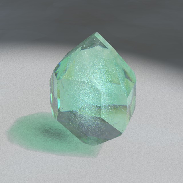

Date: 3 Nov 2021 12:47:42
Message: <6182bd2e@news.povray.org>
Latest, less inclusions, and slightly more concentrated and de-centered.
The complete set of files can be found now in the p.b.s-f
I added a quartz crystal to the set.
Download 'krystalshaper_apophyllite_006b.jpg' (59 KB)
Preview of image 'krystalshaper_apophyllite_006b.jpg'
From: Samuel B
Date: 9 Nov 2021 19:01:05
Message: <web.6185c5cf4f1e127bcb705ca46e741498@news.povray.org>
It looks decent!
I've got a bunch of ideas, but I need to find the proper motivation to implement
them :/
Only thing I want to suggest at this point is to maybe situate the light_source
&/ sky_sphere so that it casts a highlight off either an outside or inside
surface.
Sam

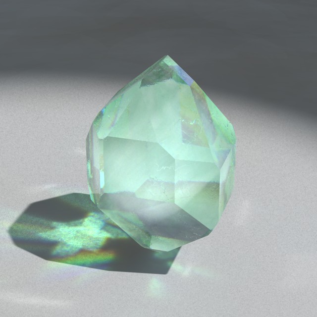

I like this. AND the previous render with more bubbles. Beautiful.
BTW, I did not realize that an object with ior could have inclusions (other
objects) with *different* ior's-- I thought such constructs would be an example
of 'variable' ior within an object, which cannot be accomplished in POV-ray,
AFAIU. I had a mistaken notion that the camera ray would 'see' the outer object
surface first, which would then set the ior for the entire union-ed CSG. (Kind
of like the way media operates.) But that's not the case! :-) So I've been
experimenting with this multiple-ior CSG trick, which can produce some visually
interesting results. Thanks for the idea.

And final, with photons. Render time about 1.5 hours.
Download 'krystalshaper_apophyllite_006c.jpg' (59 KB)
Preview of image 'krystalshaper_apophyllite_006c.jpg'

To tell the truth, I really do not know /how/ the different ior's are
treated together. Afaik, this is not explained in the wiki pages. To
keep on the safe side, I kept the inclusion's ior at 1.0 which is
cheating of course, but at least I was not confronted to strange
effects. On my ToDo list I have put some ior experiments...

If I'm not mistaken, a ray evaluates all objects and their iors along its path
and changes its trajectory accordingly. So in a union, it is not really
'cheating' to have objects with an ior of 1 inside. They are treated as air
until the ray moves on. It's a reasonable alternative to using a difference
which - while not requiring objects with different iors - is very slow to trace.
Oh, and a while back, I found out that if you want to pretend that the camera is
inside some volume, say water, and you want to see air bubbles in that volume,
then for the air bubbles you would use the reciprocal of water's ior. So, the
bubbles would have an ior of 1/1.325, iinm.
Sam

If you want to use a difference, then, you should use a blob instead of
100' to 1000's of spheres.
That way, you benefit from the blob's hierarchy and internal bounding
mechanism.

Blobs! I completely forgot about that option. And based on some experiments I
made once, I'd say you're probably right about the their higher rendering speed.
Yeah, I can see the benefit to using blobs to make air/fluid inclusions, and
then maybe applying a facets normal with metric 1 and maybe form <1, 0, 0>. This
way the clouds would refract/reflect light at certain angles only, thus giving a
more crystalline appearance. Hmm...
Sam

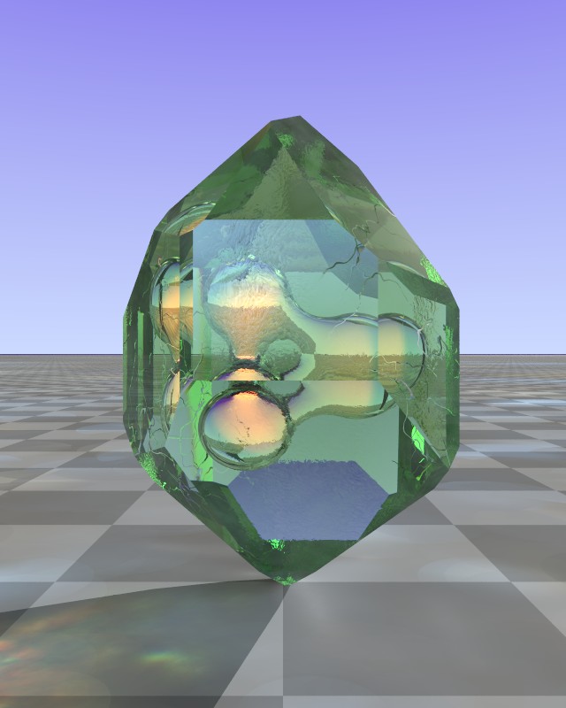

Op 10-11-2021 om 08:11 schreef Thomas de Groot:
Here it is. I replaced the cloud of inclusions by just one large blob
inclusion with its own ior (salt water) and its own (coloured)
absorption media. Indeed, there is no interaction between the different
media colours (crystal and inclusion) or ior differences. Good to know! :-)
Download 'nested media_test4.jpg' (62 KB)
Preview of image 'nested media_test4.jpg'

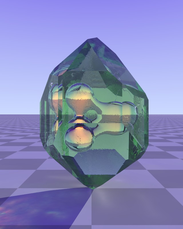

Message: <61927e62$1@news.povray.org>
...And using a light probe in addition (with no_image).
Download 'nested media_test5.jpg' (65 KB)
Preview of image 'nested media_test5.jpg'
