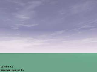

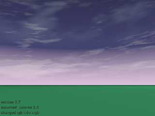

This brings up a couple questions, illustrated by the images below. In
this particular skies case, the scenes are typically labelled version
3.6 with assumed_gamma 2.2 (image: s_cloud1-1). Obviously, this cannot
be maintained in any self-respecting program promoting assumed_gamma
1.0! :-)
So, I changed assumed_gamma to 1.0 (image: s_cloud1-2) and while I was
at it, I experimented with Ive's transformation macro and Clipka's
colour boost macro, and thus achieved a version with srgb colours
(image: s_cloud1-3). These macros have been discussed  fairly recently
in these ng's.
The fundamental question is: What do we want?
Download 's_cloud1-1.jpg' (30 KB) Download 's_cloud1-2.jpg' (27 KB) Download 's_cloud1-3.jpg' (30 KB)
Preview of image 's_cloud1-1.jpg'
Preview of image 's_cloud1-2.jpg'
Preview of image 's_cloud1-3.jpg'

Just as a check, I rendered your example  SCloud_1  skysphere in v3.8xx
(assumed_gamma 1.0), and get identical results to your middle image. So far, so
good ;-)
However, I think that in v3.6 days and prior to that, there was a real
question-- not to mention a bit of confusion-- about using assumed_gamma 1.0 vs.
2.2. My own *guess* is that the  SCloud_1  colors were chosen in a 2.2 gamma
environment, and that the 1st image is probably what was intended. But that's
just my gut feeling; it's very difficult to 2nd-guess someone's intention (and
working gamma space) from so long ago...not to mention having to deal with any
unknown color/gamma problems that may have existed in older versions of POV-ray
itself, which may have confused the original author.
I actually think that both the 1st AND 2nd images are pleasing-- but not the
3rd, it's too washed out. PERSONALLY, I think the appearance of these specific
sky colors should be somewhere *between* gamma 1.0 and 2.2, ha. But apparently a
2.2 gamma was what the author had in mind...so image #1 would be my pick. As a
jumping-off point, I would suggest simply changing the specified colors to srgb
versions-- no fancy conversions-- and see what it looks like at assumed_gamma
1.0.

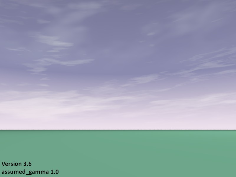

Hmm, they are not quite identical after all.
I thought I would do a side-by-side comparison of your v3.6 assumed_gamma 1.0
version to v3.8xx (I changed the "skies.inc" pigments back to their originals.)
There's a definite difference; I assume that it comes from the many
'under-the-hood' changes made to POV-ray since v3.6.
So it seems to be very difficult to determine (and update) what the author's
*original* visual intent was for these pigments.
Unless we all go back to using v3.6  :-O
Download 'version_comparison_at assumed_gamma_1.jpg' (84 KB)
Preview of image 'version_comparison_at assumed_gamma_1.jpg'

This is strange. Attached find my version of the same which is
comparable to the original. Something is different apparently.
In skies.inc, I also changed the version to 3.7, which is also used in
the scene file.
Download 's_cloud1-4.jpg' (32 KB)
Preview of image 's_cloud1-4.jpg'

This is what the comparison was supposed to look like, between
v3.6 at assumed_gamma 2.2
and
v3.7.0 (or 3.8, same effect) at assumed gamma 1.0
There is a slight difference, perhaps in contrast. It is difficult to figure out
exactly what causes this; but it might be like comparing 'apples to oranges',
considering the many changes that have been made to POV-ray since v3.6.
Download 'skies_scene_comparison.jpg' (114 KB)
Preview of image 'skies_scene_comparison.jpg'

Op 01/03/2021 om 14:42 schreef Mr:
> Thanks a lot or your undertaking,
> First note that looking at images through small previews on the web interface of
> theses newsgroups is always error prone and one would naturally go to the more
> contrasted. But opening full screen and really looking at pictures,
> I clearly prefer the third version because a) it's the most realistic would one
> consider the season to be winter (paler) rather than summer, and b)that does not
> show procedural cloud color map edges so contrasted as was so frequently done in
> the nineties, it's crucial now that POV moves away from what people think are
> its limitations to show what it really can do.
> If not already done, could more "modern" macros such as lightsys or
> CousinRicky's metal work or the ones you mentionned be integrated to those
> official libraries at last or is there some show stopper ?
Aha! This again, addresses imo the fundamental question, also mentioned
by BaldEagle, if we should not take leave of (some) of the "backward
compatibility" rule. These cloud scenes were great a couple of decades
ago but hardly anyone nowadays would use them without serious changes;
even newbies would probably not find them acceptable given the
development in the field of cgi.
So, I think that POV-Ray's include files should reflect these changes
and, as Bald Eagle wrote too, provide a switching system to show, where
possible or available, the evolution of the concept. In the case of
clouds, that would mean these simple, version 3.1 and 3.5 cloud scenes,
and the version 3.7+ alternatives.
In other cases, upgrading will be much more straightforward imo.
Metallic or wood textures e.g. But there too, new additions might be or
should be seriously considered. After all, over the years, we have
acquired a huge amount of creative power condensation and deposition! :-)

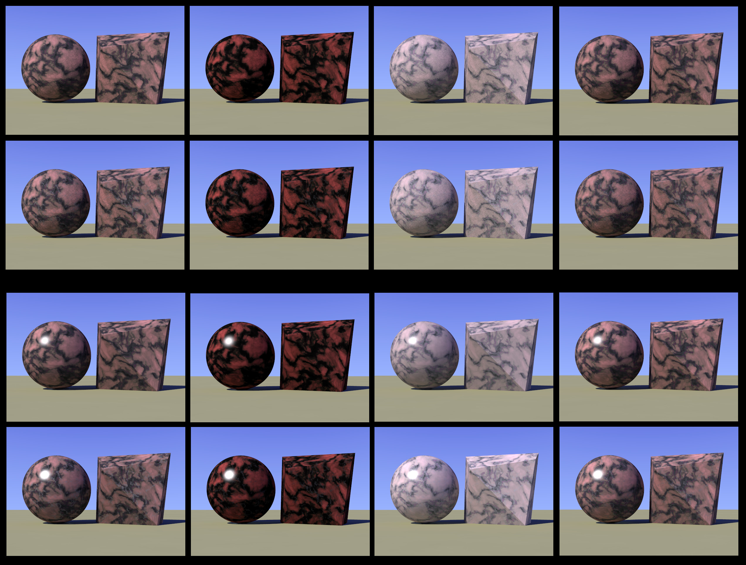

I am slowly working towards an understanding about what needs to be
done. The skies.inc was primary exploration for me; I have now examined
more closely some texture issues.
I selected the American Granites suite which Daniel Mecklenburg Jr wrote
for version 2.2. I corrected some inconsistencies and then built a
#switch system (for now only the first textures: MohoganyPol and
MohoganyFro) to allow for different renders according to the user's whim.
I think that this suite of granite textures should be included into the
POV-Ray package by the way. I guess it was dropped or lost.
The image below shows two sets of renders: The top two rows correspond
to the MohoganyFro set; the two bottom rows to the MohoganyPol set. The
difference between the row couples is only that in the second one a
layered texture is used for some extra veins in the granite.
The first column shows the granite in its basic, linear colour space,
form as written by the author.
The second column uses a simple rewrite of rgb --> srgb, assuming that
the original code was written for an assumed_gamma 2.2 environment.
The third column uses the transformation function by Ive from scRGB to
sRGB. I kept this column as reference, but I would argue for the
following column as to be definitive.
The fourth column additionally uses the colour saturation/brightness
variation code by Clipka.
It is a bit of work, but I think that this would be an acceptable to
update the textures available in the Include directory.
Download 'conversions.jpg' (778 KB)
Preview of image 'conversions.jpg'
I like Clipka's version best. I know Christoph has championed gamma 1.0 but I'm
really a novice with the whole gamma issue (which I've seen debated endlessly
here over the years).
That said, I just read this blog post about gamma, which I found very
enlightening and thought it might be helpful to others here:
https://blog.johnnovak.net/2016/09/21/what-every-coder-should-know-about-gamma/
Subject: Re: Upgrading POV-Ray's include files - a few remarks
Date: 7 Mar 2021 11:46:03
Message: <6045034b$1@news.povray.org>
Op 7-3-2021 om 17:32 schreef Robert McGregor:
I agree, in particular because it is closest to the "original", although
we have no idea how the textures looked under version 2.2.
The whole switch idea gives a broader choice of textures to the user.
After all, somebody may prefer a different aspect. And he/she can always
start tinkering too.
