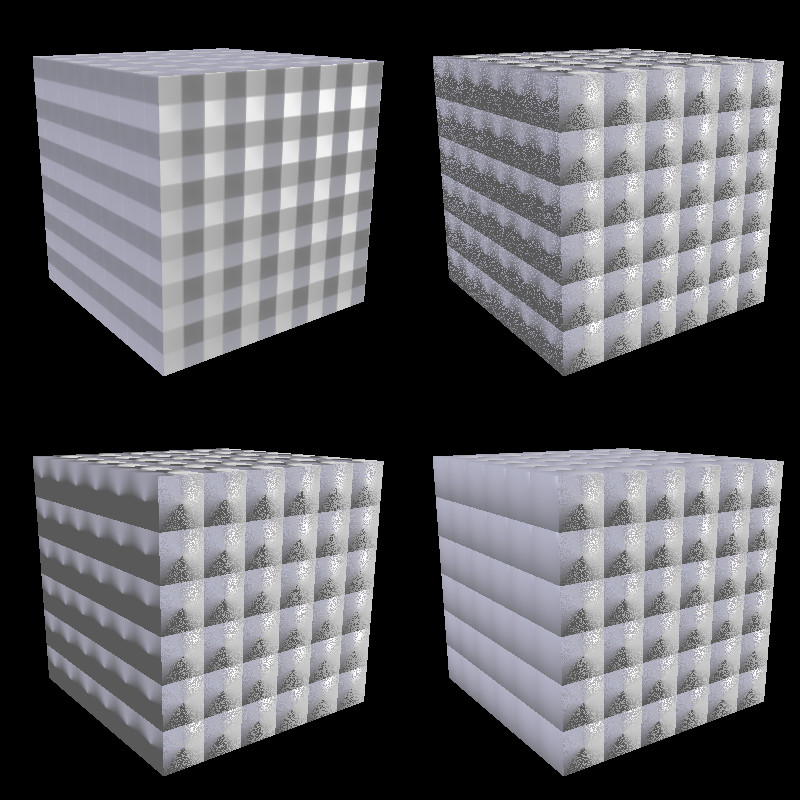

Attached is an image - generated with v3.8 master - showing additional
quilted specific issues.
In the upper left is the 'value for map' pattern surface normal
perturbation. Internally, the map pattern's value is sampled four times
and those samples are used to perturb the shape's surface normal. The
normal block's accuracy setting comes into play here. Beyond that, I've
not worked through what the code is really doing.
In the upper right is today's (v3.7/v3.8) true normal { quilted ... }
result. It shows one of the longstanding issues with the quilted normal
perturbation implementation. Specifically, if the shape's surface
"lands" on any of the texture's axial "floors" during texture
evaluation, you get a noisy result.
The usual fix for that sort of problem is to apply a small positive or
negative epsilon - somewhere - in the system being calculated so such
landings are unlikely in practice. Checker does this internal to the
pattern code. It's that epsilon adjustment I made too small back in
March with povr changes. The quilted's true normal pattern leaves this
epsilon value fudging to users.
In the lower left I shrunk the pattern by a tiny epsilon to nudge the
system off the floor. The noise goes away on the negative x axis. The
the perturbed normal vector also partly inverts! This another
longstanding issue. One which happens over half of each unit interval
along each axis.
In the lower right I expanded the pattern by a tiny epsilon. The noise
is again gone on the -x surface. This time it looks 'quilted.'
Why is the -z face still seeing noise no matter the pattern scaling?
It's because the allnormals.pov template scene translates the shapes +z
by an amount that puts the cube's front face on the 0.0, z, normal
pattern floor during evaluation. To fix this face, one has to adjust
that surface so it lands less unfortunately. The 0.0 position is a
special case that pattern and shape sizing cannot fix.
By sizing a shape by epsilon we can get the perturbed normal polarity
right for only half the cube surfaces at once. Fixing all six requires
sizing, translation and particular placement in the quilted pattern.
Additionally, from other test cases, it looks to me like the quilted
normal has a negative axis bias (no expected FLOOR() mirroring?). The
depth/strength of the perturbed normals is not constant with axially
perpendicular surface position. Non-symmetrical shapes are more
complicated to position well in the pattern.
All said, I believe the normal perturbation quilted code can be tweaked
to eliminate most (all?) of the issues.

Thanks for looking into this. I have always suspected that the quilted pattern
(at least as a 'normal') has some unexpected quirks.
Back in April 2018, I actually posted an animation test about this, with some
notes; perhaps it would prove helpful...
http://news.povray.org/povray.binaries.animations/thread/%3Cweb.5ae6126fe8495210a47873e10%40news.povray.org%3E/
I too found that I needed to add a slight positioning 'fudge factor' to the
pattern in my SDL code (like your internal epsilon tweaking) to avoid the
'noise' that you described. I also think that the pattern has some kind of
'discontinuity'-- in other words, that it does not seem to be uniform in its
behavior throughout its unit(?)-cube spatial volume. The effect is hard to
describe; maybe my animation will make it clear. I had assumed that the pattern
'spread out' or expanded from a central point-- so that it would perturb all six
faces of a cube in an equal way; but the visual result looks...odd.
Hi. Thank you for the pointer. I missed your original post - or it got
lost in my old noggin...
Aside: The video played, but was blank for me, until the last few frames
on my raspbian last night. It's OK on this machine this morning. Who
knows :-).
No doubt you found some of quilted's complications. I "think" I
understand most of what's happening and why. We'll see.
I believe any updated code should 'perturb' with the original surface
normal in mind. I see a path to do this with flat surface stuff like
cubes, but I don't know how to do it for curved surfaces in normal.cpp.
The facets pattern has a curved surface method. I'll have to see if I
can digest what was done there.
A simpler approach would be to warp normals constructed flat to common
shapes. However, there's that block of un-finished normal warp / unwarp
related code. I see it, but I don't really understand what works and
doesn't with normals tangled in warps.
Truth is, I don't use normals that often. My todo list is effectively
infinite. No promises as to when I can make things better with povr
quilted normals. I'm about 95% sure I'll remove the value version of
quilted from povr and replace it with 'seedfi' pattern(s?).
Bill P.

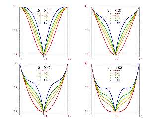

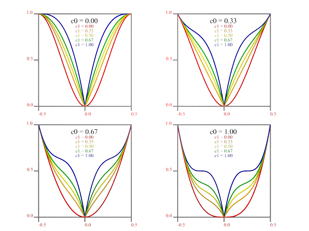

Perhaps I'm wrong or misreading something, but it doesn't appear that the
documentation properly describes the pattern.
http://wiki.povray.org/content/Reference:Quilted_Pattern
Just looking at the last image,
"A control value of 1 at both ends will give an "s" shaped curve, resulting in a
softer, more rounded edge."
yet the solid line is the s-shaped curve, and it says for that c1 = 0.
After skimming through the source code in patterns and normals, the basic
formula used to generate the curve seems an awful lot like a specialized form of
bicubic spline with c0 and c1 influencing the internal two control points...
but it's ... bizarrely different.
And I can't reproduce the curves and s-shape reliably.
And I don't know why they don't use a function based on 2*x, or use mod(), ...

Yes, I'm not quite sure what's going on there either.
Though I specified defaults of 1 and 1 it looked to me more like 1 and 0
or 0 and 1 depending on how the normals flip on the half unit
intervals... I didn't dive into it. ;-)
One of the complications is the curves as shown have one value inputs.
The result we 'see' is a combination of three applications to three
input values. Ahhh, as I expect you know! :-)
