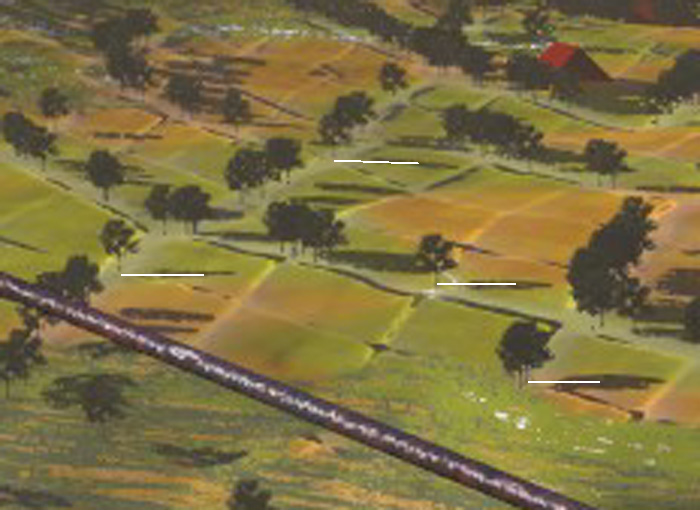

Download 'pending storm close-up.jpg' (111 KB)
Preview of image 'pending storm close-up.jpg'
