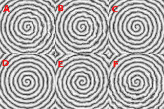

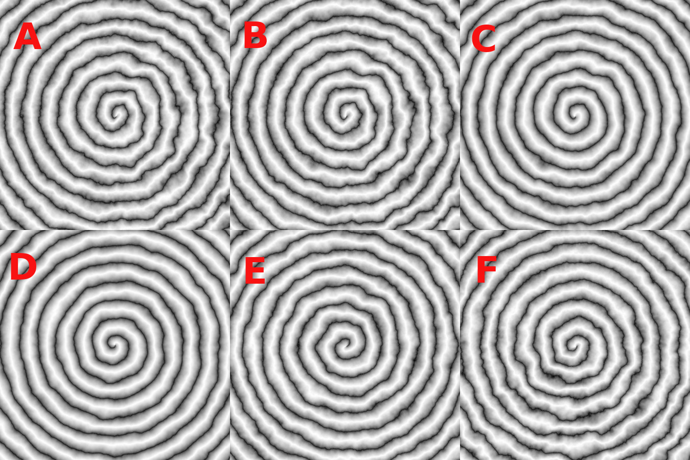

Attached is an image showing size renders labeled A thru F all showing
spiral1 examples.
(A) v3.8 current tangled turbulences.
     spiral1 1
     turbulence (1/3)*0.5
(B) A version of povr with only the Turbulence() omega distribution
drift fix, but otherwise still tangled turbulences.
     spiral1 1
(C) v3.8 again, but where we turn off both the internal value turbulence
and the spatial x turbulence by coding the full vector with x at 0:
     spiral1 1
     turbulence <0,(1/3)*0.5,(1/3)*0.5>
(D) A current povr render with the it_, internal turbulence, keywords.
Here with it_frequency we get only the pattern's value turbulence.
     spiral1 1
     it_frequency (1/3)*0.5
(E) A current povr render with the it_, internal turbulence, keywords.
Specifying and getting only spacial turbulence.
     spiral1 1
(F) A current povr render with the it_, internal turbulence, keywords.
Specifying and getting both the internal value and spacial turbulence.
     spiral1 1
Aside: Originally I was going to get rid of classic turbulence in povr,
but, as mentioned recently elsewhere, it allows updates on inheriting
from an existing pattern, so now thinking I'll keep it. Making, in the
special turbulence cases this sort of turbulence/warp order:
it_ <-- classic turbulence <-- warp { turbulence, et al }
Aside: In povr I moved the wood pattern's use of DTurbulence() to
Turbulence() so it uses the pattern specific noise generator if one is
specified. The wood pattern was somewhat unique in always using noise
generator 2 due the DTurbulence() use.
Aside: Due the omega distribution drift in Turbulence() I expect at
times, with these special turbulence patterns, folks were mostly getting
the spatial turbulence.
FWIW.
Bill P.

From: Bald Eagle
Subject: Re: Documenting special turbulence handling tangle.
Date: 24 Sep 2020 06:30:00
Message: <web.5f6c7526eb757e1a1f9dae300@news.povray.org>
And so you continue to peel away the layers of the onion...
Any reason E spirals in the reverse direction than all the others?
From: William F Pokorny
Date: 24 Sep 2020 07:50:10
Message: <5f6c87f2$1@news.povray.org>
:-) I completely missed that!
When I reworked the two spiral patterns for povr, I changed the
orientation (starting position) to match other patterns like radial (
atan2(y,x) ) - except not using atan2.
To match the v3.8 results I inserted a transformation and I missed a '-'
(or accidentally deleted it) on that render.
I'll mention one more detail too, because it's really a bug. Sometime
after v3.7, during one of the pattern and parsing refinements, the code
for function spiral pattern parsing was incorrectly updated. The code,
currently in parser_materials.cpp, reads:
CASE (SPIRAL1_TOKEN)
     New->Type = GENERIC_PATTERN;
     New->pattern = ParseSpiralPattern<Spiral2Pattern>();
END_CASE
CASE (SPIRAL2_TOKEN)
END_CASE
That first ParseSpiralPattern template parameter should be Spiral1Pattern.
In recent v3.8s it means pattern use is OK, but function { pattern {} }
use always uses spiral2.
Bill P.
