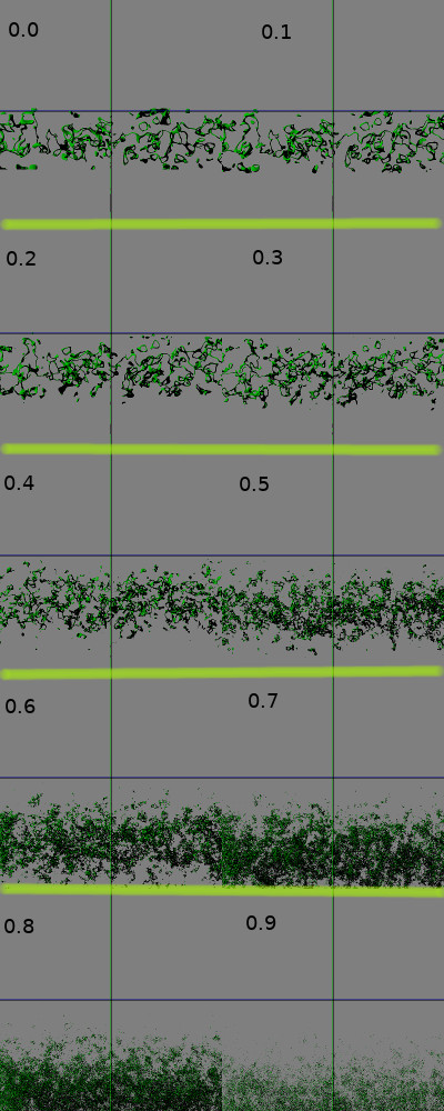

Working on an in-buit f_turb and think I finally tracked down an issue
which has harassed me for years.
Our turbulence moves with omega. This looks not right to me given what I
understand Brownian Motion to be. The code is effectively unchanged
since it was added in v3.0. I'd expect with increasing omega for the
distribution to get larger and possibly larger than 1.0 (docs mention
this). What seems amiss to me is the more or less linear shift in the
center of the distribution with omega.
If you don't know turbulence is doing this, using it can be very
confusing. "My isosurface foliage doesn't line up with my iso tree
branches - and everything leans one way!"
The irid (comment there about Turbulence returning 0-1 range) and fog
features use Turbulence() I see. Expect the vector version of turbulence
affected too. Agate of course, though probably hard to see any shift
there - or maybe with any traditional pattern. More shift goes with more
noise typically.
In the attached image created a set up which shows the distribution
moving from a center of 0.25 and range of 0.5 to a center of about 2.0
and a range of 4 as you approach an omega of one. Other settings seem
not to matter much to the distribution, except as looks OK to my eye.
I think the distribution should be centered at 0.1 coming out of
Turbulence() and DTurbulence() and it being a smaller or larger
Gaussian, but...
Making a new f_turb centered and using only that sort of turbulence with
isosurfaces doesn't really fly. I want to exploit the pattern warp stuff
extensively including turbulence.
Anyone know the history with turbulence? Thoughts, opinions?
I've not yet tried to understand why the distribution's center is
moving. I also suspect it's not spreading as much as it should, but I
care about that less.
Bill P.
Download 'turbomegadistributiondistortion.jpg' (135 KB)
Preview of image 'turbomegadistributiondistortion.jpg'

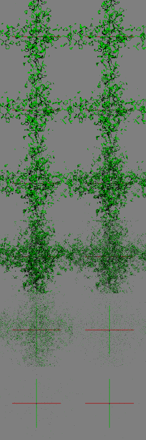

First, we are not as bad off as I first guessed. All of the vector
related turbulence uses DTurbulence which uses DNoise() and these
already do return a 0.0 centered in a -1 to +1 range. See the attached
image.
This vector behavior is what we want I think. However, it doesn't match
our documentation which says the values are in a 0-1 range for
turbulence. As far as I know there is no user direct access to
non-vector turbulence(1) so even if that were the aim of today's code in
turbulence that's never been what is happening best I can see (some pre
v30 thing maybe?).
(1) - f_vturb() in povr will be this.
I was - more - confused when I posted the initial image. I'd forgotten
that I'd changed my usual axises from +-1 to +-2 - AND scaled the
returned values from Turbulence() by 0.5 trying to see all the
distribution centers. So, the typical distributions from Turbulence
today are all the way out at +4.0 not +2.0 as I said...
In a survey of affected code:
The patterns agate, marble, spiral1, spiral2 where turbulence is used
will be getting violent shifts both on use of turbulence where not a
default and on omega changes. Aside: wood uses turbulence too by in x
and y so DTurbulence() and is OK. The plan is to do nothing with the
affected patterns post Turbulence() change unless something pops.
The finish irid feature assumes a 0-1 distribution and does some math to
get a zero centered, -1 to 1 one for further calculation. It hard codes
the turbulence parameters and has omega at 0.5. This feature has some
other issues like lack of ability to scale relative to the incoming
coordinates which will make it tricky to get something which always
works with respect to scene dimensions. The documentation also mentions
irid_amount and I don't see it anywhere in the calculations... I think
given numerical accuracy there should be some >=0 clamping to not
sometimes get negative thicknesses... Anyway work to do here.
Not tested to confirm, but the fog features using turbulence I suspect
are in bad shape. There is a min(1.0,Turbulence(..)... bit used a ouple
places which I believe will make it very hard to get much turbulence
given the distribution center is way the heck out at 4.0 with defaults!
Up front plan is to make no code changes here. I think the Turbulence()
fix will make fog turbulence better.
Bill P.
Download 'storyvectorturbulence.png' (306 KB)
Preview of image 'storyvectorturbulence.png'

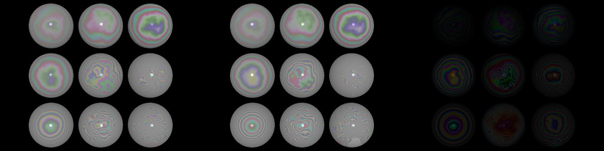

Attached an image up the updated irid code running with the fixed
Turbulence(). I also added the clamp to prevent the film thickness from
going below 0.0 and one of our demo scenes hits this clamp. See the
lower right sphere in the middle set. Less colorful result but I think
correct. There is no film there.
I also tried for a matching fudge factor to match the breadth of the old
Turbulence() distribution. Cannot match previous precisely, but not bad
in my view.
Bill P.
Download 'iridturbulencedistfixandclamp.jpg' (72 KB)
Preview of image 'iridturbulencedistfixandclamp.jpg'

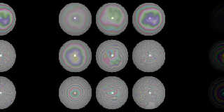

Yeah - iridescence seems ... "special".
Using Iridescence
"Iridescence is what we see on the surface of an oil slick when the sun shines
on it. The rainbow effect is created by something called thin-film interference
(read section Iridescence for details). For now let's just try using it.
Iridescence is specified by the irid statement and three values: amount,
thickness and turbulence. The amount is the contribution to the overall surface
color. Usually 0.1 to 0.5 is sufficient here. The thickness affects the busyness
of the effect. Keep this between 0.25 and 1 for best results. The turbulence is
a little different from pigment or normal turbulence. We cannot set octaves,
lambda or omega but we can specify an amount which will affect the thickness in
a slightly different way from the thickness value. Values between 0.25 and 1
work best here too."

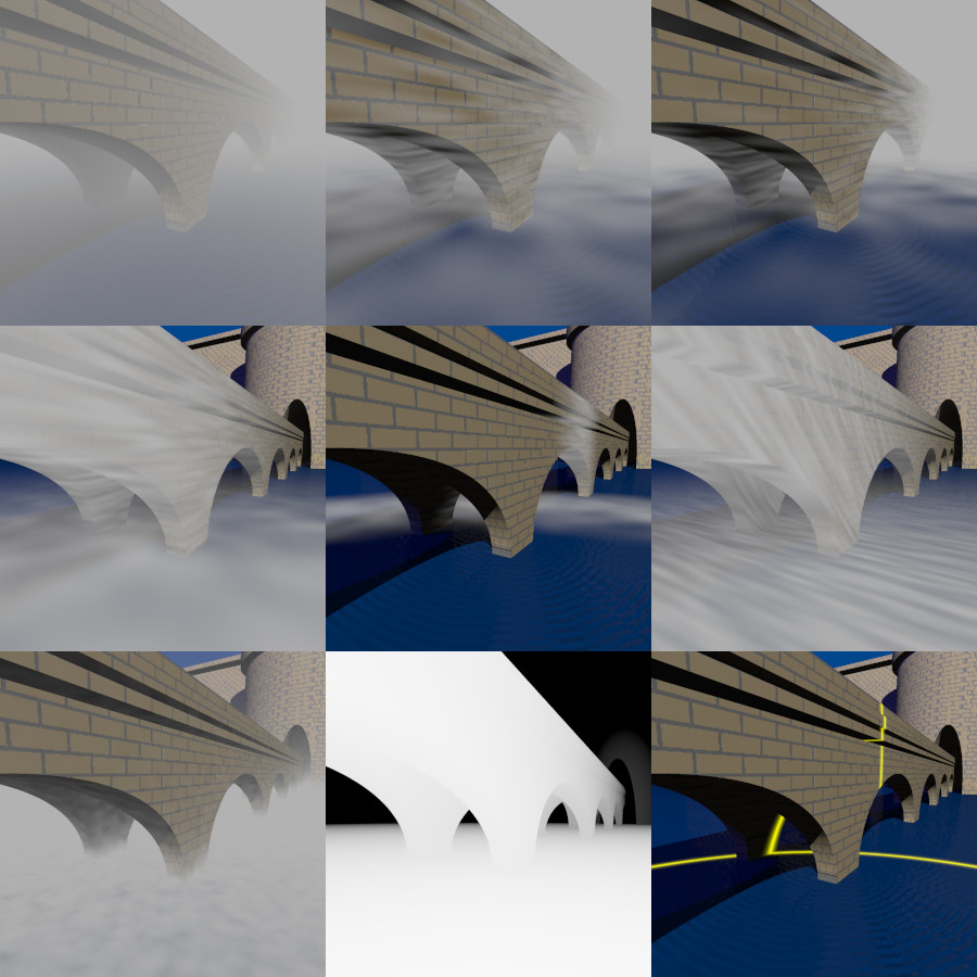

yeah wow - that's WAY out there...
Yep...

I am probably wrong, but I seem to recall that Christoph did some
massive work in overhauling iridescence a number of years ago...? Indeed
in 2011:
http://news.povray.org/povray.binaries.images/thread/%3C4ed6f24c@news.povray.org%3E/
...there should be more about this.
Or is this unrelated to the present problem?

Thank you for the newsgroup pointer.
His updates - assuming they are the code I see - are tangle with this
problem because Turbulence() wasn't - or isn't now in any case -
returning the distribution and range assumed in the code.
Christoph's changes were - I believe made for the v37 release. The
documentation notes changes to actual physical dimensions for v37(1).
Which, on more thought, means I need to yank my fudge matching, magic
factor back out of the code and update the scenes for the proper end
thicknesses given the turbulence instead!
He mentions being unable to scale for the same effect - which I believe
is correct with respect to the viewer frame. I'm suggesting when using
turbulence adding some method to scale and/or shift the turbulence of
the thickness a good idea given the difficulty matching up with changing
scene scaling of some object. Like media and density, if you want the
turbulence to be constant (maybe yes, maybe some, maybe no) you'd need
to 'counter' adjust it in some way on scene scaling - we cannot do this.
(1) The documentation in r3_6.html#r3_6_1_3_7 has this 3.7 note:
"Note: The version 3.7 iridescence feature has had a major overhaul. The
syntax remains the same, however, both the thickness and amount values
are now specified in microns. Consequently, iridescence effects will
vary from previous versions."
which emphasizes 'both' thickness and amount being in microns. The
'thickness amount' is, and the 'turbulence amount' is, but the
irid_amount is just a color intensity multiplier for the irid_wavelength
color specified in global_settings. We could likely help new to irid
users by making this clearer.
The "See also the global setting Irid_Wavelength for additional
information." sentence I think should probably be up in the paragraph
with irid_amount because - indirectly - this is the 'amount' of color,
color to which it's related.
> in my view.
In povr, irid updated to yank fudge factor and scenes updated with
accurate base thicknesses. Thanks Thomas.
When I looked at the fixed internal turbulence() with fog picked up
additional bugs I expect kept folks from doing a lot especially with
turbulence (copy constructor was creating new, but not copying old
turbulence values, for example).
Anyway. In povr I've got the turbulence() fix in - with fixes to irid
and a significant re-work of fog updating and adding features/keywords.
Image attached showing some of the fixed and extended features.
The agate pattern looks different, but OK, with the turbulence() fix.
Not looked in detail at marble or the two spiral patterns as yet. Still
some f_turbulence() work to finish off.
Bill P.
Download 'fogstory.jpg' (148 KB)
Preview of image 'fogstory.jpg'
Subject: Re: Our turbulence distribution moves with omega.
Date: 4 Jun 2020 02:27:56
Message: <5ed8946c$1@news.povray.org>
Well done, sir. Keep up the good work!
