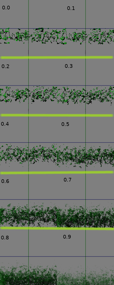

Working on an in-buit f_turb and think I finally tracked down an issue
which has harassed me for years.
Our turbulence moves with omega. This looks not right to me given what I
understand Brownian Motion to be. The code is effectively unchanged
since it was added in v3.0. I'd expect with increasing omega for the
distribution to get larger and possibly larger than 1.0 (docs mention
this). What seems amiss to me is the more or less linear shift in the
center of the distribution with omega.
If you don't know turbulence is doing this, using it can be very
confusing. "My isosurface foliage doesn't line up with my iso tree
branches - and everything leans one way!"
The irid (comment there about Turbulence returning 0-1 range) and fog
features use Turbulence() I see. Expect the vector version of turbulence
affected too. Agate of course, though probably hard to see any shift
there - or maybe with any traditional pattern. More shift goes with more
noise typically.
In the attached image created a set up which shows the distribution
moving from a center of 0.25 and range of 0.5 to a center of about 2.0
and a range of 4 as you approach an omega of one. Other settings seem
not to matter much to the distribution, except as looks OK to my eye.
I think the distribution should be centered at 0.1 coming out of
Turbulence() and DTurbulence() and it being a smaller or larger
Gaussian, but...
Making a new f_turb centered and using only that sort of turbulence with
isosurfaces doesn't really fly. I want to exploit the pattern warp stuff
extensively including turbulence.
Anyone know the history with turbulence? Thoughts, opinions?
I've not yet tried to understand why the distribution's center is
moving. I also suspect it's not spreading as much as it should, but I
care about that less.
Bill P.
Download 'turbomegadistributiondistortion.jpg' (135 KB)
Preview of image 'turbomegadistributiondistortion.jpg'

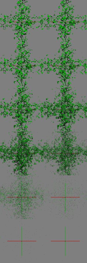

First, we are not as bad off as I first guessed. All of the vector
related turbulence uses DTurbulence which uses DNoise() and these
already do return a 0.0 centered in a -1 to +1 range. See the attached
image.
This vector behavior is what we want I think. However, it doesn't match
our documentation which says the values are in a 0-1 range for
turbulence. As far as I know there is no user direct access to
non-vector turbulence(1) so even if that were the aim of today's code in
turbulence that's never been what is happening best I can see (some pre
v30 thing maybe?).
(1) - f_vturb() in povr will be this.
I was - more - confused when I posted the initial image. I'd forgotten
that I'd changed my usual axises from +-1 to +-2 - AND scaled the
returned values from Turbulence() by 0.5 trying to see all the
distribution centers. So, the typical distributions from Turbulence
today are all the way out at +4.0 not +2.0 as I said...

Download 'storyvectorturbulence.png' (306 KB)
Preview of image 'storyvectorturbulence.png'

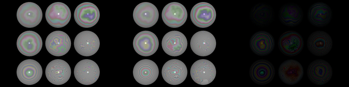

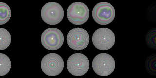

Attached an image up the updated irid code running with the fixed
Turbulence(). I also added the clamp to prevent the film thickness from
going below 0.0 and one of our demo scenes hits this clamp. See the
lower right sphere in the middle set. Less colorful result but I think
correct. There is no film there.
I also tried for a matching fudge factor to match the breadth of the old
Turbulence() distribution. Cannot match previous precisely, but not bad
in my view.
Bill P.
Download 'iridturbulencedistfixandclamp.jpg' (72 KB)

Using Iridescence
"Iridescence is what we see on the surface of an oil slick when the sun shines
on it. The rainbow effect is created by something called thin-film interference
(read section Iridescence for details). For now let's just try using it.
Iridescence is specified by the irid statement and three values: amount,
thickness and turbulence. The amount is the contribution to the overall surface
color. Usually 0.1 to 0.5 is sufficient here. The thickness affects the busyness
of the effect. Keep this between 0.25 and 1 for best results. The turbulence is
a little different from pigment or normal turbulence. We cannot set octaves,
lambda or omega but we can specify an amount which will affect the thickness in
a slightly different way from the thickness value. Values between 0.25 and 1
work best here too."
> I think
given numerical accuracy there should be some >=0 clamping to not
sometimes get negative thicknesses
maybe abs() ?
> Not tested to confirm, but the fog features using turbulence I suspect
> are in bad shape. There is a min(1.0,Turbulence(..)... bit used a ouple
> places which I believe will make it very hard to get much turbulence
> given the distribution center is way the heck out at 4.0 with defaults!
yeah wow - that's WAY out there...
