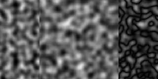

Today, with something like dents, we can be working up a dents based
pattern planning some eventual functional customization - fading the
center portion to 1.0 or whatever. We start with:
#declare Pigm00 = pigment {
dents // The render is quicker starting with the pattern dents.
// function { f_dents(x,y,z)*f_fade(x,y,z) }
noise_generator 3 // Get the scene's setting - or 2 in demo.
scale 1/6
In the attached dents_to_f_dents_patNoise3.png the dents / ng(3) is
shown on the left. The function { f_dents...} ng(3), but really (2) is
shown on the middle. And yeah, I think the difference "pattern" between
the two noise generators on the right might be a useful pattern itself...
Not all patterns were updated noise gen 1 to 2.
Patterns like granite were adjusted on the change from noise generator
Skinner form 1 to 2 so they more or less look similar with both. The
dents and f_dents was not one of these and the form 1 version is quite
different.

(a) - Mostly due the overhead of passing the function back into the
pattern mechanism. For maps use the inbuilt patterns if there is one
over any equivalent function.
(b) - Excepting there is an inbuilt f_noise_generator() function which
has a parameter which allows the noise generator to always be set. It's
indentical f_noise3d() except the latter - in official POV-Ray - always
uses the scene's noise generator setting.

William F Pokorny <ano### [at] anonymous org> wrote:
> Performance stuff.
Very educational. Certainly something to aware of when writing more advanced
scenes.
> Results stuff due function noise generator handling!
> If you work enough with functions and patterns, you'll eventually stub
> your toe on the fact functions use only the scene setting for the noise
> generator(b) and not any pattern specific ones. This can be really
> confusing.
Thanks for documenting this here. I'm not sure I would have noticed if/when it
mattered, and would have been tearing my hair out trying to debug the SDL....
