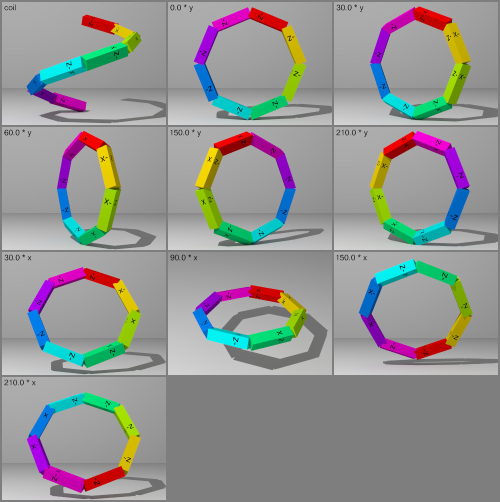

I want to string objects together in a chain.  Each segment is initially
defined vertically, then rotated using macro Reorient_Trans() before
being translated into position.
When I string the objects together, they usually end up rotated with
respect to each other.  Since the objects all start out vertical, a
simple counter-rotation about y should align them.  The question is, by
what amount?  I've been wrestling with this problem for days, and I am
utterly stumped.  I even tried bypassing Reorient_Trans() altogether,
the result being boxes scattered seemingly randomly all over the place.
Is there a general solution to this problem?
This is the code for the images in montage reorient-twist-pbi.jpg:
--------------------[BEGIN CODE]--------------------

---------------------[END CODE]---------------------

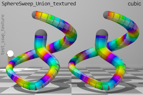

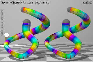

Such a solution would have obvious application toward uv-textured sphere
sweeps.  Image test_sswp_textured10.jpg shows the suboptimal results
when the cylindrical warp is transformed with Reorient_Trans() without
any counter-rotation.  (Filling in those gray gaps is a separate issue
that I'm not inclined to address while I have this more fundamental
unsolved problem.)
Download 'reorient-twist-pbi.jpg' (189 KB) Download 'test_sswp_texture10.jpg' (55 KB)
Preview of image 'reorient-twist-pbi.jpg'
Preview of image 'test_sswp_texture10.jpg'
