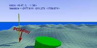

See my latest post in p.t.general. The yellow rod is situated about -200
pov units from the trace arrow.
Download 'islaytest.png' (368 KB)
Preview of image 'islaytest.png'

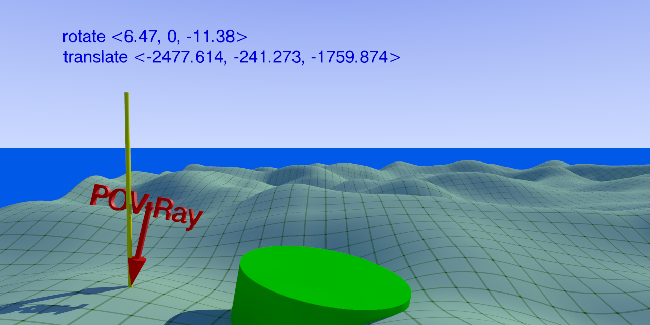

I got side-tracked by a surprising and different problem, concerning your test
image. I rendered the same view (as close as I could get-- using CamAng of 80),
and found that you and I are indeed getting different results(!) I have no idea
what the reason might be. My 2nd 'blended' image shows that we are at least
rendering the same view, and with the yellow rod in the same place. Why our red
arrows don't match is a mystery! Very strange. (Unless we are somehow using
different methodologies?? I doubt that, though.)
For the yellow rod in the position it's currently in, did you get the same
screen_x_position and screen_y_position values that I did (or nearly so)?
This is a mystery that we definitely need to solve ;-)
Download 'islaytest_1_kw.jpg' (388 KB)
Preview of image 'islaytest_1_kw.jpg'

> My bad, as I misplaced the rod by one square :-/
Ha! Tt is always a relief when a so-called 'problem' has a simple solution :-P
At some point, I hope to find a good solution to the arrow-offset problem
itself.
Download 'islaytest_2_kw.jpg' (199 KB)
Preview of image 'islaytest_2_kw.jpg'

But I just discovered something in Norbert's core math code that is of interest
(in a small way): Until now, I've been thinking that the arrow-offset problem is
*somehow* related to his initial cam_z equation-- specifically the
tan(radians(cam_ang*0.5)  part-- because of the use of  tan  itself. (As an
angle approaches 90, tan(90) approaches infinity, which seems problematic. But
then again, his tan equation is working on only HALF the given angle-- so
tan(90) would never happen anyway.) BTW, it's not clear to me why he specified
radians rather than degrees, as a camera angle is specified in degrees(?), or
something similar.
HOWEVER... I've been experimenting with the cam_z equation itself-- and found
that no matter what I do to it, it has no effect on the arrow position, or on
anything else in the scene(!). I even commented-out the equation, and
substituted some wildly-different integer values just for kicks... again with no
effect. I EVENTUALLY realized that cam_z is actually used only once, in cam_dir.
And cam_dir isn't used at all!
I have no excuse for not seeing this until now. :-(
So, cam_z and cam_dir can be erased from the code, to make it a bit simpler to
examine.
> something similar.
> examine.
I have been wondering also about those parameters. I had assumed that
cam_dir was supposed to be the value for the direction parameter in the
camera block. Putting cam_dir there does not do anything vital, so maybe
it is some obsolete leftover from earlier versions? Puzzling, to say the
least.
I agree with you about the radians. There seems to be no need for them
but if cam_z is not used, I don't worry :-)

Or, maybe that's actually the problem?
A macro that tries to probe where a particular pixel's ray hits the
scene must know - and process - /something/ about the camera opening angle.

So, I've just been dabbling with this in the odd 5-10 minute blocks of free time
that I have, and trying to see what I did with modeling the camera's view
frustum.
Let's suppose we're using the default camera, with the camera at the origin, the
"canvas"/image plane at z=1, right x, up y, sky, y, direction z, look_at z
If you're going to select pixels, then you want to translate those values so
that you get the +/- 0.5 range for x and y, with the center being <0,0>
Just divide the pixel value by the width and subtract 0.5 to give a range of
-0.5 to 0.5
Do the same for y and height, and flip the sign
Then to project that point "out" into the 3D scene, you just multiply all those
values by the z value (returned by trace() )
Because similar triangles.
This is not the hard part - the hard part is doing this when the basis vectors
are different - when the camera and look_at values, etc aren't axis-aligned.
So for envisioning what to do:
1. Take the scene's camera values and rotate everything so that it's in the
"default" frame.   (more to do if there's shear, etc.)
2. Do the simple math.
3. Rotate everything back by doing exactly the opposite of what you did in step
1.
And this is where I think the transform matrix approach will really shine.
I just need enough uninterrupted round-tuits to get oriented and forge far
enough ahead.

Date: 3 Oct 2018 04:00:29
Message: <5bb4771d@news.povray.org>
So, I manage to get the arrow on the rod by tweaking:
#local dir_y  = vaxis_rotate (lookat-cam_loc, vcross (cam_d, cam_up),
(0.483-screen_y_position*0.01)*cam_ang/image_width*image_height);
#local dir_xy = vaxis_rotate (dir_y, cam_up,
(0.535-screen_x_position*0.01)*cam_mirror*cam_ang);
replacing the 0.5 value by respectively 0.483 in dir_y and 0.535 in dir_xy.
Of course, this is entirely by just dumb trial and error, and I highly
doubt if it is significant. I wonder now if it holds for other scenes...
tests to do...
Download 'islaytest.png' (360 KB)
