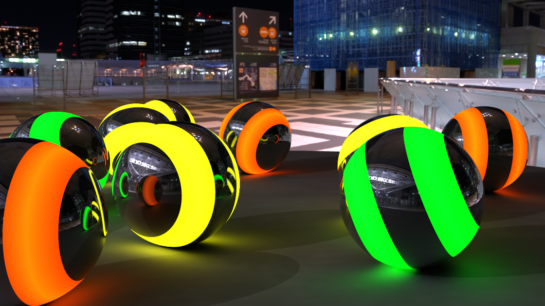

well i'm kind of chasing my tail so i thought i'd ask for some guidance.
i'm using radiosity and a very dim point light to get some shadow
action. check out the lower left hand corner of the image. that's what
i'm shooting for! why don't the other spheres have the same affect?
other that the color there's no diff...the emission component is the
same level for all the colors. is it more about the emission of the
object or the surface that is showing the affect.

Subject: Re: i be stumped
Date: 23 Aug 2018 02:30:28
Message: <5b7e5484$1@news.povray.org>
Hum... Have you tried to switch the colours? It looks like the red
spheres are subdued but still the emission is visible; blue is hardly
visible at all. The green seems much brighter though. Make other spheres
green too and see what happens.
From: clipka
Date: 23 Aug 2018 06:16:24
Message: <5b7e8978$1@news.povray.org>
Am 23.08.2018 um 02:36 schrieb Jim Holsenback:
Looks to me like a radiosity setting issue, with too low sample density.
In the bottom left corner, by chance a sample was taken very close to
the base of the green... tron unicycle?... and picked up the emission
very nicely, while all other samples were taken comparatively far away
from the gizmos.
There are various knobs you might try tweaking here, but my personal bet
is that `error_bound` is set too high. You'll probably want a value of
0.5 or even lower. The default of 1.8 certainly won't cut it.
In reducing `error_bound` you may find that the result looks unnaturally
splotchy. If it is a general effect, try increasing `nearest_count`
and/or `count` to compensate. If instead (or after you adjust
`nearest_count` and/or `count`) the splotchiness is limited to nooks and
crannies, try reducing `minimum_reuse`.
Reducing `error_bound` (and, in some cases, increasing `count`) may also
introduce block-like artifacts. Those should be easy to fix by reducing
`pretrace_end`. A too high `pretrace_end` may also prevent changes to
`nearest_count` from being fully effective.
From: Jim Holsenback
Date: 23 Aug 2018 06:19:47
Message: <5b7e8a43$1@news.povray.org>
>> guidance. i'm using radiosity and a very dim point light to get some
>> shadow action. check out the lower left hand corner of the image.
>> that's what i'm shooting for! why don't the other spheres have the
>> same affect? other that the color there's no diff...the emission
>> component is the same level for all the colors. is it more about the
>> emission of the object or the surface that is showing the affect.
yep tried that already!!! with them all green still only the lower left
sphere?!? with them all red same thing .... lower left. i tried killing
the point light and the emission from the hdr dome... same deal. i
started getting results by jacking up the pigment component... red
channel, blue channel etc... makes me think radiosity is the issue. i'm
using defaults except the following:
gray_threshold 0
brightness 1
media on
normal on
count 1024
From: clipka
Date: 23 Aug 2018 06:27:29
Message: <5b7e8c11@news.povray.org>
Am 23.08.2018 um 12:19 schrieb Jim Holsenback:
> gray_threshold 0
> brightness 1
Just for the records, those also happen to be the default values.
Date: 23 Aug 2018 06:30:37
Message: <5b7e8ccd$1@news.povray.org>
> from the gizmos.
your response wasn't here when i was following up to thomas ... but yep
lowering nearest_count started getting close to expected results... a
little splotchy but i think you've set me on the right path... danke
Date: 23 Aug 2018 06:41:24
Message: <5b7e8f54$1@news.povray.org>
>> gray_threshold 0
>> brightness 1
lol yes...i had them as placeholders...tweaking those. i /was/ already
thinking it was radiosity related issue.
From: clipka
Date: 23 Aug 2018 07:34:26
Message: <5b7e9bc2@news.povray.org>
Am 23.08.2018 um 12:41 schrieb Jim Holsenback:
>>> gray_threshold 0
>>> brightness 1
Don't tweak those two - they're fine. Especially messing with
`gray_threshold` will only make the effect less colourful.

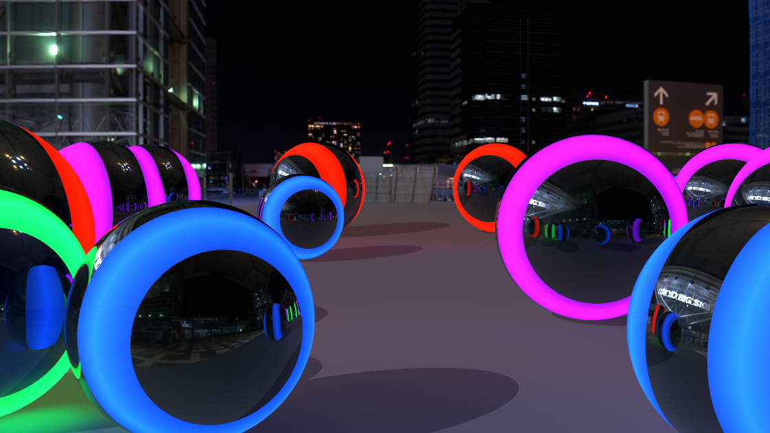

Date: 25 Aug 2018 19:32:53
Message: <5b81e725@news.povray.org>
On 08/22/2018 08:36 PM, Jim Holsenback wrote:
> well i'm kind of chasing...
made some progress! here's what i ended up with for radiosity:
media on
normal off
count 512
error_bound 0.1
nearest_count 15
minimum_reuse 0.01
i'd like to maybe add a few more spheres but i'm having issues with my
placement macro...a one point i had them all looking like the were
worshiping the light source. at least now there's a bit or randomness. i
need to get a few more things in order before i commit this to a beauty run
Download 'work.png' (2076 KB)
Preview of image 'work.png'
From: clipka
Date: 26 Aug 2018 05:16:16
Message: <5b826fe0$1@news.povray.org>
I think your sky dome is the wrong way round. Noticed it when text
reflected in the spheres seemed "forward" when it should appear
mirrored, but the sign in the background also gives it away, with the
text apparently right-aligned.
Date: 27 Aug 2018 03:39:07
Message: <5b83aa9b$1@news.povray.org>
yes i noticed that ... just low on the list
