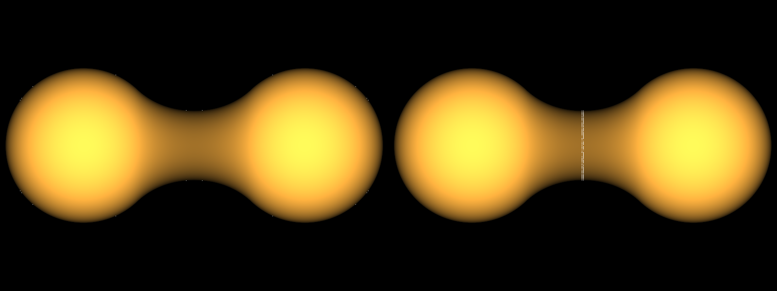

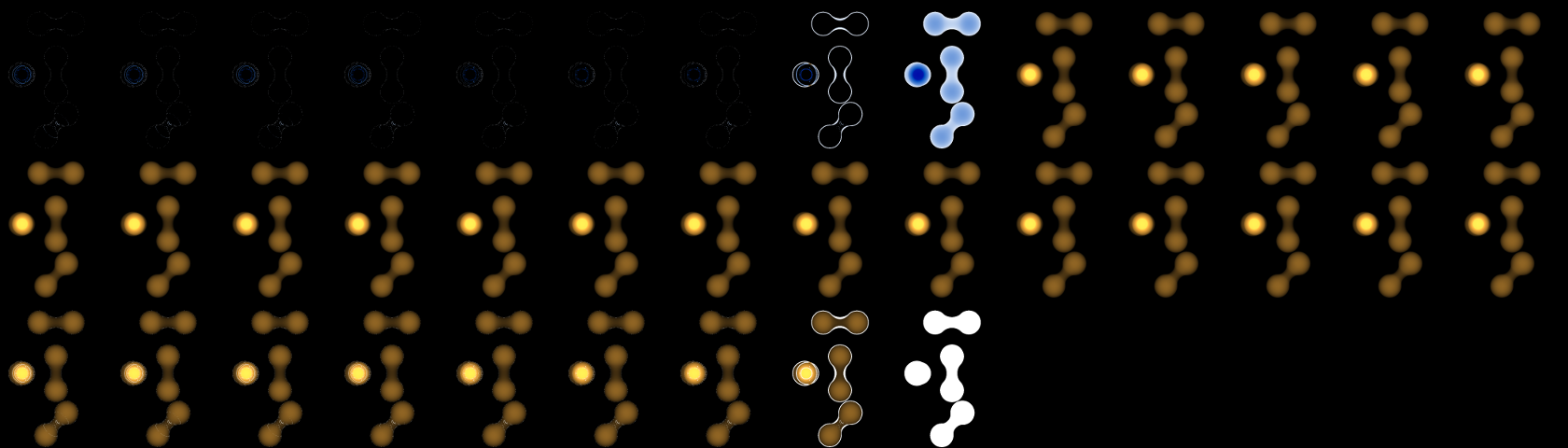

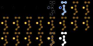

In continuing to look at media I returned to a 'blob-media' issue Gail
Shaw originally posted back in 2005. The bright spots at the very edge
are indeed caused by the 'intersection depth < small_tolerance' or
missed intersection issue as Slime guessed at the time.
However, the sturm result Gail showed never made any sense unless sturm
is broken for blobs. Gail's original belief something changed 3.5 to 3.6
was correct. Optimizations were done involving bounding and polynomial
reformulation for 3.6 which occasionally inhibit 4th to 3rd order
reduction(1). The bright spots not on the edge happen where
Solve_Polynomial passes the original 4th order blob equation to
polysolve and we get bad roots back.
(1) - Happens mostly with transparency.
In the lower left in the attached image I hacked the code to prevent
order reduction with blobs. Surprised to find it looks like blobs only
work as formulated due order reduction - even in v3.5.
All got me digging again into the solver code. Since v1.0 there has been
a regula_falsa function called once the rule of signs stuff has
determined a sub-interval contains a single root. The regula_falsa is
buggy once polynomial order is >= 4 given how many of our polynomials
are formulated - the evaluated values can be very small.
I've coded up a branch modifying the regula_falsa function so it sanity
checks the root found is a real root - within some tolerance - otherwise
it invalidates the root and tosses control back to the interval
bisection code.
Branch fixes this blob issue, the lathe issue #335 from last fall and
many remaining #147 (sphere_sweep) solver issues - except one b_spline /
orthogonal camera case. The patch also fixes or makes better many of the
accuracy issues I have in hand, however, I have too still some scenes
with 'accuracy' issues to dig through. The work is tedious and I need a
break - so putting out the fix I have.

Download 'blobsturmbroken.jpg' (129 KB)
Preview of image 'blobsturmbroken.jpg'

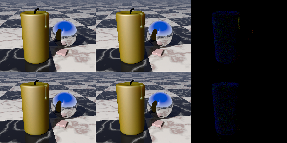

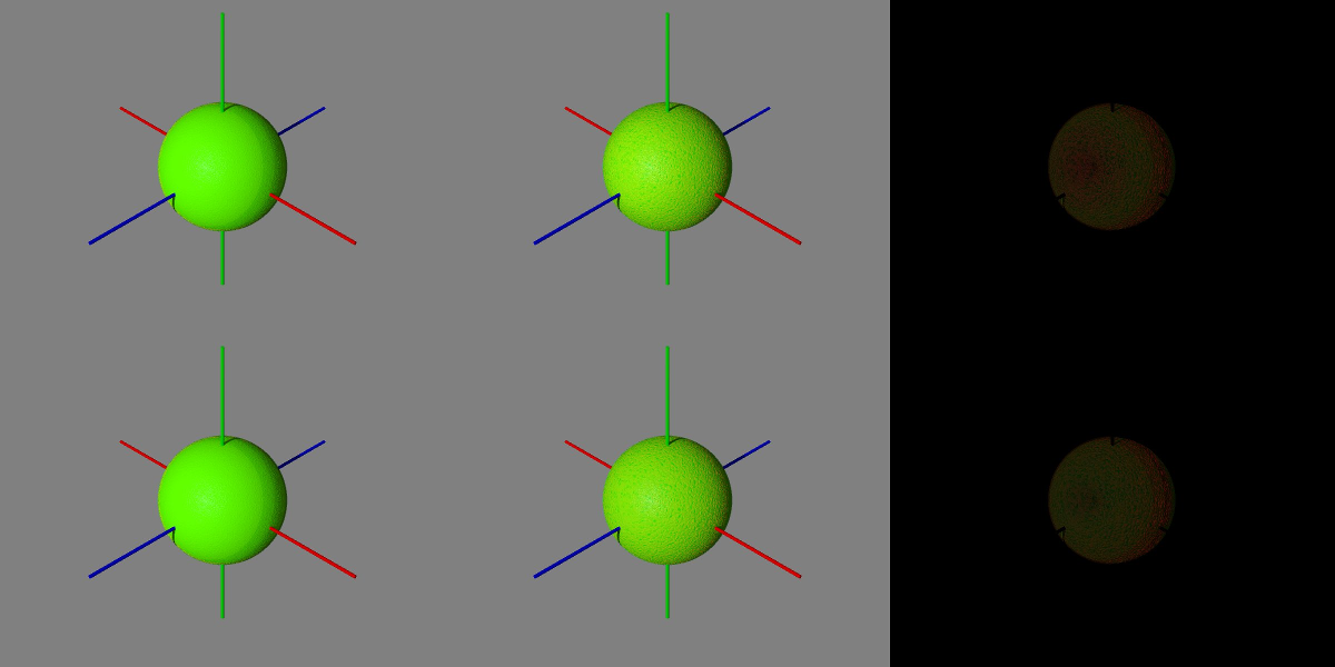

I've run down another type of solver issues related to our sor object.
In this case the problem is with the sor polynomial set up often not
crossing through 0.0 which is a requirement for the sturm / polysolve
methods.
The ray / sor set up sometimes creates sets of coefficients which are
are all positive or negative which sturm / polysolve sees as meaning
there are no roots to find. The fix is to perturb the direction vector
by +EPSILON during the set up which is in my testing enough to get the
crossing 0.0 criteria always.

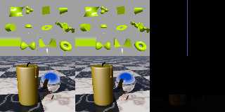

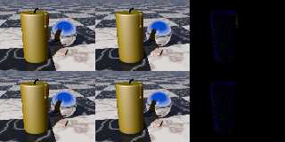

I started with a sor scene shown in the top row of the attached image
which Severi Salminen posted in 2004. v381 shown on the left and the fix
on the right.
(The remaining three rows show differences at 4x the real magnitude.)
The second row is our shipped sor1 sample scene which doesn't use sturm
at all. I expected no difference, but the 'sturm off', solve_cubic()
function is also failing to find roots on reflected rays which I didn't
previously notice. The +EPSILON change perturbs these noisy solution
regions.
The third row is the same sor1 scene, but with sturm turned on for all
sor objects meaning polysolve gets used. The difference on the right of
row 3 shows how a noisy original solution is cleaned up with the fix.
The last row shows the updated code's solve_cubic solution vs the 'sturm
on' / polysolve solution.  Note that 'sturm on' is needed for clean
roots & a clean sor1.pov image.
Aside: Yes, it's looking like continued rays whether transmitted or
reflected tend to be harder for the solvers to handle. This echoes back
to early lemon issues with noise when the texture had a reflective
component. Also true errors in continued rays are often harder to see
given the contributions are mixed with any ambient or diffuse components.
I've more solver accuracy issues to run down, but I've updated the
branch at:
https://github.com/wfpokorny/povray/tree/fix/polynomialsolverAccuracy
with this sor polynomial set up fix for those interested.
Bill P.
Download 'sorsoverstory.jpg' (317 KB)
Preview of image 'sorsoverstory.jpg'

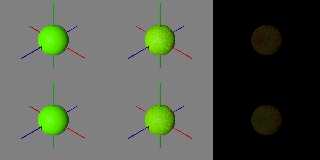

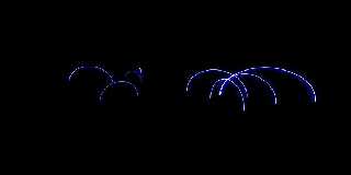

From: William F Pokorny
Subject: Re: Old media blob issue leading to a look at sturm / polysolve.
Date: 26 Apr 2018 08:35:58
Message: <5ae1c7ae@news.povray.org>
On 03/30/2018 08:21 AM, William F Pokorny wrote:
> A branch of master with the code update is available at:
> for those compiling their own POV-Ray versions. I plan to create a pull
> request once I've looked at some of the remaining accuracy issues.

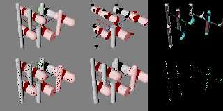

I've continued to work on the polysolve 'sturm' solver in recent weeks
and another set of updates is available at:
A couple quick notes followed at the bottom by more detailed change and
performance information. With respect especially to sphere_sweeps these
changes fix a number of bad or slightly bad root issues, but do not fix
missing root issues as shown in the attached image.
Another recent revelation has to do with the previous observation
continued rays seem to be more difficult for the sturm solver. There are
two major reasons for this.
One. The regula falsi method, while usually performing better than
bisection and guaranteeing a solution on proper set up, can - with
certain equations - be very, very slow to converge. Our transmitted,
internally reflected and self shadowing test rays all tend to create
polynomials which are a struggle for the regula_falsa() code.
Two. The polysolve code was always set up to jump to regula_falsa() once
it was known only one root existed on a 'ray' interval. The ray types
mentioned previously start with only one root as do rays with respect to
some surfaces. In these situations we do the work to set up the sturm
chain, use it to verify there is just one root - and immediately hand
often difficult to solve equations to regula_falsa() with the original
0.0 to MAX_DISTANCE interval. In these cases we are really using the
regula falsi method.
The changes below re-work things enough so as to be able to eliminate
the previously added sanity check at the end of regula_falsa(). Other
updates in the works.
Bill P.
Performance info:
------------ /usr/bin/time povray -j -wt2 -fn -p -d lemonSturm.pov
0)  master    30.29user 0.02system 0:15.83elapsed
0)  3f2e1a9   30.31user 0.00system 0:15.81elapsed
1)  7be07ff   29.99user 0.01system 0:15.65elapsed  -1.02%
2)  7f7eddd   29.91user 0.01system 0:15.61elapsed
3)  a621c04   19.63user 0.01system 0:10.45elapsed  -34.46%
4)  b2042e6   19.67user 0.02system 0:10.45elapsed
5)  58a1933   20.36user 0.01system 0:10.80elapsed   +3.51%
5a) 1c13a17   20.24user 0.00system 0:10.75elapsed
6)  7258366   19.33user 0.02system 0:10.31elapsed   -5.06%
7)  f313a5b   19.19user 0.02system 0:10.25elapsed   -0.72%
8)  cbd3af5   19.34user 0.01system 0:10.30elapsed   +0.78%
9)  687f57b   19.16user 0.01system 0:10.21elapsed   -0.93%   -36.77%

To better demonstrate attaching two images. In both the left column is
what the current master renders. The remaining columns to the right are
rendered with a float128 version of polysolve to better drive home the
point it our primary need isn't better overall accuracy, but more
accurate root isolation.
In the latheQuadratic.png image the top row is the point set from last
falls lathe issue used in a quadratic spline. The top row is a
perspective camera but zoomed way out and using a camera angle of 2. The
bottom row is the same input except with an orthographic camera set
up(1). In the middle column is what the current patched branch renders
using the SMALL_ENOUGH 1e-10 value. The value has been set so as to
behave well for the orthographic case, but this causes issues for the
perspective case. In the right column SMALL_ENOUGH has been set to
float128's minimum value of 1e-33. This orthographic case falls apart
showing the underlying ill-formed for sign change isolation problem -
while the perspective camera case is OK.
In the sphere_sweeps.png image showing the same progression(2) in
columns 1-3 but in column 4 we dial in a higher SMALL_ENOUGH value which
prunes off just the right about of the sturm chain for the root
isolation to work well.
I'm busy with real life for a while starting later today, but I think we
likely have a path to cleaner renders in these fringe cases given our
sturm chain based method.
We're working in a ray tracer and it is the ray's dx,dy,dz going to zero
which primarily causes the ill-formed for sign base root isolation
issue. We'll need to detect problem directions in the object's code and
create some calculation(3) which we'd pass all the way into the modp()
pruning. Possible I think.
Bill P.
(1) - It's not just the orthographic camera which tends to pull out the
worst case solver issues. Shadow rays with cylindrical and parallel
lights too. There are too the occasional rays which line up orthogonally
in one or compound dimensions.
(2) - Except running with jitter off. Our AA implementations are grid
based which unfortunately tends to line up with the compound (diagonal
type) missing root issues. Thinking something like a Halton sequence
based AA never keeping the center pixel might really help in these cases
by getting the samples more often off the problem ray / surface
grid-axis alignments.
(3) - Perhaps coupled with some ability for users to apply a multiplier
from the SDL?
Download 'lathequadratic.png' (17 KB) Download 'sphere_sweeps.png' (63 KB)
Preview of image 'lathequadratic.png'
Preview of image 'sphere_sweeps.png'

helix scene was unchanged as the 'rays' were not part of the resultant
shape.
The blobs were a different story. Many rays are being re-directed to
sturm / polysolve for no benefit given the current solve_quartic code.
To oblivion with that code you all say!
I thought the same, but remembered we have known blob accuracy issues in
https://github.com/POV-Ray/povray/issues/187, maybe half a dozen related
problem scenes in my test space. Plus to support the subsurface feature
Chrisoph added this bit of code in blob.cpp to avoid visible seams:
   DBL depthTolerance = (ray.IsSubsurfaceRay()? 0 : DEPTH_TOLERANCE);
I've been running with DEPTH_TOLERANCE at 1e-4 for a long time in my
personal version of POV-Ray which fixes all the blob accuracy issues
except for the subsurface one.
Given difficult_coeffs() is almost exclusively active with blobs,
updated blob.cpp to run with accuracy addressing the issues in the
previous paragraph. With this update in place, we do occasionally see
cases where the bump into to sturm / polysolve method is necessary.
However, the automatic difficult_coeffs() method doesn't currently catch
all of the fringe case rays.
It could be adjusted so as to push more solve_quartic rays into sturm /
polysolve, but it's aleady the case most difficult-coefficient rays are
unnecessarily run in sturm / polysolve when solve_quartic would work
just fine. The right thing to do is let users decide when to use 'sturm'
and this set of commit dumps the difficult_coeffs() code.
Examples.
The attached image is a scene originally created to explore default
texturing related to negative blobs, but it demonstrates nicely the
issues described above.
In the top row we have on the left the image rendered with the blob
accuracy unmodified and all the difficult_coeffs() code running as it
does today. In the middle image the 'if difficult_coeffs()' test has
been hard coded to return no roots. On the right the difference image
shows all the rays running in the sturm / polysolve method which all run
fine - and faster given the blob set up - with solve_quartic().
In the second row we are running with the new more accurate blob.cpp.
Further, the blobs in the scene have been changed to have a threshold of
0.001 instead of 0.1 - values this low are not common because you don't
get much blobbing.
The first column of the second row was rendered with a version of
POV-Ray compiled to always force the use of solve_quartic(). The middle
column restores the 'if difficult_coeffs()' test and internal swap to
sturm / polysolve. It does help as shown in column 3. However column 2
shows the already too aggressive use of sturm / polysolve with blobs is
not enough to automatically 'fix' all the solve_quartic issues. Running
with sturm is clean in all cases.
Aside: The potentials as glows image I did sometime back had what I
thought were media related speckles. I applied very aggressive and
expensive AA to hide them as I usually do with media. Turns out using
sturm would have been the better choice. I wanted no blobbing for the
blob cylinders and used a threshold of 1e-5. It was a case of outrunning
the effectiveness of the 'if difficult_coeffs() patch' with existing
blob accuracy, but I didn't realize it at the time.
Updates at:
Performance and specific commit details below.
Bill P.
Performance info:
------------ /usr/bin/time povray -j -wt1 -fn -p -d -c lemonSturm.pov
0)  master    30.22user 0.04system 0:30.89elapsed
10) 0f6afcc   14.77user 0.02system 0:15.36elapsed  -51.13%
11) 0f9509b   14.77user 0.01system 0:15.36elapsed
12) c590c0e   15.08user 0.01system 0:15.71elapsed   +2.10%
13) 4ab17df   14.88user 0.02system 0:15.51elapsed   -1.33%  -50.76%
14) 78e664c   --- NA ---
15) 5d8cedc   --- NA ---
16) 21387e2   --- NA ---
---- povray subsurface.pov -p +wt2 -j -d -c -fn
master  sturm on       540.89user 0.06system 4:31.15elapsed
21387e2 sturm on       347.29user 0.07system 2:54.42elapsed  -35.79%
master  sturm off      286.99user 0.06system 2:24.28elapsed
21387e2 sturm off      278.54user 0.05system 2:20.12elapsed   -2.94%
If blob container needs sturm.  278.54 -> 347.29  +24.68%
11) Changing polysolve visible_roots and numchanges zero test to <=0.
Depending upon value used for reducing and trimming the sturm chain
equations in modp, the sphere_sweep b_spline functions can return
negative root counts when there are no roots.
12) Adding sanity test of upper bound Cauchy method result.
In practice have occasionally found roots slightly above upper bound.
Perhaps related to how sturm chain is tweaked during pruning. Sort it later.
13) Removing pointless operations in polysolve and Solve_Polynomial.
visible_roots() passed a couple integer pointers which it set prior to
return but the values were never used in polysolve itself.
When fourth order equations seen a test call to difficult_coeffs() was
made which if true would set sturm true - even when sturm was already true.
14) Updating blob accuracy so better synchronized with other shapes.
Fix for GitHub issue #187
Returned minimum intersection depths now set to MIN_ISECT_DEPTH.
Internal determine_influences() intersect_<sub-element> functions using
 >0.0 as was already the subsurface feature. Anything more opens up gaps
or jumps where the sub-element density influences are added too late or
dropped too earlier. The change does create ray equations slighly more
difficult to solve which was likely the reason for the original,
largish, v1.0 1e-2 value. The sturm / polysolve solver is sometimes
necessary over solve_quartic().
15) Removing difficult_coeffs() and related code in Solve_Polynomial().
Code not completely effective where sturm / polysolve needed and very
costly in most scenes with 4th order equations due use of sturm over
solve_quartic() where solver_quartic works fine and is much faster.
16) Reversing change to sor.cpp as unneeded with updated polysolve().
Not verified, but suspect bump made in commit 3f2e1a9 to get sign change
was previously needed where regula_falsa() handed single root problem
with 0 to MAX_DISTANCE range. In any case, the patch is no longer needed
with updated polysolve() code.

I ran test scenes where knowing you need sturm is pretty much impossible
to see without trying sturm and comparing images. For example, attached
is an image where I was aiming for a fruit looking thing with a faked
subsurface effect using multiple concentric blobs positive and negative
- taking advantage of blob's texture blending.
In the left column we see the <= master (3.8) current result where the
internal blob surfaces are not accurately resolved. The right column
shows the difference between column 1 and 2 for each row.
The top row, middle shows the new all solve_quartic() solution which in
fact has bad roots on a surface internal to the outer ones. Negative
blobs in addition to tiny thresholds tend to trip the solve_quartic
failures. We cannot 'see' we've got bad roots... The bottom row is the
accurate - though it happens less attractive - sturm result.
Reasonable accurate warnings would be good. Wonder if there is a way to
pick the issue up in solve_quartic itself or in blob.cpp knowing sturm
not set....
Bill P.

I woke up this morning thinking more about your description of SSLT and
though I picked up no major differences in result, results were not
identical - but I didn't expect them to be. I'd not run the returned
root depth threshold at both 0.0 and 1e-4 (MIN_ISECT_DEPTH) and compared
results.
The top row in the attached image is without sturm the bottom with. The
differences are very subtle, but can be seen after being multiplied by 50.
The left column is less my recent changes so min_dist and the return
depth >0.0 with sturm automatically getting used often in the upper left
image.
The middle column is the updated code so the middle top now using
strictly solve_quartic() making the differences on the right are
greater. The bottom, sturm always row best shows the effect of not
returning roots <= 1e-4 from the ray origin.
My position is still the difference isn't large enough to be of concern,
but if so, maybe we should more strongly consider going to >0.0 or some
very small values for all shapes. Doing it only in blob.cpp doesn't make
sense to me.
Aside: MIN_ISECT_DEPTH doesn't exist before 3.7. Is it's creation
related to the SSLT implementation?
Bill P.

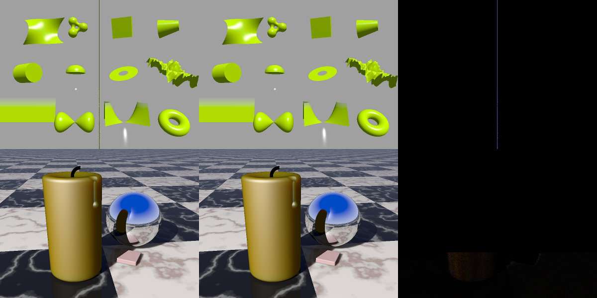

Sturm / polysove() investigation. Coefficients wrongly seen as zeroes.
In this chapter we venture up into the Solve_Polynomial() function which
calls polysove(), solve_quadratic(), solve_cubic() and solve_quartic().
Consider this code added back in 1994 and part of POV-Ray v3.0.
      * Determine the "real" order of the polynomial, i.e.
      * eliminate small leading coefficients.
     i = 0;
     while ((i < n) && (fabs(c0[i]) < SMALL_ENOUGH))
         i++;
     n -= i;
     c = &c0[i];
My last commit deletes it! Having so large a SMALL_ENOUGH (1e-10) and
any fixed value given equation order varies as does distance along the
ray where the equations not normalized is a bad idea(1).
Perhaps reason enough that when any even order polynomial with no roots
is reduced to an odd order polynomial it turns into a polynomial with
roots. All odd order polynomials have at least one root.
In the attached image we have two examples - neither using sturm /
polysolve - where the code above goes bad.
In the top row we've got the shipped primativ.pov scene and specifically
a poly shape which is not explicitly bounded. It creates 4th order
equations so should use solve_quartic(). However the code up top
sometimes strips the leading coefficient and in this case we go from a
quartic which has no roots to an odd third order cubic which has one.
This is the vertical bar artifact in the upper left.
In the bottom row we have the shipped subsurface.pov scene. The
differences on the bottom right (at 4x actual difference values) happen
again where the code at top drops a single leading coefficient. In this
case for pixels and rays where I've examine actual roots, subsurface
related rays go from 4th order equations with >=2 roots with one of
those roots inside the blob interval being kept, to a 3rd order equation
with a single root outside the active blob interval. In other words we
are missing subsurface roots/intersections where we see differences.
Notes:
- The subsurface effect here is visible with no difference multiplier
and many times larger than the returned root threshold differences
recently discussed.
- Because the ray-surface equations are based upon scene geometry the
'zeroes-not-zeroes-dropped' issue here is often scene-object or axis
aligned in some fashion. I'm reminded of a rounded box canyon subsurface
scene Robert McGregor posted where I noticed one box face having a
strange look. Someone joked it was perhaps a door to Narnia or similar
after nobody had an idea what caused the effect. I'm thinking perhaps
the code above - or the still present order reduction by ratio code -
played a part...
NOTE! This update corrupts some previous scenes while fixing some
previous bad ones. Some planned but not yet defined or implemented
equation tuning on ray DX,DY,DZ values is to come.
Updates at:
Bill P.
(1) - Yes, this strongly suggests order reduction based upon the largest
two coefficients is also a bad idea. However leaving that feature in
place for now as some primitives require this type of reduction to
function at all. Perhaps in these cases push the reductions out of the
solvers and into the shape code.

Gail Shaw's blob scene from 2005 to demonstrate, the attached image was
rendered with the current 3.8 master branch without sturm - so using
solve_quartic(). The original scene render is on the left. On the right
is the same scene scaled up by 10000. The vertical bars showing up on
the right happen due slightly ~=0.0 roots drifting positive in
solve_quartic(). The wrongly positive roots are then scaled up to a
value greater than the current 1e-2 small root/intersection depth
filter. Not being filtered, the roots corrupt results.
While zero crossing roots due tolerance are the most serious tolerance
multiplied by scale issue, roots well positive can drift quite a lot too
in the global space where the scale up is large.
The improvement adopted for the solve_quartic() and polysolve()/sturm
solvers - where 'scaled tolerance' issues have been seen - was to add a
Newton-Raphson root polishing step to each. With blobs this looks to
allow a returned depth on the order of 4e-8 over 1e-2 for a 1e-7 to 1e7
global working range at DBL = 'double'.
Aside for thought: Might we be able to determine when we are evaluating
a self-shadowing or same-shape-terminating ray-surface equation? If so,
it should be we can use the knowledge we have a root 'at 0.0' to always
deflate / reduce the order of these polynomials prior to finding roots.
Updates at:
Bill P.
(1) - The idea of going as small as >0.0 in each shape's implementation
fly is not presently possible. Trying instead a new much smaller
MIN_ISECT_DEPTH_RETURNED value - see commit comments.
Performance info:
19) 4e16623   14.94user 0.01system 0:15.56elapsed   -50.56%
20) 0d66160   15.22user 0.03system 0:15.80elapsed    +1.87%
               (hilbert_curve linear sphere_sweep
                scene with new solve_quadratic())     (-7.5%)
21) 761dd0b   15.05user 0.04system 0:15.71elapsed    -1.12%
22) 552b625   (quartic polish non-sturm lemon scene) (+0.82%)
23) 63e0456   15.16user 0.02system 0:15.76elapsed    +1.20%
24) ec28851   NA Code documentation only.
25) 8962513   15.43user 0.02system 0:16.05elapsed    +1.78%  -48.94%
               (quartic polish non-sturm lemon scene) (+1.02% +2.70%)
19) Removing leading, near zero coefficient reduction in Solve_Polynomial().
Leading coefficients of < SMALL_ENOUGH (1e-10) were being dropped
reducing the order of the incoming polynomial when the near zero values
had meaning with respect to roots. Led to both false roots and missed roots.
20) New zero coefficient stripping and solve_quadratic implementation.
General effort to implement better 'effective zero' coefficient
handling. Created new POV_DBL_EPSILON macro value which is 2x the C++
standards <float type>_EPSILON value and updated PRECISE_EPSILON to be
2x the single bit epsilon as well.
Zero filtering in polysolve now looks at all polynomial coefficients and
either sets 'effective zeros' to exactly 0.0 or strips them if they are
The much more accurate near zero coefficients drove the need for a
better solve_quadratic implementation included with this commit. Note it
supports the PRECISE_FLOAT options like polysolve.
Zero filtering in solve_quadratic, solve_cubic and solve_quartic now
standardized both in implementation and use of POV_DBL_EPSILON.
21) Created new constexpr DBL variable MIN_ISECT_DEPTH_RETURNED.
Near term need to use a value not MIN_ISECT_DEPTH in blob.cpp to test
Jérôme's github pull request #358. Longer term aim is to drive all
returned intersection depths from shape code to
MIN_ISECT_DEPTH_RETURNED. The value is automatically derived from DBL
setting and at double resolves to about 4.44089e-08. On the order of the
square root of POV_DBL_EPSILON.
Moving blob.cpp's inside test value INSIDE_TOLERANCE to POV_DBL_EPSILON
over previous recent re-calculation. Over time plan is to move EPSILONs
best nearer a double's step to POV_DBL_EPSILON.
Cleaning up doxygen documentation added during recent solver related
updates.
22) Adding root polishing step to solve_quartic function.
Newton-Raphson step added to polish initial roots found by the
solve_quartic function. The core solve_quartic tolerance allows roots to
drift from <=0.0 to >0.0 values with the latter causing artifacts and
additional root filtering. This the reason for the long too large 1e-2
intersection depth value in blob.cpp now reduced to
As part of this change created a new FUDGE_FACTOR4(1e-8) constant DBL
value to replace previous use of SMALL_ENOUGH(1e-10) within
solve_quartic. Looks like the value had been smaller to make roots more
accurate, but at the cost of missing roots in some difficult equation
cases. With the root polishing can move back to a larger value so as to
always get roots. Yes, this better addresses most of what the already
remove difficult_coeffs() function and bump into polysolve was trying to do.
23) Adding root polishing step to polysolve function.
24) Cleaning up a few comments and doxygen documentation.
25) Moving to more conservative root polishing implementations.
Download 'tolerancestory.png' (97 KB)

Yesterday, Johannes (j13r) posted in newusers a scene where he was
trying to create a scene using torus shapes and media to create
something like solar flares on the surface of a disk. A slightly
modified version without lights makes for a pretty good poster for
current media issues compared to my current working branch with better
solvers/shape code, my current version of the change proposed in:
https://github.com/POV-Ray/povray/pull/358 and the internal small
tolerance at 1e-6 instead of 1e-3.
The current v3.8 on the left, my patched branch in the middle and the
differences (artifacts) shown on the right. The scene was modified for
no lights and run with the flags: +w600 +h300 Corona.pov -j +p +a in
both cases.

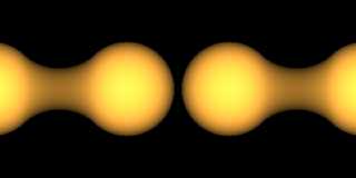

The two attached images shows a kind of media scaling set I've generally
adopted as it seems to be a pretty good way to test the numerical
soundness of a shape's code - especially the secondary rays. One image
is blobs for sturms the other for the updated solve_quartic code. Middle
row being the updated and essentially speckle-less new result. Seventh
column over is the 1x scene. Scales from the left at 1e6x to the right
at 1e-7x.
