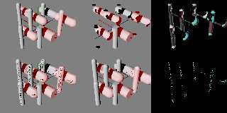

In continuing to look at media I returned to a 'blob-media' issue Gail
Shaw originally posted back in 2005. The bright spots at the very edge
are indeed caused by the 'intersection depth < small_tolerance' or
missed intersection issue as Slime guessed at the time.
However, the sturm result Gail showed never made any sense unless sturm
is broken for blobs. Gail's original belief something changed 3.5 to 3.6
was correct. Optimizations were done involving bounding and polynomial
reformulation for 3.6 which occasionally inhibit 4th to 3rd order
reduction(1). The bright spots not on the edge happen where
Solve_Polynomial passes the original 4th order blob equation to
polysolve and we get bad roots back.
(1) - Happens mostly with transparency.
In the lower left in the attached image I hacked the code to prevent
order reduction with blobs. Surprised to find it looks like blobs only
work as formulated due order reduction - even in v3.5.
All got me digging again into the solver code. Since v1.0 there has been
a regula_falsa function called once the rule of signs stuff has
determined a sub-interval contains a single root. The regula_falsa is
buggy once polynomial order is >= 4 given how many of our polynomials
are formulated - the evaluated values can be very small.
I've coded up a branch modifying the regula_falsa function so it sanity
checks the root found is a real root - within some tolerance - otherwise
it invalidates the root and tosses control back to the interval
bisection code.
Branch fixes this blob issue, the lathe issue #335 from last fall and
many remaining #147 (sphere_sweep) solver issues - except one b_spline /
orthogonal camera case. The patch also fixes or makes better many of the
accuracy issues I have in hand, however, I have too still some scenes
with 'accuracy' issues to dig through. The work is tedious and I need a
break - so putting out the fix I have.
A branch of master with the code update is available at:
https://github.com/wfpokorny/povray/tree/fix/polynomialsolverAccuracy
for those compiling their own POV-Ray versions. I plan to create a pull
request once I've looked at some of the remaining accuracy issues.
Aside: The regula_falsa function isn't strictly needed for root finding,
but the solver runs faster with it than not.
Bill P.

To better demonstrate attaching two images. In both the left column is
what the current master renders. The remaining columns to the right are
rendered with a float128 version of polysolve to better drive home the
point it our primary need isn't better overall accuracy, but more
accurate root isolation.
In the latheQuadratic.png image the top row is the point set from last
falls lathe issue used in a quadratic spline. The top row is a
perspective camera but zoomed way out and using a camera angle of 2. The
bottom row is the same input except with an orthographic camera set
up(1). In the middle column is what the current patched branch renders
using the SMALL_ENOUGH 1e-10 value. The value has been set so as to
behave well for the orthographic case, but this causes issues for the
perspective case. In the right column SMALL_ENOUGH has been set to
float128's minimum value of 1e-33. This orthographic case falls apart
showing the underlying ill-formed for sign change isolation problem -
while the perspective camera case is OK.
In the sphere_sweeps.png image showing the same progression(2) in
columns 1-3 but in column 4 we dial in a higher SMALL_ENOUGH value which
prunes off just the right about of the sturm chain for the root
isolation to work well.
I'm busy with real life for a while starting later today, but I think we
likely have a path to cleaner renders in these fringe cases given our
sturm chain based method.
We're working in a ray tracer and it is the ray's dx,dy,dz going to zero
which primarily causes the ill-formed for sign base root isolation
issue. We'll need to detect problem directions in the object's code and
create some calculation(3) which we'd pass all the way into the modp()
pruning. Possible I think.
Bill P.
(1) - It's not just the orthographic camera which tends to pull out the
worst case solver issues. Shadow rays with cylindrical and parallel
lights too. There are too the occasional rays which line up orthogonally
in one or compound dimensions.
(2) - Except running with jitter off. Our AA implementations are grid
based which unfortunately tends to line up with the compound (diagonal
type) missing root issues. Thinking something like a Halton sequence
based AA never keeping the center pixel might really help in these cases
by getting the samples more often off the problem ray / surface
grid-axis alignments.
(3) - Perhaps coupled with some ability for users to apply a multiplier
from the SDL?
Download 'lathequadratic.png' (17 KB) Download 'sphere_sweeps.png' (63 KB)
Preview of image 'lathequadratic.png'
Preview of image 'sphere_sweeps.png'

The attached image is a scene originally created to explore default
texturing related to negative blobs, but it demonstrates nicely the
issues described above.
In the top row we have on the left the image rendered with the blob
accuracy unmodified and all the difficult_coeffs() code running as it
does today. In the middle image the 'if difficult_coeffs()' test has
been hard coded to return no roots. On the right the difference image
shows all the rays running in the sturm / polysolve method which all run
fine - and faster given the blob set up - with solve_quartic().
In the second row we are running with the new more accurate blob.cpp.
Further, the blobs in the scene have been changed to have a threshold of
0.001 instead of 0.1 - values this low are not common because you don't
get much blobbing.
The first column of the second row was rendered with a version of
POV-Ray compiled to always force the use of solve_quartic(). The middle
column restores the 'if difficult_coeffs()' test and internal swap to
sturm / polysolve. It does help as shown in column 3. However column 2
shows the already too aggressive use of sturm / polysolve with blobs is
not enough to automatically 'fix' all the solve_quartic issues. Running
with sturm is clean in all cases.
Aside: The potentials as glows image I did sometime back had what I
thought were media related speckles. I applied very aggressive and
expensive AA to hide them as I usually do with media. Turns out using
sturm would have been the better choice. I wanted no blobbing for the
blob cylinders and used a threshold of 1e-5. It was a case of outrunning
the effectiveness of the 'if difficult_coeffs() patch' with existing
blob accuracy, but I didn't realize it at the time.

On 05/18/2018 01:00 PM, William F Pokorny wrote:
> On 03/30/2018 08:21 AM, William F Pokorny wrote:
> Sturm / polysove() investigation. Those Difficult Coefficients.
I'll add quickly this set of updates fixes the remaining media speckles
for the scene which started this thread - see attached image. The
general media speckling issue is better with more accurate roots, but
not completely fixed.
Bill P.

The top row in the attached image is without sturm the bottom with. The
differences are very subtle, but can be seen after being multiplied by 50.
The left column is less my recent changes so min_dist and the return
depth >0.0 with sturm automatically getting used often in the upper left
image.
The middle column is the updated code so the middle top now using
strictly solve_quartic() making the differences on the right are
greater. The bottom, sturm always row best shows the effect of not
returning roots <= 1e-4 from the ray origin.
My position is still the difference isn't large enough to be of concern,
but if so, maybe we should more strongly consider going to >0.0 or some
very small values for all shapes. Doing it only in blob.cpp doesn't make
sense to me.
Aside: MIN_ISECT_DEPTH doesn't exist before 3.7. Is it's creation
related to the SSLT implementation?
Bill P.

From: clipka
Subject: Re: Old media blob issue leading to a look at sturm / polysolve.
Date: 20 May 2018 17:09:35
Message: <5b01e40f$1@news.povray.org>
Am 20.05.2018 um 18:10 schrieb William F Pokorny:
> sense to me.
I guess the reason I changed it only for blobs was because there I
identified it as a problem - and I might not have been familiar enough
with the shapes stuff to know that the other shapes have a similar
mechanism.
After all, why would one expect such a mechanism if there's the "global"
MIN_ISECT_DEPTH?
Technically, I'm pretty sure the mechanism should be disabled for SSLT
rays in all shapes.
No, it was already there before I joined the team. The only relation to
SSLT is that it gets in the way there.
My best guess would be that someone tried to pull the DEPTH_TOLERANCE
mechanism out of all the shapes, and stopped with the work half-finished.
BTW, one thing that has been bugging me all along about the
DEPTH_TOLERANCE and MIN_ISECT_DEPTH mechanisms (and other near-zero
tests in POV-Ray) is that they're using absolute values, rather than
adapting to the overall scale of stuff. That should be possible, right?
From: William F Pokorny
Date: 21 May 2018 10:39:20
Message: <5b02da18$1@news.povray.org>
>> sense to me.
> mechanism.
> MIN_ISECT_DEPTH?
Understand. Only recently are the root filtering and bounding mechanisms
coming into some focus for me & I'm certain I still don't understand it
all. There are too, the two, higher level bounding mechanism which are
tangled in the root/intersection handling. I'm starting to get the
brain-itch the current bounding is not always optimal for 'root finding.'
> rays in all shapes.
OK. Agree from what I see. Work toward >0.0 I guess - though I have this
feeling there is likely an effective good performance 'limit' ahead of
 >0.0.
Sure, but... Not presently in POV-Ray is my 'anytime soon' answer. Too
many magic values or defined values like EPSILON used for differing -or
effectively differing - purposes. Remember, for example, one of the
recent changes I made to the regula-falsi method used within polysolve()
was to use universally the ray value domain instead of a mix of
polynomial values and ray values for relative & absolute error stops.
Root / intersection work is sometimes done in a normalized space(1) and
sometimes not, etc. The pool of issues, questions and possibilities in
which I'm mentally drowning is already deep - and I'm far from seeing to
the bottom. We can often scale scenes up for better result because
POV-Ray code has long been numerically biased to 0+ (1e-3 to 1e7) (2).
Near term think we should work toward something zero centered (1e-7 to
1e7).
Would like to first get to where we've got a more accurate polysolve()
against which any changes to other solvers / specialized shape solvers
can be tested. After which we can perhaps work to get all the solvers &
solver variant code buried in shape code to double / 'DBL' accuracy.
Underneath everything solver / intersection wise is double accuracy
which is only 15 decimal digits. The best double value step
(DBL_EPSILON) off 1.0 is 2.22045e-16. Plus we use fastmath which
degrades that accuracy.
Aside: I coded up a 128bit polysolve() but it was very slow (+10x) and
the compiler feature doesn't look to be supported broadly enough as a
standard to be part of POV-Ray. A near term interesting idea to me - one
Dick Balaska, I think, touched upon recently in another thread -  is
coding up a version of polysolve() we'd ship using 'long double'. Long
double is guaranteed at only 64bits (double), but in practice today
folks would mostly get 80bits over 64bits - and sometimes more. It would
need to be an option to the default 64 bit double as it would certainly
be slower - but being generally hardware backed, performance should be
<< the +10x degrade I see for 128bits on my Intel processor. Would be -
for most - an improvement to 18 decimal digits and an epsilon step of
1.0842e-19 off 1.0. Worthwhile...?
Bill P.
(1) Normalizing & the inverse, transforms & the inverse all degrade
accuracy too.
(2) From the days of single floats - where the scale up would have
worked less well at hiding numerical issues (ie coincident surface
noise) because the non-normalized / global accuracy was then something
like 6 decimal digits or 1e-3 to + 1e3.
Sturm / polysove() investigation. Coefficients wrongly seen as zeroes.
In this chapter we venture up into the Solve_Polynomial() function which
calls polysove(), solve_quadratic(), solve_cubic() and solve_quartic().
Consider this code added back in 1994 and part of POV-Ray v3.0.
      * Determine the "real" order of the polynomial, i.e.
      * eliminate small leading coefficients.
     i = 0;
     while ((i < n) && (fabs(c0[i]) < SMALL_ENOUGH))
         i++;
     n -= i;
     c = &c0[i];
My last commit deletes it! Having so large a SMALL_ENOUGH (1e-10) and
any fixed value given equation order varies as does distance along the
ray where the equations not normalized is a bad idea(1).
Perhaps reason enough that when any even order polynomial with no roots
is reduced to an odd order polynomial it turns into a polynomial with
roots. All odd order polynomials have at least one root.
In the attached image we have two examples - neither using sturm /
polysolve - where the code above goes bad.
In the top row we've got the shipped primativ.pov scene and specifically
a poly shape which is not explicitly bounded. It creates 4th order
equations so should use solve_quartic(). However the code up top
sometimes strips the leading coefficient and in this case we go from a
quartic which has no roots to an odd third order cubic which has one.
This is the vertical bar artifact in the upper left.
In the bottom row we have the shipped subsurface.pov scene. The
differences on the bottom right (at 4x actual difference values) happen
again where the code at top drops a single leading coefficient. In this
case for pixels and rays where I've examine actual roots, subsurface
related rays go from 4th order equations with >=2 roots with one of
those roots inside the blob interval being kept, to a 3rd order equation
with a single root outside the active blob interval. In other words we
are missing subsurface roots/intersections where we see differences.
Notes:
- The subsurface effect here is visible with no difference multiplier
and many times larger than the returned root threshold differences
recently discussed.
- Because the ray-surface equations are based upon scene geometry the
'zeroes-not-zeroes-dropped' issue here is often scene-object or axis
aligned in some fashion. I'm reminded of a rounded box canyon subsurface
scene Robert McGregor posted where I noticed one box face having a
strange look. Someone joked it was perhaps a door to Narnia or similar
after nobody had an idea what caused the effect. I'm thinking perhaps
the code above - or the still present order reduction by ratio code -
played a part...
NOTE! This update corrupts some previous scenes while fixing some
previous bad ones. Some planned but not yet defined or implemented
equation tuning on ray DX,DY,DZ values is to come.
Updates at:
Performance and specific commit details below.
Bill P.
(1) - Yes, this strongly suggests order reduction based upon the largest
two coefficients is also a bad idea. However leaving that feature in
place for now as some primitives require this type of reduction to
function at all. Perhaps in these cases push the reductions out of the
solvers and into the shape code.
Performance info:
------------ /usr/bin/time povray -j -wt1 -fn -p -d -c lemonSturm.pov
0)  master    30.22user 0.04system 0:30.89elapsed
16) 21387e2   14.88user 0.02system 0:15.51elapsed    -50.76%
17) 80860cd   --- NA --- (1e-15 constant calc fix)
(PRECISE_FLOAT)
18) aa6a0a6   --- Bad Result(a) ---                           (float)
               14.95user 0.02system 0:15.56elapsed     +0.47%  (double)
               25.12user 0.02system 0:25.73elapsed    +68.82%  (long double)
               282.97user 0.13system 4:44.13elapsed +1801.68%  (__float128)
19) 4e16623   14.94user 0.01system 0:15.56elapsed      ----   -50.56%
(a) - Not exhaustively evaluated, but some shapes render OK at 'float'
though those which did were slower (+150% ballpark). Unsure why so slow,
but don't plan to dig further. Sturm / polysolve is for those looking to
be more accurate, not less.
17) Correcting two double 1e-15 constant calculations.
In recent commits started setting two 1e-15 values with the calculation:
= 1/std::numeric_limits<DBL>::digits10;
when I meant to code:
= 1/pow(10,std::numeric_limits<DBL>::digits10);
Both forms bad practice in not being specific as to the types for the
explicit values. The first returns integer 0, later cast to double and I
got away with it in all but my full set of test cases. Corrected:
= (DBL)1.0/pow((DBL)10.0,std::numeric_limits<DBL>::digits10);
18) Implementing suggested PRECISE_FLOAT macro mechanism for polysolve().
Primarily enabling 'long double' support for the polysolve() / 'sturm'
solver given 'long double' is part of the C+11 standard and gets most
users 80 bits or more as opposed to 64. Further, the additional bits are
almost always hardware backed making for reasonable performance.
With GNU g++ 64 bit environments '__float128' is a valid setting with no
additional library required - though it's very slow. Other extended
accuracy floats such as 'double double' enabled, via the PRECISE_
mechanisms, but they involve additional libraries and settings. See code.
Note! With this update the polysolve sturm chain is no longer pruned
with a default 1e-10 value, but rather a value appropriate for the
floating point type. Means better accuracy for some previously bad root
results and less accuracy for others. Coming updates will better tune
the chain equation pruning.
19) Removing leading, near zero coefficient reduction in Solve_Polynomial().
Leading coefficients of < SMALL_ENOUGH (1e-10) were being dropped
reducing the order of the incoming polynomial when the near zero values
had meaning with respect to roots. Led to both false roots and missed roots.
Download 'notzeroesdropped.png' (326 KB)

Gail Shaw's blob scene from 2005 to demonstrate, the attached image was
rendered with the current 3.8 master branch without sturm - so using
solve_quartic(). The original scene render is on the left. On the right
is the same scene scaled up by 10000. The vertical bars showing up on
the right happen due slightly ~=0.0 roots drifting positive in
solve_quartic(). The wrongly positive roots are then scaled up to a
value greater than the current 1e-2 small root/intersection depth
filter. Not being filtered, the roots corrupt results.
While zero crossing roots due tolerance are the most serious tolerance
multiplied by scale issue, roots well positive can drift quite a lot too
in the global space where the scale up is large.
The improvement adopted for the solve_quartic() and polysolve()/sturm
solvers - where 'scaled tolerance' issues have been seen - was to add a
Newton-Raphson root polishing step to each. With blobs this looks to
allow a returned depth on the order of 4e-8 over 1e-2 for a 1e-7 to 1e7
global working range at DBL = 'double'.
Aside for thought: Might we be able to determine when we are evaluating
a self-shadowing or same-shape-terminating ray-surface equation? If so,
it should be we can use the knowledge we have a root 'at 0.0' to always
deflate / reduce the order of these polynomials prior to finding roots.
Updates at:
Bill P.
(1) - The idea of going as small as >0.0 in each shape's implementation
fly is not presently possible. Trying instead a new much smaller
MIN_ISECT_DEPTH_RETURNED value - see commit comments.
Performance info:
19) 4e16623   14.94user 0.01system 0:15.56elapsed   -50.56%
20) 0d66160   15.22user 0.03system 0:15.80elapsed    +1.87%
               (hilbert_curve linear sphere_sweep
                scene with new solve_quadratic())     (-7.5%)
21) 761dd0b   15.05user 0.04system 0:15.71elapsed    -1.12%
22) 552b625   (quartic polish non-sturm lemon scene) (+0.82%)
23) 63e0456   15.16user 0.02system 0:15.76elapsed    +1.20%
24) ec28851   NA Code documentation only.
25) 8962513   15.43user 0.02system 0:16.05elapsed    +1.78%  -48.94%
               (quartic polish non-sturm lemon scene) (+1.02% +2.70%)
20) New zero coefficient stripping and solve_quadratic implementation.
General effort to implement better 'effective zero' coefficient
handling. Created new POV_DBL_EPSILON macro value which is 2x the C++
standards <float type>_EPSILON value and updated PRECISE_EPSILON to be
2x the single bit epsilon as well.
Zero filtering in polysolve now looks at all polynomial coefficients and
either sets 'effective zeros' to exactly 0.0 or strips them if they are
The much more accurate near zero coefficients drove the need for a
better solve_quadratic implementation included with this commit. Note it
supports the PRECISE_FLOAT options like polysolve.
Zero filtering in solve_quadratic, solve_cubic and solve_quartic now
standardized both in implementation and use of POV_DBL_EPSILON.
21) Created new constexpr DBL variable MIN_ISECT_DEPTH_RETURNED.
Near term need to use a value not MIN_ISECT_DEPTH in blob.cpp to test
Jérôme's github pull request #358. Longer term aim is to drive all
returned intersection depths from shape code to
MIN_ISECT_DEPTH_RETURNED. The value is automatically derived from DBL
setting and at double resolves to about 4.44089e-08. On the order of the
square root of POV_DBL_EPSILON.
Moving blob.cpp's inside test value INSIDE_TOLERANCE to POV_DBL_EPSILON
over previous recent re-calculation. Over time plan is to move EPSILONs
best nearer a double's step to POV_DBL_EPSILON.
Cleaning up doxygen documentation added during recent solver related
updates.
22) Adding root polishing step to solve_quartic function.
Newton-Raphson step added to polish initial roots found by the
solve_quartic function. The core solve_quartic tolerance allows roots to
drift from <=0.0 to >0.0 values with the latter causing artifacts and
additional root filtering. This the reason for the long too large 1e-2
intersection depth value in blob.cpp now reduced to
As part of this change created a new FUDGE_FACTOR4(1e-8) constant DBL
value to replace previous use of SMALL_ENOUGH(1e-10) within
solve_quartic. Looks like the value had been smaller to make roots more
accurate, but at the cost of missing roots in some difficult equation
cases. With the root polishing can move back to a larger value so as to
always get roots. Yes, this better addresses most of what the already
remove difficult_coeffs() function and bump into polysolve was trying to do.
23) Adding root polishing step to polysolve function.
24) Cleaning up a few comments and doxygen documentation.
25) Moving to more conservative root polishing implementations.
Download 'tolerancestory.png' (97 KB)

Generally sturm option now much faster. Also true due improvements to
the fixed solvers that the sturm option is less often necessary.
The sphere_sweep now supports a sturm option. Here sturm runs the
sturmian solver in a two pass approach which, for certain scenes, will
work where the previous single pass sturmian solver did not. Unlike
other updated shapes, the sphere_sweeps scaling accuracy range was not
much improved due a decision to leave other parse time optimizations for
run time performance in place.
27) My implementation of Jerome's pull request #358.
Fix for issues #121, #125 and several related newsgroup reports as well.
Mostly it restores 3.6 behavior with respect to intersection depths
filtered.
Note! Scenes using photons will often run slower and look somewhat
different due additional photons being deposited. This includes our
benchmark scene.
28) Shadow cache fixes. SHADOW_TOLERANCE vs SMALL_TOLERANCE cleanup.
SHADOW_TOLERANCE not used for cached results leading to artifacts though
sometimes hiding others.
Shadow cache not invalidated on misses causing sometimes significant
performance hit.
SMALL_TOLERANCE being used instead of SHADOW_TOLERANCE in some trace
shadow related comparisons. Values had long (25+ years) been cleaned up
ahead of SMALL_TOLERANCE removal.
Note! This the last commit where SMALL_TOLERANCE will exists.
29) Mostly details completing the previous two commits.
Eliminating SMALL_TOLERANCE in addition to MIN_ISECT_DIST. This partly
follows up on a question Jerome asked either in #358 or some related
issue. Namely, why not zero or near it for the Intersect_BBox_Dir calls
in object.cpp. Larger values do indeed cause artifacts with secondary
rays as especially noticeable in scenes with media. It's one of many
causes for media speckles. Pull #358 as originally submitted moved from
a MIN_ISECT_DIST value of 1e-4 to SMALL_TOLERANCE of 1e-3 making the
inherent problem worse. SMALL_TOLERANCE had also been adopted a few
other places in the code. In those cases moved to gkDBL_epsilon or
gkMinIsectDepthReturned as appropriate.
30) In cone.cpp changing Cone_Tolerance to gkMinIsectDepthReturned.
During testing found the Cone_Tolerance in cone.cpp, which had been
changed from 1e-6 to 1e-9 v3.6 to v3.7, was too small for some photon
scenes. Secondary rays starting on the surface (at zero but numerically
not) were not getting filtered with the pull request 358 like changes
(MIN_ISECT_DIST to 0.0). Moved to new gkMinIsectDepthReturned (4.4e-8)
used now in many other shapes and OK for test scenes I have.
Download 'blobsturmstory.png' (78 KB) Download 'blobnosturmstory.png' (74 KB)
