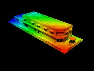

So, I am using this macro to generate chromadepth textures:
// this script assumes the depth effect is *linear* from near to far,
// which may not be the case
// red, white, blue
#macro MakeChromadepthTextureCameraRWB(CameraLocation, CameraLookAt)
	#local iMax = 240;
	pigment
		spherical
		color_map
			[0.0 color srgb <0,0,1>]
			[0.5 color srgb <1,1,1>]
			[1.0 color srgb <1,0,0>]
//	finish
//		ambient 1
//		diffuse 0
	scale vlength(CameraLocation - CameraLookAt) * 2
	translate CameraLocation
#end
The texture is centered on the camera location, and stretches to a point
opposite the model. The problem is that the model ends up mostly white,
with only touches of blue and red, as you can see in the attached image.
I think the texture should hug the model a bit closer, so that more red
and blue are visible. The problem is that the texture is centered on the
camera instead of the model, or I could just scale the texture a bit
smaller.
What method can I use to fix the texture? I know what the model's center
point and bounding box are.
Thanks.
Mike
Download 'wrapper_showcase.jpg' (225 KB)
Preview of image 'wrapper_showcase.jpg'

From: Mike Horvath
Subject: Re: Chromadepth scaling to model
Date: 17 Feb 2018 15:24:28
Message: <5a888f7c$1@news.povray.org>
I ended up using this:
// This script assumes the depth effect is *linear* from near to far,
which may not be the case.
// red, white, blue
#macro MakeChromadepthTextureCameraRWB(CameraLocation, CameraLookAt,
FudgePercent)
	#local FudgeMin = FudgePercent/100/2;
	#local FudgeMax = 1 - FudgePercent/100/2;
	pigment
		spherical
		color_map
			[FudgeMin	color srgb <0,0,1>]
			[FudgeMax	color srgb <1,0,0>]
//	finish
//		ambient 1
//		diffuse 0
#end
I can shrink and grow the texture using the FudgePercent parameter. I
think this is as close as I'll get.
Mike

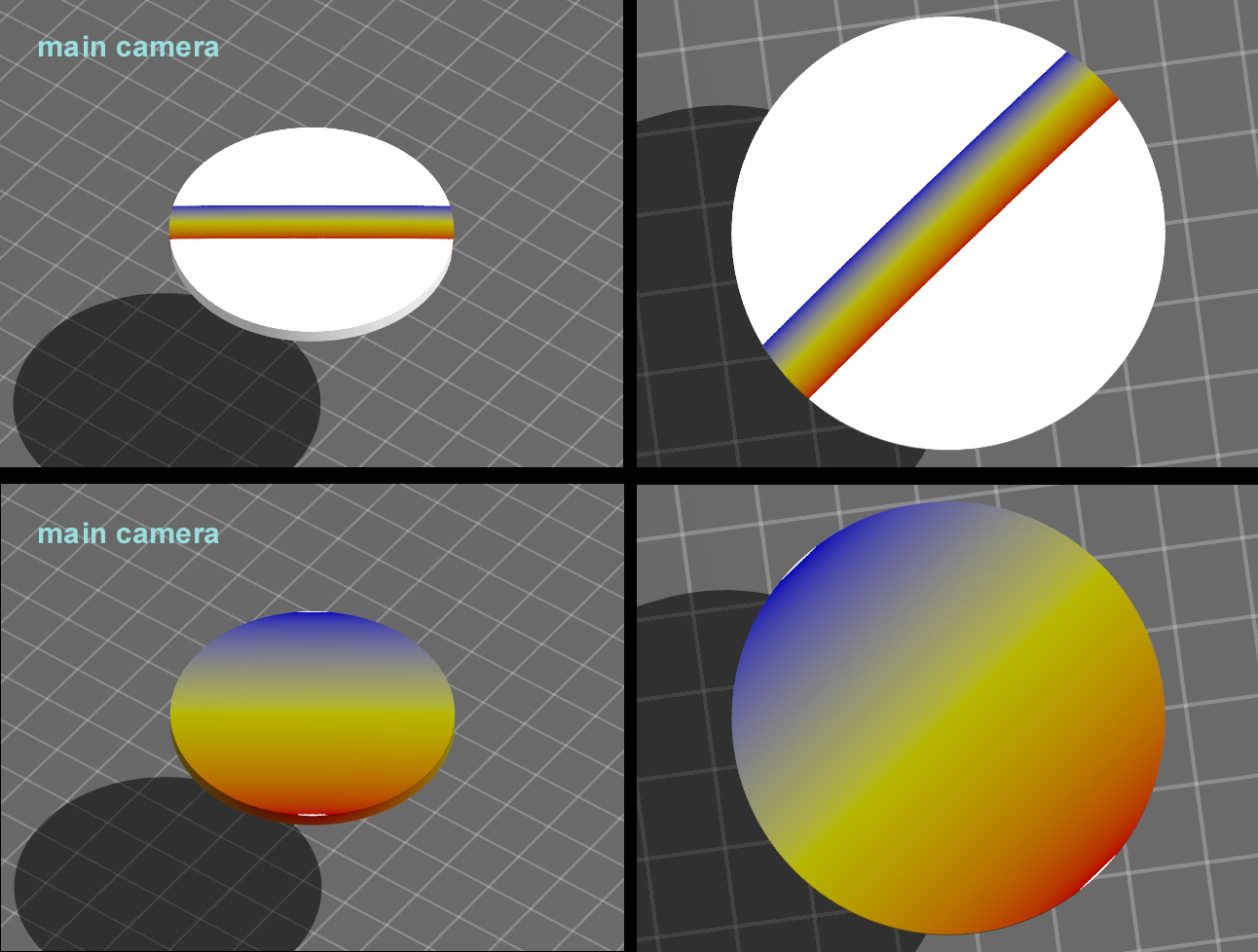

From: Kenneth
Date: 19 Feb 2018 11:15:00
Message: <web.5a8af675b61f5657a47873e10@news.povray.org>
So, I finally coded-up my idea, and it does indeed put the 'center' color of the
color_map across the center of the object. That part works, at least. But the
color pattern's 'limits' on the object have a problem: the color spread doesn't
extend all the way across. So far, after several days of trying to figure out
why, I still don't have a clue. I tried changing *every* parameter in the code,
but no luck-- although there's probably a hidden 'clue' in those trials.
So, I had to resort to some fudge-factors as well :-/  I eventually found one
set of those that actually works consistently... so the overall scheme is
workable after all. Only two 'fudging' values need changing, by eye; they depend
on relative distance between object and camera, and on the scale of the object.
I don't know if those values change linearly, exponentially, or what.
Essentially, they increase the distance between the object's found  bounding-box
coordinates, *as if* the object is larger. A clue?
The first image is the result of the initial code idea; the second is with the
fix. The fudge factors indicate that the 'squashed' color_map values depend on
some kind of so-far-unknown variable. There HAS to be an answer; I just haven't
found it yet :-(
The camera and object positions are arbitrary, as is object scale, and can be
anything... within reason ; there can be precision issues behind-the-scenes. See
the #debug messages.
#declare CAM_LOCATION = <32, 56, -35>*3; // easily change location using the
// (positive) multiplier (actually changes it between location <0,0,0> and
// farther out)
#declare OBJECT_CENTER_LOCATION = <3,6,22>*1.0; // ditto
#declare OBJECT_SCALE =  2.7;
#declare CAM_ANGLE = 3; // 0.9 Just to easily change the camera angle when
// you change object scale or camera/object distance.
// main camera
camera {
  perspective
  location  CAM_LOCATION
  look_at   OBJECT_CENTER_LOCATION
  right     x*image_width/image_height  // aspect
  angle CAM_ANGLE
// OR, separate camera, 'un-coupled' from code, looking from another location
// way above
camera {
  perspective
  location  <0,500,0>
  angle CAM_ANGLE
light_source {
  0*x
  color rgb .7
  translate <40, 80, 30>
background{rgb .1}
// stripes are 1-unit apart
plane{y,0
    pigment{
           average
           pigment_map{
                [ 1 gradient x
                 color_map{
                     [.05 rgb .8]
                     [.05 rgb .3]
                [ 1 gradient z
                 color_map{
                     [.05 rgb .8]
                     [.05 rgb .3]
           scale 1
#declare OBJECT_1 =  // does not need to be centered on origin when made
// box{0,<1,.1,1> scale OBJECT_SCALE
// rotate 40
// translate OBJECT_CENTER_LOCATION
// OR...
cylinder{-.05*y,.05*y 1
   scale OBJECT_SCALE
   translate OBJECT_CENTER_LOCATION  // yes, PRE-translated -- it's part
                                     // of the idea
#declare NEAR_CORNER = min_extent(OBJECT_1);
#declare FAR_CORNER = max_extent(OBJECT_1);
#declare L_1 = vlength(NEAR_CORNER - CAM_LOCATION) - 0;  // or - 1.68 FUDGE
// FACTOR
#declare L_2 = vlength(FAR_CORNER - CAM_LOCATION) + 0;  // or + 1.44 FUDGE
// FACTOR
#declare S = L_1/L_2;
#declare T = 1.0 - S;
#declare SPHERE_PIG =
pigment{
     spherical
     color_map{
          [0 rgb 3]
          [0 rgb <0,0,1>] // BLUE -- outside edge of pattern
          [0.5*T rgb <1,1,0>] // YELLOW
          [T rgb <1,0,0>] // RED
          [T rgb 3]
      // to experiment with...
      color_map{
          [0 rgb 3]
            [.48*T rgb <0,0,1>]
            [.48*T rgb <1,1,0>]
            [.52*T rgb <1,1,0>]
            [.52*T rgb <1,0,0>]
          [T rgb <1,0,0>]
          [T rgb 3]
      scale L_2
      translate CAM_LOCATION
object{OBJECT_1// already translated
     pigment{SPHERE_PIG} // ditto
#debug concat("\n", "object SCALE = ",str(OBJECT_SCALE,0,9),"\n")
#debug concat("\n", "distance to bounding box NEAR corner (L_1) =
",str(vlength(NEAR_CORNER - CAM_LOCATION) - 0,0,9),"\n")
#debug concat("\n", "distance to bounding box FAR corner (L_2) =
",str(vlength(FAR_CORNER - CAM_LOCATION) - 0,0,9),"\n")
#debug concat("\n", "L_1/L_2 = ",str(L_1/L_2,0,9),
"  (should never go over 1.0 !)","\n")
#debug concat("\n", "T = ",str(T,0,9),"\n")
Download 'chromadepth_example.jpg' (225 KB)
Preview of image 'chromadepth_example.jpg'
From: Mike Horvath
Date: 19 Feb 2018 19:19:08
Message: <5a8b697c$1@news.povray.org>
> found it yet :-(
Awesome! Let us know when you figure out why the fudge factor is needed.
If you flip over the disc you'll see that the second fudge factor is too
small. You need to set it to + 1.65 instead of + 1.44.
Mike
From: Kenneth
Date: 19 Feb 2018 20:35:01
Message: <web.5a8b7a9fb61f5657a47873e10@news.povray.org>
Thanks. Yeah, that doesn't surprise me at all! And in some of the tests I ran by
rotating the object, the L_1/L_2 equation-- the min_extent and max_extent --
actually exceeded 1.0. Meaning, the far bounding_box corner was being sensed as
closer to the camera than the near one(!) That made no sense, but it's
*probably* precision-errors, due to some of the values becoming really small
(when the camera/object distance is large.)
Currently, I can live with the fudge factors-- they're at least somewhat easy to
fiddle with, until I figure out what's happening-- but they make no sense. And
neither did any of the other fudgy things I tried. That kind of arbitrary stuff
really bugs me.
I'll hopefully awake one morning with an 'A-HA' epiphany, and it will all be
clear. But don't hold your breath :-P
I have a sneaking feeling that, with a *complex* object made of lots of parts,
its  bounding_box corner locations may throw off the 'centerline' location of
the color_map. Requiring more fudge factors, maybe... :-O

Well, I figured out what the problem is. I've posted an image of my latest
tests. (The white arrow illustrates the camera-to-object direction-- and shows
that the code itself is working; the color 'stripes' on the object are in the
correct orientation of the 'spherical' pattern, slicing through the object.) In
the images, I put small spheres at the min_extent and max_extent positions. The
blue box represnts the bounding-box shape that's found.
But POV-ray's automatic bounding boxes don't behave the way I thought :-(
I was assuming that a bounding box would 'hug' the object. As you can see in the
top images, it does. Nice and tight. But when an object is rotated, the bounding
box changes its size-- whereas I was expecting it to remain just like the top
images no matter what... like the object was 'wrapped' in the same-size box,
which would rotate with it. That was a major misconception on my part, and it
definitely affects my code idea. I have no idea how to compensate for that-- no
'fudge factor' that I can think of.
At first, I thought this was really screwy behavior; but I see now what is
actually happening. The bounding box shape is like an 'orthographic projection'
of the object boundaries-- AS IF PROJECTED FROM strictly the x/y/z planes.
That's the key. The camera or object location doesn't affect that
strictly-rectangular shape. (If I were to set up a camera looking exactly in x,
y, or z, I'm sure I would see only one face of the box.)
I now seem to remember newsgroup discussions in the past about this behavior,
but I had forgotten about it.
The images also show a sphere superimposed onto the cylinder object. Its radius
is 1/2 of the diagonal distance between min_extent and max_extent, and I
textured it with the same main color_map pigment, from the same translated
location as the main object's color_map. It may not be too clear here, but in my
animation tests it shows that the color_map's 'color limits' are also expanding
and contracting with the changing box shape, naturally enough. *That's* why my
code's fudge factors seemed arbitrary.
I'm still trying to determine why the bounding-box coordinates sometimes
'reverse' themselves. I think it's a combination of too-much-distance between
camera and object, and some precision errors. But that's worth finding out
about, if there's a distance limit to getting usable min_extent and max_extent
values, depending on the orientation of an object.
Download 'chromadepth_bounding_boxes.jpg' (224 KB)
Preview of image 'chromadepth_bounding_boxes.jpg'
From: Bald Eagle
Date: 20 Feb 2018 18:20:01
Message: <web.5a8cac28b61f56575cafe28e0@news.povray.org>
You take the vectors for the original bounding box and do the same vector
transform on them that you do for the object.  Then they define the corners of
the original bounding box, but in the new location / orientation.
If you'd like, for posterity, maybe take a long-ish cylinder, show a bounding
box (like a wire_box) and animate the cylinder being rotated, and how the BB
changes.
Then do the same with a "bounding box" using the transformed vectors as corners
- you'll have to build that wire box manually, or at least edit the code for it
in the include file so it takes 8 corners as arguments...

From: Kenneth
Date: 21 Feb 2018 09:05:00
Message: <web.5a8d7a35b61f5657a47873e10@news.povray.org>
> > Are you saying that it doesn't matter which corners I choose, as long as
> > the corners are opposite of each other? I don't quite understand.
> You need to choose the nearest and the farthest corners, to get the largest
> spread to scale your color map across.
If I understand what you're asking, the min_extent/max_extent features choose
those corners automatically for you. (Although, some of my tests indicate the
'reversal' of those, for some wacky reason.) But generally speaking, they work
quite well.
> Kenneth didn't realize that bounding boxes are _always_ cardinal-axis aligned.
.... un, yeah, except for that ;-)
But I'm seeing another oddity about the bounding box that I don't understand.
(See the image.) Of course, I made the box object myself, as a
(hopefully-accurate!) representation of the bounding-box volume-- and
orientation. But in renders looking exactly along the x/y/z axes, there is
clearly additional space between object and box-- when the box should exactly
delineate the boundaries of the object(?). Why that occurs when the object is
rotated is mysterious; it doesn't always happen. But it does make me suspicious,
that maybe just maybe the REAL bounding box may not actually be cardinal-axis
aligned?? Otherwise, where is the extra space coming from? Maybe it's just the
natural behavior of auto-bounding... ?
Download 'chromadepth_bounding_boxes_2.jpg' (123 KB)
Preview of image 'chromadepth_bounding_boxes_2.jpg'
From: Bald Eagle
Date: 21 Feb 2018 10:10:00
Message: <web.5a8d8bafb61f5657c437ac910@news.povray.org>
> quite well.
I'm not sure why that would be or if I'm following exactly what you're doing.
Your labels on the renders below seem to indicate that you're looking in
negative directions for whatever reason.  Are you sure that's not part of the
confusion?
And that white arrow is from the origin through the center of the object?
> orientation.
Are you just using something like box {min_extent(object{thing}),
max_extent(object{thing})...} ?
What IS that, and how is it made?   There might be some odd CSG thing going on.
Have you tried just a simple cylinder?
I also suggested you do exactly what you're doing and animate the rotation of
the object so you can see if that extra space is always there, or just with
certain odd orientations.
> aligned??
Well, they have to be, because you're just getting 2 corners out of min and max
extent, and if you box{} that...
vide supra

From: Kenneth
Date: 21 Feb 2018 12:25:06
Message: <web.5a8da679b61f5657a47873e10@news.povray.org>
> > choose those corners automatically for you. (Although, some of my tests
> > indicate the 'reversal' of those, for some wacky reason.) But generally
> > speaking, they work quite well.
> confusion?
The examples I've shown so far don't have that 'reversal' of the near-and-far
bounding-box points. I've only seen that behavior when the camera and object are
really far apart-- and I haven't gone back to test that yet. The orthographic
views I made were not rendered with the 'real' scene camera but with an extra
'uncoupled' camera, from a different viewpoint; so the -y vs. +y (etc) camera
orientations that I chose wouldn't matter.
Nope, it's from the *actual* scene-code camera position, through the object--
it's there just to prove to myself that my code is applying its chromadepth
spherical-pigment color_map correctly, and 'projected' /scaled in the correct
orientation between 'real' camera and the object.
> > understand. See the image.) Of course, I made the box object myself, as
> > a (hopefully-accurate!) representation of the bounding-box volume-- and
> > orientation.
Yep. I have to assume that it's representative of the object's REAL bounding
box.. barring any other unknown discoveries ;-) BTW, it's not part of the
scene's main operation and it's not CSG; it's just an extra object placed at the
same coordinates.
Funny thing: I actually did such an animation-- a series of them, in fact. Maybe
I'll post one. They definitely show the (my) translucent box
'squashing-and-stretching' as the inner object rotates.
> > But it does make me suspicious, that maybe just maybe the REAL bounding
> > box may not actually be cardinal-axis aligned??
> and max extent, and if you box{} that...
I thought so too-- but I've been playing around with some experiments, and it
does seem possible to create a (fake) bounding-box in a *different* / tilted
orientation, that still uses the same two corner positions.
I made an image of that (using my 'uncoupled' camera again.) This time, the
'real' camera and the object are father apart than in my previous images-- and
which now shows a squashed color_map (possibly from an erroneous bounding-box
and wrong corner points?) Anyway, this image shows-- I think-- that *a*
bounding-box could conceivably be generated that doesn't really align to the
cardinal axes.
Just a fun experiment, really, but it looks too interesting to ignore. BTW, I
didn't create those slicing planes arbitrarily; they actually delineate the
spherical color_map's (scaled-up) index values in my code-- 'T' and 0.0 there.
I.e., the slicing planes would be the 'spherically-curved surfaces' of those
color_map values as they intersect the object, if that makes any sense. And the
center of that spherical pattern is also where the 'real' camera is located...
which is quite interesting. Those slicing planes sure do look like what *could*
be a differently-oriented and incorrect bounding-box shape.
Download 'chromadepth_bb_experiment.jpg' (219 KB)
Preview of image 'chromadepth_bb_experiment.jpg'
From: Kenneth
Date: 21 Feb 2018 12:35:06
Message: <web.5a8dacf6b61f5657a47873e10@news.povray.org>
Oops, I just realized that my slicing planes (and the corner points) wouldn't
produce a nicely-square box, but a trapezoid/whatever. Oh well, it was fun to do
anyway. I really thought I was on to something important... :-O
From: Bald Eagle
Date: 21 Feb 2018 13:20:01
Message: <web.5a8db733b61f5657c437ac910@news.povray.org>
"parallelpiped"
https://en.wikipedia.org/wiki/Parallelepiped
http://mathworld.wolfram.com/Parallelepiped.html
I'll look over your preceding post when I get some more time - off to work I
go...
From: Kenneth
Date: 22 Feb 2018 09:20:00
Message: <web.5a8ecfc6b61f5657a47873e10@news.povray.org>
Well, I've found the root of the problems-- all having to do with the object's
bounding-box:
1) There IS a subtle flaw in my code. Right now, I can't describe it clearly in
words, or how to go about fixing it.
2) There's nothing wrong with POV-ray's bounding boxes or min_extent/max_extent
or vlength (except maybe the 'extra space' that's sometimes between object and
box boundaries, depending on the object's rotation. That's still a mystery.)
3) I had another misconception, about the meaning of a bounding-box's min_extent
and max_extent locations. They are *just* coordinates in space-- and the
location of any 'shoot-from' point to *find* those coordinates has an important
bearing on whether they are considered 'near' or 'far' (i.e., which is min and
which is max.) That was my mistaken notion of the points appearing to 'reverse.'
I'm making an animation to show both my current code flaw AND this min/max
relationship. It's very instructive ;-)  I'll post it.
Yes, I think I was [too briefly] trying to point toward that when I asked about
the [virtual/real] camera direction.
The bounding box coordinates are absolute coordinates referenced to the origin.
 10 > 0 > -10
Write out a formula using min() and max() to calculate the min_extent and
max_extent functions, and you'll _get it_.
From: Kenneth
Date: 23 Feb 2018 05:30:00
Message: <web.5a8fecdeb61f5657a47873e10@news.povray.org>
BTW: If it's not clear yet (because of my digressions about bounding-box stuff),
my code example works fine and dandy *if* CAM_LOCATION is at the origin,
<0,0,0>. (It puts both the 'MAIN camera' and its associated spherical pigment
there.) I haven't seen any problems when doing so.
