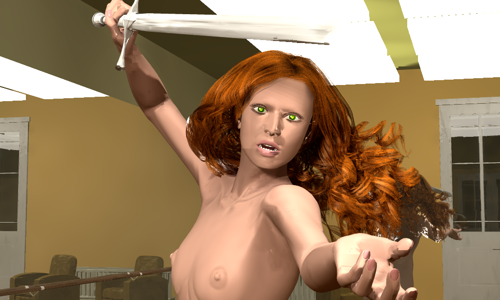

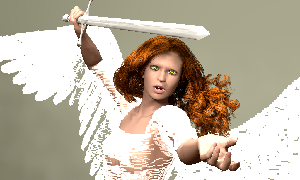

The tunic and wings are emissive df3s, made from Poser models.
I think I need a dragon and a rocky scene to complete this. :)
Yes indeed although I like this ballet school setting with the mirrors.
A couple of things, if I may: (1) the overhead lights should be dimmed -
probably by at least 50 % (if not 25%) also for compensating the light
reflections from the mirrors. (2) Could you merge this scene with your
ballerina animation? That was awesome.
It is old enough to have been made in Moray. :-)
The lighting is problematic. The light in the hall of mirrors brightens
when I switch on radiosity. I did not mean this to turn into an
experiment in radiosity but it looks looks like it is going to be. I
have a normal area light in there to even things out.
Hmm! has anyone told you that you have an evil mind, recently?
As if I haven't enough to do. ;-)
It is an interesting challenge though. First I have to find out why when
I create the df3s there is a problem with the handiness. Or more likely
with my set up. Then unless I wanted to make a df3 that coveres the
whole playing area. I would need to work out a method of tracking the
mesh to move the slicing rig there.
On the brighter side. jr is working on a set of utilities for df3s. So
it might be possible in the future.
Regards
     Stephen

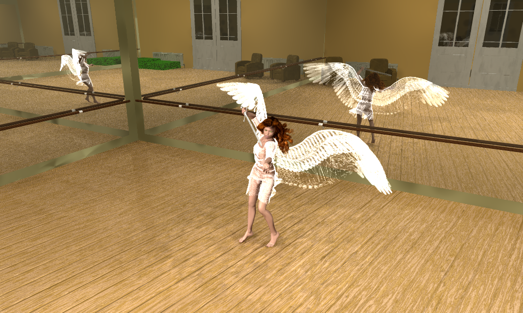

On 14/11/2017 13:57, clipka wrote:
> Am 14.11.2017 um 10:57 schrieb Stephen:
>>> - probably by at least 50 % (if not 25%) also for compensating the
>>> light reflections from the mirrors.
> Problems with different "quality levels" of illumination are to be
> expected here, due to the huge mirrors as well as the glowing wings.
> In reality, objects in the room would be lit by...:
> (1) Light coming directly from the light sources.
> (2a) Light bouncing off diffuse objects.
> (2b) Light emitted by glowing stuff.
> (3a) Light bouncing off diffuse objects and then the mirrors.
> (3b) Light emitted by glowing stuff and bouncing off the mirrors.
> (4) Light coming from the light sources and bouncing off the mirrors.
> (5) Light bouncing off the mirrors and then diffuse objects.
> To simulate (1), "classic" raytracing will do.
> To simulate (2) and (3), you need to enable radiosity.
> To simulate (4), you need to enable photons.
> To simulate (5), you need to enable both radiosity and photons.
> If any of these are not simulated, the corresponding portion of
> illumination will simply be missing, causing the image to appear darker.
> The lack of illumination from (2), (3) and (5) can be compensated for to
> some degree, by making use of the "ambient" mechanism.
> As far as overall brightness goes, you should ideally use renders with
> radiosity and photons as a yardstick, and set up "ambient" accordingly
> for fast test renders.
> (As a faster alternative to photons for this particular scene, you might
> try using mirrored copies of your primary light sources,
> `projected_through` the corresponding mirrors. Make sure to properly
> account for any dimming effect if your mirrors aren't 100% reflective.)
Thanks, they aren't, they are about 95% reflective. But I've ditched the
ordinary light source and am using emissive cubes as light sources.
I was thinking of adding a scattering media container first. Before
trying photons.
Regards
     Stephen

On 14/11/2017 21:55, Kenneth wrote:
> As the mirror reflections indicate, your dance hall has mirrors on only two
> walls.
Three mirrored walls in fact. I chose the camera position so that I
wouldn't have much of a hall of mirrors, effect.Just a view of three sides.
> I wonder what would happen re: radiosity and photon complexity if all
> four walls were mirrored?! (The 'infinite mirror-reflection' thing.) I have no
> idea, but it sounds like an interesting experiment to try. ;-)
So you want that I give my machine a stress test? ;)
Of course I'll give it a go. :)
Regards
     Stephen

I like this second version a lot - the camera position just works better I

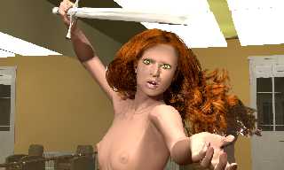

Here is a close up as changing the eyes in Poser was the only change I
made there.
FYI the female model is a low res one. I don't think it even uses an
image map for the body. So if I wanted more detail I would change it in
Poser. Besides I don't want to get distracted by looking at the model. ;-)

* I have no idea why in this image the wings and clothes did not show.
With the render time they should have been there.
But at least you can see that the model is low res and the eyes.
I had two other unexpected results yesterday that has set me back a bit. :-(

Download 'studio_vic2d_y_903a1_0000.png' (497 KB)
Preview of image 'studio_vic2d_y_903a1_0000.png'
Because media.
That's why media drives me crazy.

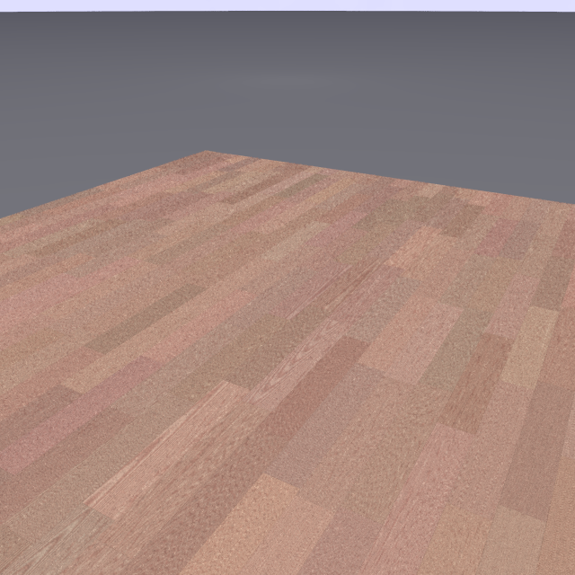

I have a macro, modified from work by Dan Hentschel in 2004. I shall put
it in p.b.utilities.
> Because media.
> And that's always the case, isn't it - there's always _something_ to start a
> cascade of stumbling blocks.
This is making me doubt my sanity. I'll strip the scene down to it's
essentials and see what's going on.
This is what it does.
Download 'dh_woodfloor_2.png' (495 KB)
Preview of image 'dh_woodfloor_2.png'

That looks good.

> shadows as if they are actual bright lights-- and with the rest of the light
> probe image functioning more or less as a straight environnment map, for the
> remaining soft lighting. (Like typical radiosity results when using a
> low-dynamic range image on a large sphere.) In other words, the only real reason
> for an HDRI light probe would be for its VERY bright lights, relative to the
> rest of its image.
> That's my own naive understanding, anyway.
Mine too.
> For an enclosed room like the dance hall, it seems to me that a typical LDR
> image-plus-radiosity would give equally realistic results (unless the room
> contained a SUPER-bright light somewhere.)
 From what I've seen of studios. They are either at the top of a
building with large windows and maybe two mirrored walls. Or have no
windows and rely totally on artificial light. Giving a even a light as
possible.
I don't think it would work in this scene. But if you find one that
could be appropriate. I'll run it overnight.
Regards
     Stephen
From: Stephen
Subject: Re: Not Clothed in light. So partial nudity
Date: 17 Nov 2017 06:09:39
Message: <5a0ec373$1@news.povray.org>
On 17/11/2017 05:00, dick balaska wrote:
> Am 11/16/2017 03:59 PM, also sprach Stephen:
>>> Nice. In the back mirror the wings seems to appear under the hairs...
>>> How did you make this red hair? Meshes?
>> Yes a standard Poser hair mesh. It takes no account of intersecting
>> with other meshes,
> That hair looks phenomenal from a distance. I thought you had
> photoshopped it in for a second. ;)
Yes it does look good. It is a Poser character called Amarseda Hair. I
had to use extreme settings to get it to go back with as few
intersections as possible.
There were several girls in my school with hair that colour. Their
tempers were about the same. ;-)
Regards
     Stephen
From: Bald Eagle
Date: 17 Nov 2017 08:00:01
Message: <web.5a0edc2e96756879c437ac910@news.povray.org>
> > > I'm sure some of us have some slightly richer looking wood floor macros lying
> > > about. ;)
> > As I implied to Thomas. The studio is a very old scene. At least ten
> > years old if I made it in Moray. So any contributions are welcome. :-)
> I'll see what I can isolate from the Secret Passage scene.
> You'd think there would be a well developed wood floor macro or include file -
> and having had to write the code to make an acceptable wood floor, I can see why
> there might not be one.
This probably needs to be prettied up to make it generally useful, but see how
this works.   (you may have to translate the floor -y*16*12)
// Planked Hardwood Floor with borders
// Bill Walker "Bald Eagle"  2014
// Some textures based on code supplied by Thomas deGroot
// and Nicolas Rougier
http://news.povray.org/povray.binaries.images/message/%3C54367691%241%40news.povray.org%3E/#%3C54367691%241%40news.povr
ay.org%3E
#version 3.7;
//######################## CONTROL PANEL SETTINGS ##########################
global_settings{
 assumed_gamma 1.0
 ambient_light rgb 0
 max_trace_level 7
 #if (Radiosity)
  radiosity {
   pretrace_start 1 //  0.08
   pretrace_end   1 //  0.04  //  0.01
   count 35    //  150
   nearest_count 5   //  10
   error_bound 1.8  //  0.5
   recursion_limit 2
   low_error_factor 0.5
   gray_threshold 0.0
   minimum_reuse 0.015   //  0.005
   maximum_reuse 0.2
   brightness 1
   adc_bailout 0.01    //  0.005
  }  // end radiosity block
 #else
 #end
  }// end global settings
#include "colors.inc"
#include "functions.inc"
#include "math.inc"
#include "metals.inc"
#include "rand.inc"
//#include "screen.inc"  //  perspective camera only
#include "shapes.inc"
#include "shapes2.inc"
#include "textures.inc"
#include "transforms.inc"
#include "woods.inc"
#declare Feet = 12;
  #declare Camera_Position = < -1.5*Feet, (18+6)*Feet,  -9*Feet> ;  // front
view
  #declare Camera_Look_At  = <  2*Feet,  16 *  Feet,  18*Feet> ;
  #declare Camera_Angle    =  65 ;
 camera {
  location Camera_Position
         right    x*image_width/image_height
         angle    Camera_Angle
         look_at  Camera_Look_At
light_source {<1500, 750, -200> color rgb <1, 0.8, 0>*5}  //  Sun
 light_source {<0*Feet, 25*Feet, 4*Feet> color rgb <1, 1, 1>*0.3}
#declare PlankNormal = normal { gradient x 2
    slope_map {
     [0.00 <0, 1>]
     [0.05 <1, 0>]
     [0.95 <1, 0>]
     [1.00 <0,-1>]
    scale 2
#declare Tone = 1;
#declare YRotate = 0;
#declare DarkWood= rgb <71, 35, 1>;
//(o)(o)(o)(o)(o)(o)(o)(o)(o)(o)(o)(o)(o)(o)(o)(o)(o)(o)(o)(o)(o)(o)(o)(o)(o)(o)(o)(o)(o)(o)(o)(o)(o)(o)(o)(o)(o)(o)(o)
(o)
(o)
#declare OakFloor = texture {
   pigment {bozo scale <1, 1, 10>
   color_map {
   //[0.4 rgb <0.9, 0.7, 0.4> * Tone]
   //[0.6 rgb <1.0, 0.8, 0.6> * Tone]
   [0.0 rgb <121/255,  52/255, 13/255> * Tone]
   [0.2 rgb <142/255,  73/255, 18/255> * Tone]
   [0.4 rgb <184/255, 115/255, 48/255> * Tone]
   [0.6 rgb <157/255,  81/255, 23/255> * Tone]
   [0.8 rgb <108/255,  45/255,  4/255> * Tone]
   [1.0 rgb <156/255,  72/255, 26/255> * Tone]
  turbulence 0.5
  scale <1, 1, 10> * 0.5
  rotate y*YRotate
 normal {
  average normal_map {
     [1 PlankNormal]
     [1 wood 0.5
      slope_map {
      [0.0 <0.0, 0>]
      [0.5 <0.5, 1>]
      [1.0 <1.0, 0>]
      }  // end slope map
     turbulence 0.5 scale <1, 1, 10> * 0.5]
    }  // end normal map
    rotate y * YRotate
  }  // end normal
   finish { specular 0.2 reflection 0.1 }  //  finish { specular 0.5 reflection
0.2 }
 }  // end texture
(o)
(o)
#declare Tone = <1.2, 1.2, 0.3>;
#declare OakFloor =
texture {
    pigment {
     wood
     color_map {
       [0.0 srgb <121,  52, 13>/255 * Tone]
       [0.2 srgb <142,  73, 18>/255 * Tone]
       [0.4 srgb <184, 115, 48>/255 * Tone]
       [0.6 srgb <157,  81, 23>/255 * Tone]
       [0.8 srgb <108,  45,  4>/255 * Tone]
       [1.0 srgb <156,  72, 26>/255 * Tone]
     warp {turbulence <0.6, 0.1, 0.1>}
     scale <1, 1, 10>*0.5
     scale 0.3
     rotate 1*x
     rotate y*10
(o)
(o)
//============= NR_Wood (2003) =============
#declare NR_wood_grain =
pigment {
   wood
   warp {cylindrical orientation y dist_exp 1}
   warp {turbulence 1.25}
   scale <0.5, 30, 1>
   warp {turbulence 0.25}
   scale <1, 10, 1>
   warp {
     black_hole <0, 0.5, 0>, 1
     falloff 2
     strength 1.5
     repeat 7
     turbulence 2
     inverse
#declare NR_wood_normal =
function {
   pigment {
     wood
     scale <0.5, 30, 1>
     scale <1, 5, 1>
     color_map {[0 rgb <0, 0, 0>] [1 rgb <1, 1, 1>]}
#declare NR_woodmap =
color_map {
     [0.00 srgb <0.949, 0.792, 0.514 >]
     [0.30 srgb <0.855, 0.651, 0.376 >]
     [0.60 srgb <0.831, 0.596, 0.275 >]
     [0.90 srgb <0.620, 0.447, 0.204 >]
#declare NR_woodmap2 =
     color_map {
       [0.1 srgb <142,  73, 18>/255 * Tone]
       [0.3 srgb <184, 115, 48>/255 * Tone]
       [0.8 srgb <157,  81, 23>/255 * Tone]
       //[0.8 srgb <108,  45,  4>/255 * Tone]
#declare Tone2 = Tone * 1.05;
#declare NR_woodmap3 =
     color_map {
       [0.0 srgb <121,  52, 13>/255 * Tone2]
       [0.1 srgb <142,  73, 18>/255 * Tone2]
       [0.3 srgb <184, 115, 48>/255 * Tone2]
       [0.8 srgb <157,  81, 23>/255 * Tone2]
       //[0.8 srgb <108,  45,  4>/255 * Tone2]
       [1.0 srgb <156,  72, 26>/255 * Tone2]
#declare Tone3 = Tone * 0.95;
#declare NR_woodmap4 =
     color_map {
       [0.0 srgb <121,  52, 13>/255 * Tone3]
       [0.1 srgb <142,  73, 18>/255 * Tone3]
       [0.3 srgb <184, 115, 48>/255 * Tone3]
       [0.8 srgb <157,  81, 23>/255 * Tone3]
       //[0.8 srgb <108,  45,  4>/255 * Tone3]
       [1.0 srgb <156,  72, 26>/255 * Tone3]
#declare FloorNormal = 0.8;
#declare NR_Wood =
texture {
   pigment {NR_wood_grain
     color_map {NR_woodmap2}
     ramp_wave
   normal {
     function {NR_wood_normal(x,y,z).grey*FloorNormal
   finish {diffuse 0.6 specular 0.1 roughness 0.005}
#declare NR_Wood2 =
texture {
     color_map {NR_woodmap3}
     ramp_wave
   normal {
#declare NR_Wood3 =
texture {
     color_map {NR_woodmap4}
     ramp_wave
   normal {
(o)
(o)
//#declare OakFloor = texture {NR_Wood scale 1 rotate <90, 0, 0>};
#declare HalfWidth    =  19.0;
#declare MortarScale  =  0.99;  //  0.995;
#declare TunnelRadius =  1.5;
#declare RoomWidth    =  9.0;
#declare PlankScale   =  1.78;
#declare FloorBorder =
union {
 #declare BorderSize = 2;
 //Left
 box {<-(RoomWidth*Feet)+0, -0.1, -9*Feet>, <-(RoomWidth*Feet)+(2*BorderSize),
2.0, 18*Feet> texture {NR_Wood2 scale 1 rotate <90, 0, 0>}}
 box {<-(RoomWidth*Feet)+(2*BorderSize), -0.1, -9*Feet>,
<-(RoomWidth*Feet)+(6*BorderSize), 2.0, 18*Feet> pigment {srgb <121,  52,
13>/255 * Tone3}}//texture {NR_Wood3 scale 1 rotate <90, 0, 0>}}
 #declare BlockRow = -(9*Feet);
 #declare Alternate = 1;
 #while (BlockRow < (18*Feet))
  #if (Alternate > 0)
   box {<-(RoomWidth*Feet)+(2*BorderSize+0.25), -0.1, BlockRow+0.25>,
<-(RoomWidth*Feet)+(6*BorderSize-0.25), 2.1, BlockRow+1.75> texture {NR_Wood
scale 1 rotate <90, 90, 0>}}
  #else
<-(RoomWidth*Feet)+(6*BorderSize-0.25), 2.1, BlockRow+1.75> texture {NR_Wood2
  #end
  #declare BlockRow = BlockRow + (1*BorderSize);
  #declare Alternate = -Alternate;
 #end
 box {<-(RoomWidth*Feet)+(6.0*BorderSize), -0.1, -9*Feet>,
<-(RoomWidth*Feet)+(7.5*BorderSize), 2.0, 18*Feet> texture {NR_Wood2 scale 1
rotate <90, 0, 0>}}
 box {<-(RoomWidth*Feet)+(7.5*BorderSize), -0.1, -9*Feet>,
<-(RoomWidth*Feet)+(8.0*BorderSize), 2.0, 18*Feet> pigment {srgb <121,  52,
13>/255 * Tone3}}
 // Right
 box {<(RoomWidth*Feet)-0, -0.1, -9*Feet>, <(RoomWidth*Feet)-(2*BorderSize),
 box {<(RoomWidth*Feet)-(2*BorderSize), -0.1, -9*Feet>,
<(RoomWidth*Feet)-(6*BorderSize), 2.0, 18*Feet> pigment {srgb <121,  52, 13>/255
  #if (Alternate > 0)
   box {<(RoomWidth*Feet)-(2*BorderSize+0.25), -0.1, BlockRow+0.25>,
<(RoomWidth*Feet)-(6*BorderSize-0.25), 2.1, BlockRow+1.75> texture {NR_Wood
  #else
<(RoomWidth*Feet)-(6*BorderSize-0.25), 2.1, BlockRow+1.75> texture {NR_Wood2
  #end
 #end
 box {<(RoomWidth*Feet)-(6*BorderSize), -0.1, -9*Feet>,
<(RoomWidth*Feet)-(7.5*BorderSize), 2.0, 18*Feet> texture {NR_Wood2 scale 1
rotate <90, 0, 0>}}
 box {<(RoomWidth*Feet)-(7.5*BorderSize), -0.1, -9*Feet>,
<(RoomWidth*Feet)-(8*BorderSize), 2.0, 18*Feet> pigment {srgb <121,  52, 13>/255
* Tone3}}
 // Back
 box {<-(RoomWidth*Feet)+12, -0.1, 18*Feet-0>,
<(RoomWidth*Feet)-12, 2.0, 18*Feet-(2*BorderSize)> texture {NR_Wood2 scale 1
 box {<-(RoomWidth*Feet)+12, -0.1, 18*Feet-(2*BorderSize)>,
<(RoomWidth*Feet)-12, 2.0, 18*Feet-(6*BorderSize)> pigment {srgb <121,  52,
13>/255 * Tone3}}
 #declare BlockRow = -(RoomWidth*Feet)+12;
 #while (BlockRow < (RoomWidth*Feet)-12)
  #if (Alternate > 0)
   box {<BlockRow+0.25, -0.1, 18*Feet-(2*BorderSize+0.25)>, <BlockRow+1.75, 2.1,
18*Feet-(6*BorderSize)-0.25> texture {NR_Wood  scale 1 rotate <90, 0, 0>}}
  #else
18*Feet-(6*BorderSize)-0.25> texture {NR_Wood2 scale 1 rotate <90, 0, 0>}}
  #end
 #end
 box {<-(RoomWidth*Feet)+12, -0.1, 18*Feet-(6.0*BorderSize)>,
<(RoomWidth*Feet)-12, 2.0, 18*Feet-(7.5*BorderSize)> texture {NR_Wood2 scale 1
 box {<-(RoomWidth*Feet)+12, -0.1, 18*Feet-(7.5*BorderSize)>,
<(RoomWidth*Feet)-12, 2.0, 18*Feet-(8*BorderSize)> pigment {srgb <121,  52,
13>/255 * Tone3}}
 // Front
 box {<-(RoomWidth*Feet)+12, -0.1, -9*Feet+0>, <(RoomWidth*Feet)-12, 2.0,
-9*Feet+4> texture {NR_Wood2 scale 1 rotate <90, 0, 0>}}

From: Stephen
Date: 17 Nov 2017 08:48:00
Message: <5a0ee890$1@news.povray.org>
Thanks, that looks good. I'll need to modify it a bit as B3D doesn't
handle functions. But that shouldn't be too hard.
Regards
     Stephen
Oops! the camera was inside the media container.
This is what it was meant to be like. After taking two hours with no AA
nor mirrors. I am posting it. ;-)
Regards
     Stephen
I managed to look at your code.
I worked my way through it correcting the wrap text/CR-LF errors,
created by T/Bird. Then I substituted the Normals with their fancy
Functions. (B3D cannot handle Functions.)
When I imported the macro into B3D it showed that the scaling of the
studio is all to cock. So I will need to rebuild it before I can use
your macro. That is a shame as the border looks good. For simplicity
I've "borrowed" Warp's code from his "4 tips" tutorial and I've changed
the scale of the model to make it fit in better with the furniture and
props. So this will be the last image in this test.
Regards
     Stephen
