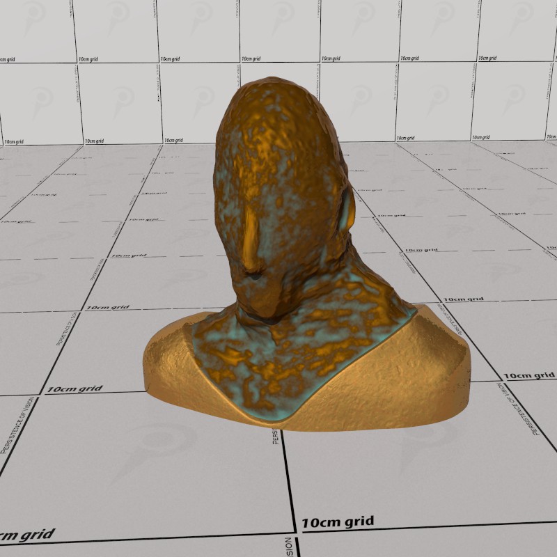

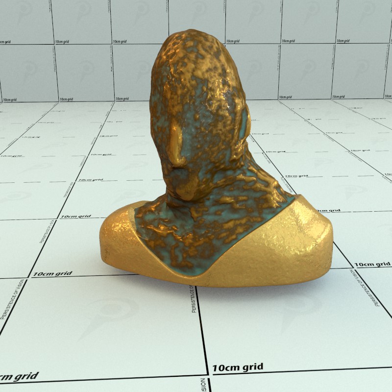

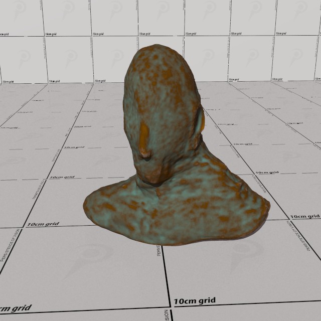

If not I can recommend proximity pattern by using an ambient occlusion render
together with the usage of Rune's illusion code. This method is fast and very
precise for small details.
Here is an example when testing some metal materials (no copper corrosion, but
perhaps partly cleaned small copper figures?).
Norbert
Download 'copper proximity.jpg' (738 KB)
Preview of image 'copper proximity.jpg'

Thanks indeed Norbert. I am working on it but I shall keep your
technique on the back burner for further investigation.

That's a beautiful image.
I'm a big fan of Rune's illusion.inc code. If I understand your method
correctly, it means generating an ambient occlusion render first (in whichever
way you want to go about that--a grayscale image, with the entire scene and
object using a temporary white pigment?) Then, using illusion.inc to
'camera-project' that AO render back onto the object's real texture, as an
additional overlay.
If I'm correct about the method, then the grayscale AO render first needs to be
taken into, say, Photoshop, to create an alpha-channel mask (using the *same*
image for that but inverted, to create transparency for the white parts of the
image.) *Then* it's overlayed onto the object, so that the real texture can show
through--except where the AO render has darker areas.
Correct so far? (I hope I'm making sense.) Or does your method use an actual
'proximity pattern' as well, in some way?
To Thomas: Nice work with your trials and experiments. I still haven't played
around with the proximity pattern code yet; real-life chores keep getting in the
way. Very irritating :-/

Thanks Kenneth.
I have used AO myself in other contexts but I never used (yet)
illusion.inc; the ToDo list is getting too long. ;-)
If your description of the method is correct, the draw back would be
that you have to produce a new transparency map for every new camera
setting or transformation to the object. This is not the case with the
DF3 method.
> additional overlay.
The AO render uses good radiosity settings, no background, a simple texture and
an emissive sphere like that:
sphere {
        0, 10000
        texture {
                pigment {color rgb 1}
                finish {emission 1.2 diffuse 0}
#declare T2 =
material {
 texture {
  finish {ambient 0 diffuse 0.8}
 interior {ior 1}
No transparency is used.
Rune's Illusion code is used to create a pigment pattern with perfect fit for a
texture map:
//______________________________________________________________________________
// illusion
#declare illusion_image     = "AO render.png"          ///////////////////////
#declare illusion_scale     = 10;
#declare illusion_samples   = 50;
#declare illusion_location  = <50,0,-201.5>; // camera location
#declare illusion_angle     = 46;            // camera angle
#declare illusion_look_at   = <0,0,0>;       // camera look at
#ifndef (illusion_location)  #declare illusion_location  = <0,0,0>; #end
#ifndef (illusion_right)     #declare illusion_right     =
image_width/image_height*x;  #end
#ifndef (illusion_up)        #declare illusion_up        = y;       #end
#ifndef (illusion_direction) #declare illusion_direction = z;       #end
#ifndef (illusion_sky)       #declare illusion_sky       = y;       #end
#ifndef (illusion_angle)     #declare illusion_angle     = degrees (atan2
(vlength (illusion_right)/2/vlength (illusion_direction),1))*2; #end
#ifndef (illusion_look_at)   #declare illusion_look_at   =
illusion_location+illusion_direction; #end
#ifndef (illusion_image)     #debug "\n\n--> you must specify
'illusion_image'!\n\n"  #end
#declare illusion_format = strlwr (substr (illusion_image,strlen
(illusion_image)-3,4))
#if (strcmp (illusion_format,".png") != 0 & strcmp (illusion_format,".tga") !=
0)
        #debug concat (
                "\n\n--> extension of illusion_image: ",
                strlwr (substr (illusion_image, strlen (illusion_image)-3,4)),
                "\n--> illusion_image must be a .png or .tga file!\n\n"
#end
// CREATE THE IMAGE MAP USED IN THE ILLUSION
#ifdef (illusion_image_function)
        #undef illusion_image_function
#end
#declare illusion_image_function =
function {
        #if (strcmp (illusion_format,".png") = 0)
                pigment {image_map {png illusion_image gamma 2.2 once} translate
-0.5}
        #else
                pigment {image_map {tga illusion_image gamma 2.2 once} translate
-0.5}
        #end
// CREATE THE RAW ILLUSION ALIGNED ALONG Z AXIS
#declare illusion_raw =
pigment {
        average
        pigment_map {
                [1      function {illusion_image_function (x/z,y/z,z).red}
color_map {[0  rgb 0][1  rgb <4,0,0>]}]
                [1      function {illusion_image_function (x/z,y/z,z).green}
color_map {[0  rgb 0][1  rgb <0,4,0>]}]
                [1      function {illusion_image_function (x/z,y/z,z).blue}
color_map {[0  rgb 0][1  rgb <0,0,4>]}]
                [1      function {illusion_image_function (x/z,y/z,z).transmit}
color_map {[0  rgb 0][1  transmit 4]}]
// ALIGNMENT CALCULATIONS
#declare illusion_t = illusion_location;
#declare illusion_z = vnormalize (illusion_look_at-illusion_location);
#declare illusion_x = vnormalize (vcross (illusion_sky, illusion_z))*tan
(radians (illusion_angle/2))*2;
#declare illusion_y = vnormalize (vcross (illusion_z, illusion_x))*tan (radians
(illusion_angle/2))*2*vlength (illusion_up)/vlength (illusion_right);
// CREATE AND ALIGN THE ILLUSION
#declare illusion =
pigment {
        illusion_raw
        matrix <
                illusion_x.x,illusion_x.y,illusion_x.z,
                illusion_y.x,illusion_y.y,illusion_y.z,
                illusion_z.x,illusion_z.y,illusion_z.z,
                illusion_t.x,illusion_t.y,illusion_t.z
#declare f_illu = function {pigment {illusion}}
#declare T3 =
material {
 texture {
                pigment_pattern {
                        illusion_raw
                        matrix <
                texture_map {
                 [0.5   copper3]  // copper rust
                 [0.8   copper2]  // copper patina
                 [0.9   copper2]
                        [1     copper1]  // polished copper
 interior {ior 1.6}
 scale 1
Norbert
From: Kenneth
Subject: Re: Proximity Pattern testing
Date: 23 Sep 2017 09:00:01
Message: <web.59c659b081230942883fb31c0@news.povray.org>
> texture and an emissive sphere like that:
> sphere {
>         0, 10000
>         texture {
> #declare T2 =
> material {
>  texture {
>  interior {ior 1}
Yes, that make sense for the initial AO render. Thanks. Although, I'm not sure
what the reason is for interior{ior 1}.
My own 'fake AO' method-- actually just a few experiments years ago-- was to
have a similarly white object, but I also used a white plane under it, to pick
up the AO effect where the object met the plane. And a similar white outer
sphere--but used just as a background, and without radiosity(!). To create the
AO effect, I placed hundreds of point lights in a distant hemispherical pattern.
The many overlapping shadows on the object looked *similar* to a radiosity
render. But if I were to do it again, I would use your method ;-)
> for a texture map:
[snip]
Wow! I need to digest your code (your math trickery is something I need to
study; it uses techniques that I'm not too familiar with-- but that I really
need to learn and apply.) In all of my own uses of illusion.inc, I've never
actually tried 'mathematically' fitting the projected image to an object. I've
always done the opposite: choosing a pre-made digital photo image, then
constructing all the scene's geometry to 'fit' the photo details, when
'projected' onto the geometry! A very tedious procedure, I admit. Your code is
very much appreciated, as an alternative method for a different kind of use.
From: Kenneth
Date: 23 Sep 2017 09:45:00
Message: <web.59c6641b81230942883fb31c0@news.povray.org>
> DF3 method.
You're correct, if you intend to move the camera or object(s) around.
Illusion.inc is really for a pre-set static scene (more or less, which I'll
describe below.)
Basically, illusion.inc can be thought of a an old-style 'color slide
projector', placed *at* the POV-Ray scene's camera position. The projected image
fills the entire rendered frame--but you choose which objects in the scene to
apply the projected image onto. (Each object shows only that particular portion
of the full image 'texture'.) In other words, the *same* illusion.inc image is
'attached' to any/all of the objects. The visual effect of this is fundamentally
different from applying typical image_maps to the objects: The z-depth of the
individial objects doesn't matter-- the projected image itself will always
appear the same size on them, and undistorted, even on spherical objects (for
example.)
But here's a really interesting feature (the most important one, IMO): Although
the illusion.inc 'camera position' is supposed to match the scene's real
camera-- for the best undistorted image reproduction-- the scene camera CAN be
moved around (somewhat, within limits.) I've used this for some really cool
animations; the visual result is like a 3-D 'matte painting'.
A caveat: When trying to use illusion.inc for the first time, it can be a bit
confusing to understand, visually speaking. IMO, it has a few features that are
unnecessary and only 'get in the way.' I've re-written my own version, to remove
that stuff.
From: Stephen
Date: 23 Sep 2017 11:58:08

..and to support my case: I have been doing some little sculpture in
between.
Download 'ep_proximity_test.jpg' (61 KB)
Preview of image 'ep_proximity_test.jpg'
From: Stephen
Date: 26 Sep 2017 03:38:29
Message: <59ca03f5@news.povray.org>
On 26/09/2017 08:11, Thomas de Groot wrote:
> ...and to support my case: I have been doing some little sculpture in
> between.
I'm seeing Giacometti, here. :-)
http://www.dailyartfixx.com/wp-content/uploads/2010/10/Walking-Man-Alberto-Giacometti.jpg
Regards
     Stephen
>> between.
His cousin.
While testing some features in Silo, I started with a low poly bust
provided by them and got this. I think I shall add a few little things
and hone the textures.
> between.
... and here is the latest version; using the Norbert Kern / James
Holsenback brass texture for the clothing.
Date: 27 Sep 2017 03:46:40
Message: <59cb5760@news.povray.org>
>> between.
Well, should have attached the image :-)
Download 'ep_proximity_test.jpg' (94 KB)
From: Stephen
Date: 27 Sep 2017 03:54:52
Message: <59cb594c@news.povray.org>
>>> between.
I think you can say that it worked.
Very nice. :-)
Regards
     Stephen
Date: 29 Sep 2017 04:07:51
Message: <59cdff57@news.povray.org>
>>> between.
... of course, this texture demands a light probe ;-)
Download 'ep_proximity_test.jpg' (112 KB)
From: Mr
Date: 29 Sep 2017 04:50:00
Message: <web.59ce083b8123094216086ed00@news.povray.org>
> >>> between.
> Thomas
Hi, it looks like a good basis, but reflections appear slightly too strong/
crisp/ homogenous:
Here are three workarounds maybe some already used:
*roughness in uberpov reflection block
*use conserve_energy / albedo + fresnel in reflection block with an explicit ior
*use the proximity pattern as a texture map for the "finish map" trick
(http://www.povray.org/documentation/view/3.6.2/82/) to modulate reflections and
make less of them where metal is corroded/oxidized
Date: 29 Sep 2017 07:17:06
Message: <59ce2bb2$1@news.povray.org>
On 29-9-2017 10:56, Mr wrote:
> [...] Sorry for this off topic comment, but I also like how you wrote
> "persistence of vision" instead of POV-Ray which makes it more modern
> ("Ray(tracer)" sounds so nineties); and also more "marketable" to french
> speaking people!
> I which I would have dared naming it as fully when first setting up the Blender
> exporter's repository...
Nothing to do with me ;-) Is an image_map which came with Edouard Poor's
set of files almost ten years ago.
Date: 29 Sep 2017 07:23:20
Message: <59ce2d28$1@news.povray.org>
>>>>> between.
>> Thomas
> crisp/ homogenous:
Yes, something to try indeed.
I used the finish statement as given by Norbert Kern in his brass
texture. Can be improved of course ;-)
As far as I know, it does that already.
> > crisp/ homogenous:
Before reading what Mr wrote I was only going to mention the shininess of the
green oxidation too.
Was thinking along the lines of specular highlight and diffuse plus brilliance,
not reflection.
Anyway... your sculpture or bust is somewhat creepy. I see it as an Egyptian
mummy emerging from a golden cocoon.
> crisp/ homogenous:
fresnel and metallic reflection are not compatible in the same
reflection block. You need to layer the fresnel reflection, with a
totally transparent pigment of course, over the metallic one.
Also, that won't work if you use any kind of patterned texture.

Am 29.09.2017 um 23:57 schrieb Alain:
>> explicit ior
Actually, `metallic` already includes a fresnel term (even one which is
more realistic for metals than the standard one, which is only realistic
for dielectrics).
