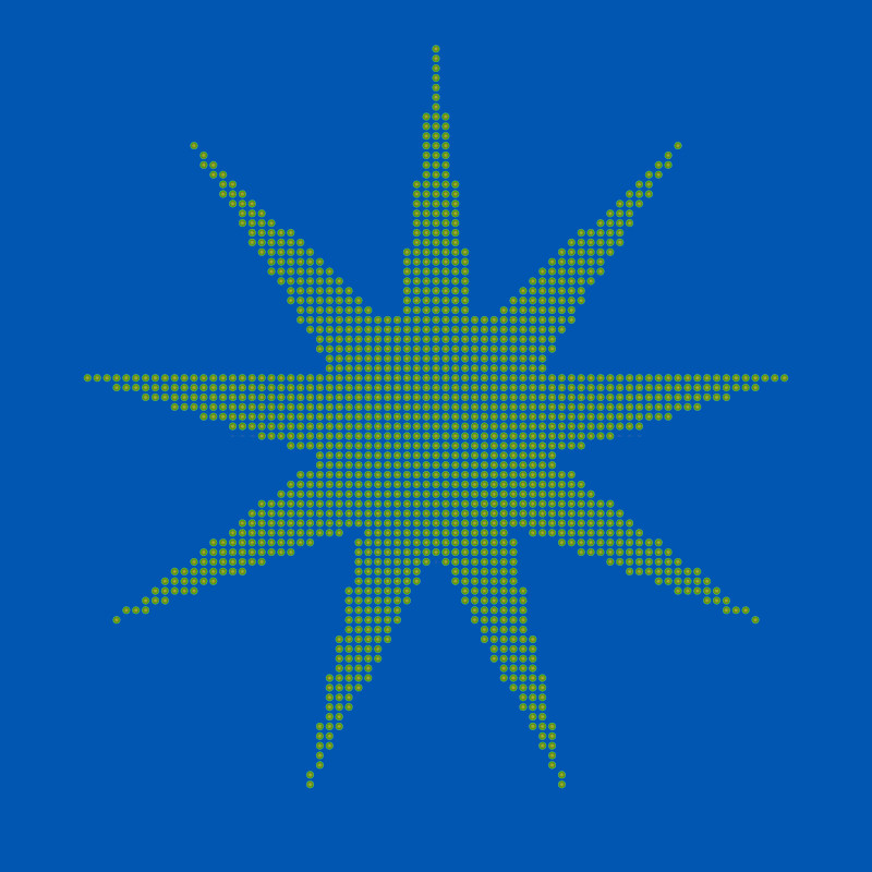

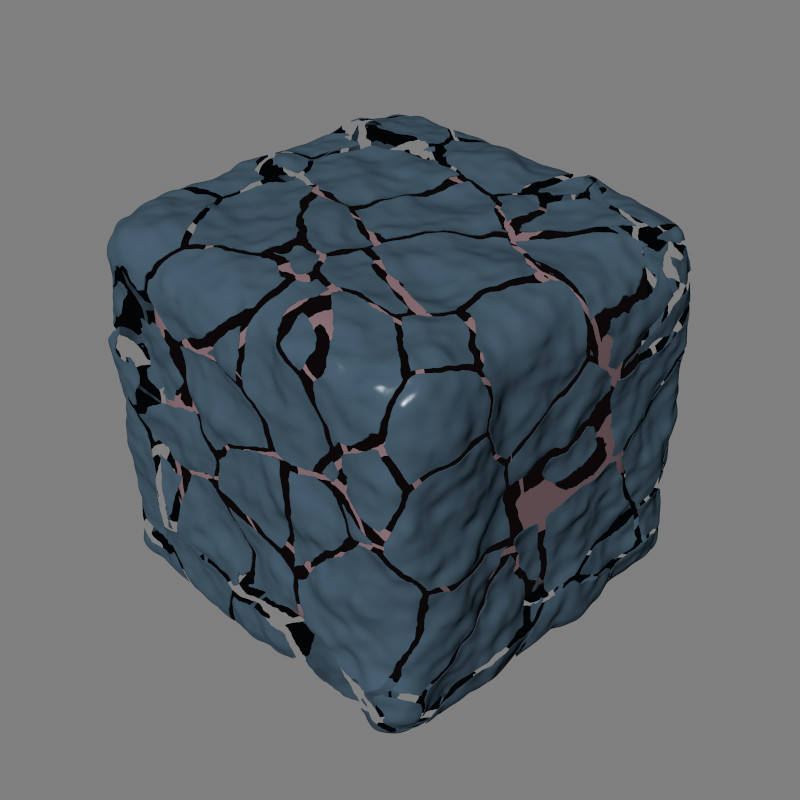

The three attached images were created using two new patterns called
hard_object and soft_object. They can be found in the patch branch off
master (3.7.2) at:
https://github.com/wfpokorny/povray/tree/feature/soft_objectAndhard_objectPatterns
Associated demo scenes can be found in the scenes/textures/patterns
directory of the branch. Both new patterns are aimed first at making the
object to isosurface-object path easier. However, both work as pure
patterns too with gradual 0 to 1 value changes from the object surface
inward.
The hard_object pattern is a more complete implementation of the
ObjectAsIso idea I was playing with - mostly in SDL - back in 2008 or
2009. Hard because the method replicates an input object's sharp features.
The soft_object pattern is based upon a subset of the density file
pattern updates and ideas I was playing with last year. See:
http://wiki.povray.org/content/User:Wfpokorny/DensityFile. Soft because
the method uses exponential blobbing. In this implementation a virtual
"df3 grid" is created on the fly.
The essential sdl for hard_object looks like:
  #declare FnHardObj = function {
     pattern { hard_object { ObjectText }
         radius 0.08
         recursion_limit 10
         samples 22
         warp { turbulence VarTurb octaves 3 lambda 3 }
and for soft_object it looks like :
#declare FnSoftObj = function {
     pattern { soft_object { ObjectText }
               spacing 0.009
               strength 1.00
               warp { turbulence VarTurb lambda 5 }
If you'd like to give these patterns a try, feel free to grab the branch
off github. I'm still seeing what they can do - and not do - myself.
Bill P.
Further notes.
- Both patterns are sampling based.
- The hard_object demo uses one text object ("Water") for simplicity.
The soft_object demo is made faster making each letter was its own
isosurface due bounding and inside object test efficiency. Both methods
are sensitive to how quickly the inside object tests can be done.
- Objects used must have a defined inside.
- Further documentation on the options can be found in the associated
git commit messages.
- If using as a pattern the soft_object is often faster than hard_object
for a smooth result. The reverse tends to be true if using the patterns
in an isosurface.
- When using hard_object in a pattern low recursion_limit values and
high samples are usually best. If using the hard_object pattern in an
isosurface low samples and higher recursion tends to be better.
- The hard_object method works exceptionally well with convex,
outwardly-pointy object features. The method struggles with concave,
inward-crevasse portions of the object - though where samples high
enough the distance from surface measure is decent. As the spherical
sampling moves further inside the original object fewer and fewer of the
spherical samples are usable in estimating the distance within - and
results get noisy. Such noisiness is both shown and used for effect in
this TinaCHeP image:
http://www.tc-rtc.co.uk/imagenewdisplay/stills/754/10.html
- Aggressive AA settings in combination with these patterns should be
avoided until final renders. The relative slowness of the patterns
compounds with AA.

One of my goals with the hard_object pattern was to get to where we
could pass an object with a defined inside to some macro and have it
create a peeling paint (PP) (or other surface-skin) isosurface for that
object without the need for extra outside steps.
While obviously not a complete/correct PP implementation, using a
superellipsoid - as Thomas did in his original peeling paint texture
postings - kinda functions. See the attached image.
The bad news is I don't think the performance is tolerable - except
perhaps to those with 32 or more fast, real cores willing to endure some
long renders...
Suspect part of the issue is in doing everything on the fly necessarily
puts the crackle pattern into the overall function being evaluated where
it was previously a separate 2D-in-evaluation outside step. Often the
case with isosurfaces; Put a handful of slightly slow things together in
a function, stick it in an isosurface and you get glacially slow. :-)
Anyway, off to do some performance profiling to see if I can nudge the
technique into the practical realm.
Bill P.

Very nice indeed! I am following this work in progress with strong interest.

Yes, if I'm understanding your question. Gradients are generated from
objects with both the hard_* and soft_* pattern variants. Objects like
box, sphere, mesh etc so long as they have a defined inside.
The gradients generated behave differently & the image posted to
TinaCHeP shows the hard_object pattern as a pigment on a plane. Attached
is an example of the soft_object variant where I back way down on the
strength parameter so that the individual df3 like virtual grid can be
seen; We essentially get many small sphere gradients at the virtual
voxel centers. The containing object here is a 9 point star mesh
compliments of some code posted by "Mike the Elder" a while back.
For soft_object at strong strengths - giving better overall rounding -
most of the interior has a value of 1.0 and only the near surface
regions of the mesh have the 0-1 gradient.
Both the hard and soft variants normally tend toward 1.0 well inside the
shape. The hard variant stops at 1.0 by nature of the method used, the
soft method internally goes to well over a 1.0 value, but is currently
clamped to 1.0 as all, but the new potential pattern, are presently.
Bill P.
All of this is quite fascinating.
I must have missed Thomas's posting. Anyone have a link to it?
