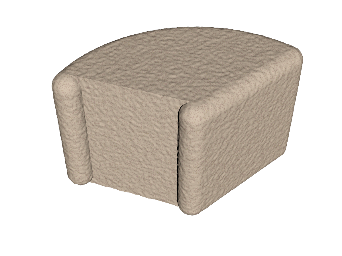

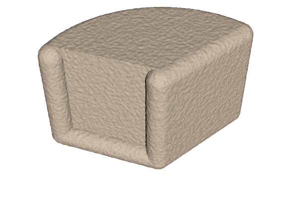

I can make a sphere where i want;
sqrt(
pow(x-Inside_length,2)
+pow(y-Height+Edge,2)
+pow(z-Edge,2)
)-Block_Round_corner,//sphere outside top
I can rotate the sphere;
//x=x*cos(radians(Angle)) - z*sin(radians(Angle))
//z=x*sin(radians(Angle)) + z*cos(radians(Angle))
//Inside_length=Inside_length*cos(radians(Angle)) - Edge*sin(radians(Angle))
//Edge=Inside_length*sin(radians(Angle)) + Edge*cos(radians(Angle))
sqrt(
pow(x-(Inside_length*cos(radians(-Angle)) - Edge*sin(radians(-Angle))),2)
+pow(z+(Inside_length*sin(radians(-Angle)) + Edge*cos(radians(-Angle))),2)
I can make a cylinder;
max(//reference edge good
  sqrt(pow(x-Inside_length,2)+pow(z-Edge,2))-Block_Round_corner,
  y-Height+Edge,
  -y+Edge
I can rotate this cylinder, but only on its infinite axis;
max(//rotated edge good
sqrt(
  pow(x-Inside_length*cos(radians(Angle)) - Edge*sin(radians(Angle)),2)
+pow(z-Inside_length*sin(radians(Angle)) + Edge*cos(radians(Angle)),2)
y-Height+Edge,
-y+Edge
Now my question;
How do I rotate around y axis
  sqrt(pow(y-Edge,2)+pow(z-Edge,2))-Block_Round_corner,
  x-Inside_length,
  -x+Inside_corner
I can substitute my z, but what do I use for my x?
After trying some other stuff, I also have;
sqrt(
  pow(y-Edge,2)
  +pow(z-Edge,2)
+pow(x-select(min(x-Inside_length,0),max(x,Inside_corner),min(x,Inside_length)),2)
Witch seems to give a cylinder with rounded ends.
I can't seem to rotate this ether.
Suggestions, hints?
First image: my work so far on an isosurface rounded_cylinder_section.
Second image: my cylinder with rounded ends equation.
Stephen S
Download 'stone_blocks_0000.png' (769 KB) Download 'stone_blocks_0002.png' (267 KB)
Preview of image 'stone_blocks_0000.png'
Preview of image 'stone_blocks_0002.png'

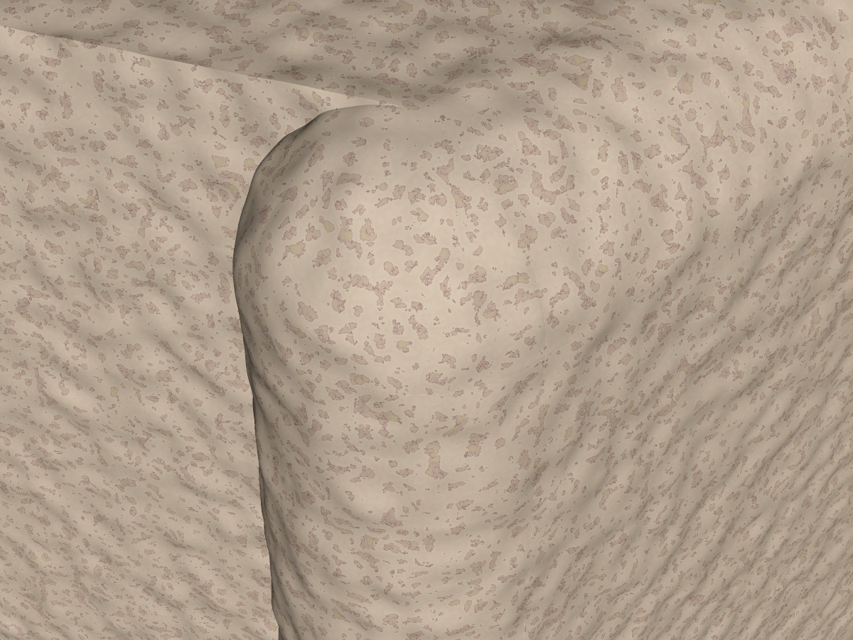

From: StephenS
Subject: Re: Rotating isosurface cylinder
Date: 11 Oct 2016 21:35:44
Message: <57fd9370@news.povray.org>
I will probably switch to
f_rounded_box(x,y,z, P0, P1, P2, P3)
from functions.inc.
I can rotate and place this, but I would still like to know how to do it
with a cylinder.
My use of min()/max() in the isosurface causes some artifacts at close
inspection.
Comments welcome;
Stephen S
Download 'stone_blocks_0001.png' (1389 KB)
Preview of image 'stone_blocks_0001.png'

From: William F Pokorny
Date: 12 Oct 2016 04:03:32
Message: <57fdee54@news.povray.org>
> from functions.inc.
> with a cylinder.
> inspection.
> Comments welcome;
> Stephen S
With min, max I think these sorts of artifacts are always more or less
there at the threshold-seam between functions. They might or might not
be seen due AA, application or not of noise/displacement to the
component functions into max/min, ray direction, etc.
Increasing accuracy (smaller value) in your isosurface sometimes helps.
Using a blobbing function instead of - or in addition to min/max - will
fix the issue in my experience at the expense of the blobbing.
Bill P.

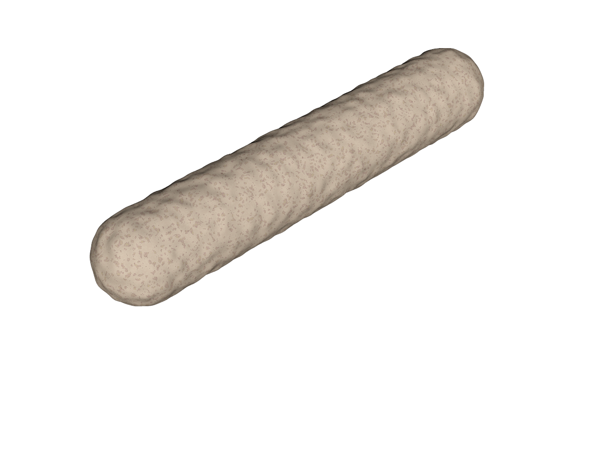

From: StephenS
Date: 12 Oct 2016 06:31:45
Message: <57fe1111$1@news.povray.org>
The rounding is meant to be small, to allow the larger block to stand
out. It's unlikely to be seen at the scale I intend.
Thanks.
Stephen S
From: StephenS
Date: 12 Oct 2016 06:48:11
Message: <57fe14eb@news.povray.org>
On 12/10/2016 3:10 AM, scott wrote:
> For rotation about z, you need:
> ( from https://en.wikipedia.org/wiki/Rotation_matrix#Basic_rotations )
> x' = x*cos(a) - y*sin(a)
> y' = x*sin(a) + y*cos(a)
> z' = z
> Putting those into your function above you get something like:
> #local a = radians(30);
> sqrt(
>  pow((x*sin(a)+y*cos(a))-Edge,2)
>  +pow(z-Edge,2)
+pow((x*cos(a)-y*sin(a))-select(min((x*cos(a)-y*sin(a))-Inside_length,0),max((x*cos(a)-y*sin(a)),Inside_corner),min((x*cos(a)-y*sin(a)),Inside_length)),2)
sqrt(
  pow(y-Edge,2)
  +pow(x*sin(radians(-Angle)) + z*cos(radians(-Angle))+Edge,2)
  +pow(x*cos(radians(-Angle)) -
z*sin(radians(-Angle))-select(min(x*cos(radians(-Angle)) -
z*sin(radians(-Angle))-Inside_length,0),max(x*cos(radians(-Angle)) -
z*sin(radians(-Angle)),Inside_corner),min(x*cos(radians(-Angle)) -
z*sin(radians(-Angle)),Inside_length)),2)
I though I tried something like this before I posted.
This works. Thanks.
Changes I made:
Angle refers to the final shape, and -Angle is how I get it.
For the z. I changed to +Edge, to line up with the final shape.
Comments welcome;
Stephen S
Download 'stone_blocks_0000.png' (215 KB)
