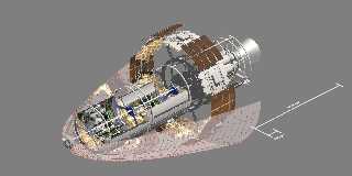

I decided to dust off this old scene and work on a few more bits.
I finalized how the docking bay and engine are going to be laid out, and
I am happy with them.
I also split the habitation area into two counter-rotating sections. I'm
thinking of making the end caps concave, like the bottom of a soda can.
A note about the cone in front. It's supposed to be a mesh of copper or
gold wires that are electrically charged to keep dust from coming in
contact with the ship. Kind of the opposite of a solar sail. I need to
work on the wires a bit more to make them apparent.
Enjoy!
Mike
I don't know. I like the effect you have now.
Regards
     Stephen

Another thing I worry about is the weak spine of the ship. I need to
create struts around the circumference of the ship so the ship does not
break in half when applying thrust! Aircraft and spacecraft IRL tend not
to have spines, but rather a hollow frame.
> Enjoy!
> Mike
Given the size of that ship, the wires won't be individualy visible
unless they are very thick, like around 1m thick...
The part of the spine inside the living section is OK as it don't seem
to have a real structural function. But, going aft, it does indeed look
flimsy.

Several changes.
Mike
Download 'gh_scene_spinner_cutaway_24.png' (643 KB)
Preview of image 'gh_scene_spinner_cutaway_24.png'

I decided to use an array of spheres for the spiral lamp light instead
of a single object since it's a lot easier to control.
I also tweaked the parabolic nose shield. I am very unhappy with the
texture however. It's supposed to simulate a wire mesh, not a solid
surface, but I don't think it's working. Here is the texture:

Am 10.01.2016 um 00:38 schrieb Mike Horvath:
No that indeed doesn't work at all.
You'll want "micronormals", i.e. some "normal {...}" statement with a
pattern scaled so small that it is no longer visible in the image.
Ideally the structure of the pattern should match the structure of
whatever material you intend to simulate.
Make sure you don't get moiree effects from it though; anti-aliasing
might do the trick, otherwise I'd recommend using a tiny bit of focal
blur, or use UberPOV's anti-aliasing mode 3. Or you might just choose a
random pattern, which won't be as close to the real deal but will not
cause any moiree at all.
Speaking of UberPOV, if you go down that route another alternative would
be to just use highly blurred reflections.

How would I create the pattern? The radial part is easy, but how do I
get the ribbed portion? Which function do I use?
f_paraboloid(x,y,z, P0)
Or something else?

I guess I should clarify that what you see in that last image is not a
texture, but a physical array of cylinders and tori. Replacing them with
a proper texture would make the scene render much faster as well.
Mike

Am 10.01.2016 um 01:51 schrieb Mike Horvath:
Ah, I guess we have a misunderstanding there. I thought you wanted the
semi-transparent paraboloid sheet to look more like a fine mesh, but now
my understanding is that it is the visible support structure of that
paraboloid that you want to look more like a mesh.
Well, my guess there is that it doesn't look like wires because they're
not really the size of wires, and also because the "longitudinal" and
"latitudinal" structures simply intersect. Maybe if they just touched
each other, possibly in an alternating "weaving" fashion, and maybe
connected with some "clamps", it might look better.
Also I wouldn't use copper. It's expensive, heavy, and you only need it
if there are high currents involved. Presuming the shield is primarily
based on static voltage, metals with higher resistance should work just
as fine.
Aluminum might make for a great alternative, too.

No, you were right. I want to make the paraboloid sheet to look like a
mesh. The solid ribs take too long to render.
I will also switch the material to look the same as the engine nozzle.
Mike
From: Mike Horvath
Subject: Re: Colony ship
Date: 10 Jan 2016 00:15:35
Message: <5691e8f7@news.povray.org>
> as fine.
Here's the code I use for the paraboloid, by the way. Whatever i end up
doing, it has to match up with that.
#local glass_cone = difference
	object
		Paraboloid_Z
		scale nose_cone_radius
		translate -z * ext_glass_thick/2
	object
		Paraboloid_Z
		translate +z * ext_glass_thick/2

I changed the texture of the nose cone. I'm pretty happy with it. I
think I got all the things done on my checklist. I will put the project
back on the shelf until some later time when I come up with new ideas.
For now I am done.
Mike
Download 'gh_scene_spinner_cutaway_28_small.png' (1035 KB)

Do the fuel tanks in back of the space craft appear too small? I was
aiming for nuclear propulsion, but might switch to something else.
Mike

Mike Horvath <mik### [at] gmailcom> wrote:
> On 1/19/2016 11:08 AM, clipka wrote:
> > Am 19.01.2016 um 02:48 schrieb Mike Horvath:
> >> Here's my latest (incomplete) render. However, I don't understand why
> >> the planet in the background is so bright compared to the last render.
> >> Can anyone explain this? Is it the area light causing this or the
> >> reflections? I'm using the same area light as in the last render and I
> >> don't understand why the planet appears to be extra lit. Thanks.
> > Did you make sure that the light properly falls off with distance?
> What values would you recommend? It is a linear area light.
Presuming the area light is supposed to simulate a structure somewhat akin to a
long cylinder, I would set fade_distance to the radius of that structure; to get
the proper behaviour along the length of the area light, I would suggest using
area_illumination.
For realism, fade_power should always be 2. Note that you may have to
significantly increase the light source's brightness.
Date: 25 Jan 2016 14:52:28
Message: <56a67cfc$1@news.povray.org>
> area_illumination.
I experimented with fade_distance by setting it to the radius of the
lamp object, but it makes the scene too dark.
Good tip, thanks.

From: Cousin Ricky
Date: 25 Jan 2016 15:25:00
Message: <web.56a6837ded6e77c8566b73360@news.povray.org>
> > area_illumination.
Multiply the light source's color by (1 + pow (D / R, 2)) / 2, where R is the
fade_distance, and D is the radius of the colony interior.
From: Mike Horvath
Date: 25 Jan 2016 17:10:51
Message: <56a69d6b$1@news.povray.org>
Question: Should the density of the gas in the habitat area be
significantly lower around the central axis than toward the outer edges
of the cylinder? Or is it safe to ignore such a gradient?
Mike
From: Mike Horvath
Date: 25 Jan 2016 17:18:04
Message: <56a69f1c$1@news.povray.org>
>>> area_illumination.
That worked, thank you!
Mike

From: clipka
Date: 25 Jan 2016 17:31:43
Message: <56a6a24f$1@news.povray.org>
Am 25.01.2016 um 23:11 schrieb Mike Horvath:
Given the comparatively small size of the habitat, it should be negligible.
Presuming both artificial gravitation and ground level air pressure to
be similar to conditions on Earth, you'd also get a somewhat similar
atmospheric density gradient. (It would even be less pronounced than on
Earth, as the artificial gravitation would fall off much faster with
increase in height above ground.)
From: Mike Horvath
Date: 26 Jan 2016 03:34:33
Message: <56a72f99$1@news.povray.org>
On 1/24/2016 7:17 PM, Mike Horvath wrote:
> Here's the latest render from inside the ship. Way too much glare! I
> will explore ways to reduce the glare but I'm not sure what will be
> effective.
> Mike
I forgot to add that this image took about a week to render. I just
turned on interior media and radiosity and it is rendering at 13ppm (and
will probably drop lower at certain spots). So I estimate it will take
between 1 and 2 months nonstop to fully render.
AMD A8-5600K Trinity Quad-Core 3.6GHz
From: clipka
Date: 26 Jan 2016 03:49:25
Message: <56a73315$1@news.povray.org>
Am 26.01.2016 um 09:34 schrieb Mike Horvath:
You might want to examine whether you're doing something wrong.
While high quality settings are an obvious factor in long renders,
another infamous but often underestimated performance hog is complex
non-union CSG.
From: Mike Horvath
Date: 26 Jan 2016 04:51:03
Message: <56a74187$1@news.povray.org>
> non-union CSG.
I added a lot of bounded_by statements to the city objects previously.
If you want to take a look for yourself, you can download the scene here:
http://www.mediafire.com/download/ccp3kv21k3oldvl/GH_LoadingScreen_src_v2_6_0.zip
The file to render is called "gh_scene_spinner_cutaway_e.pov".
Mike
From: Mike Horvath
Date: 26 Jan 2016 21:26:58
Message: <56a82af2$1@news.povray.org>
>> effective.
>> Mike
The render speed has actually improved to 75ppm. I am 17 hours into the
render and am at 8% completion of the 1280x720px image! Yay!
Mike
