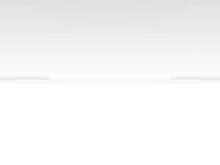

I want to model my now-defunct bathroom scales and started with the
glass pane - when viewed edge on, it should display a dark bluish green.
I used scattering media to achieve this (first attached image) but then
noticed that the media color almost disappeared when viewed against a
non-black background (second image). I tried to fix this by adding an
interior_texture (without reflection) to the material statement, but
then the media color was even less visible (third image).
What do I wrong? Should I try absorbing media instead?
See you in Khyberspace!
Yadgar

From: clipka
Subject: Re: Scattering media problem
Date: 8 Oct 2015 19:45:27
Message: <56170017$1@news.povray.org>
Am 08.10.2015 um 22:56 schrieb Jörg 'Yadgar' Bleimann:
Think physics: Why does the effect you wish to model occur in nature?
You will find that it is not due to scattering, but due to absorption.
Now this would imply that you should definitely use absorbing media
instead of scattering media: While the latter does include an
absorbtion-like component (to model the effect that part of the light is
being diverted _to_ elsewhere), it also has an emission-like component
(to model the effect that light is being diverted _from_ elsewhere)
which you don't want.
That said, note that to model uniformly absorbing interior, the
fade_colour, fade_distance and fade_power keywords provide a more
efficient mechanism.

I would use fade_colour, fade_distance and fade_power for that purpose.
A side bonus is a much faster rendering.
If you absolutely want to use some media, then, absorbing media is the
kind that you want.

Am 09.10.2015 um 08:58 schrieb Thomas de Groot:
> You certainly might. I am not sure about the physics of glass but maybe
> it is a combination of scattering and absorption you need?
Nope.
There's virtually no scattering in modern regular glass - except maybe
for some dirt on the surface, but that's obviously not some interior effect.
Ancient glass did often have impurities that would scatter light, but as
a result the material would appear misty or even opaque at reasonable
thickness (because that's what scattering ultimately does to a medium).

I concur with Clipka and Alain.  Use fade_power 1001, fade_color, and
fade_distance in the media block.  Absorbing media may be easier conceptually,
but it is slower and (in my experience) artifact prone.
Meanwhile, I tried absorption on my own (see attachmealso with bevnts),
and now it looks believable, at least to me (the glass pane now also has
bevelled edges)
Note that I multiplied the absorption color with 7, otherwise the
coloring would have turned out too faint.
Yadgar
Now I added a (yet to be detailed further) plastic frame, replaced the
absorption media by the following:
     fade_color <0, 0.6, 0.35>
     fade_power 1001
     fade_distance 0.1
...but I wonder why the plastic parts below the glass pane are black now
(see attachment)! They should be of the same light grey as the side
parts, only slightly darkened by the glass...
Yadgar

From: clipka
Date: 10 Oct 2015 23:00:57
Message: <5619d0e9$1@news.povray.org>
Am 11.10.2015 um 01:40 schrieb Jörg 'Yadgar' Bleimann:
> ....but I wonder why the plastic parts below the glass pane are black
> now (see attachment)! They should be of the same light grey as the side
Too low max_trace_level maybe?
Also, behaviour may differ depending on whether you make the glass and
plastic planes overlap, merely touch, or have a tiny gap.

From: Jörg 'Yadgar' Bleimann
Date: 11 Oct 2015 06:45:13
Message: <561a3db9$1@news.povray.org>
Hi(gh)!
Meanwhile, I increased it to 10 - but still the plastic parts below the
glass are black!
Yes, I provided for a tiny gap... but it did not help!
Yadgar
Date: 11 Oct 2015 13:17:15
Message: <561a999b$1@news.povray.org>
Am 11.10.2015 um 12:45 schrieb Jörg 'Yadgar' Bleimann:
> Hi(gh)!
> glass are black!
<shrugs>
We'll probably need more information then.
Maybe you simply got the colour wrong?
Date: 11 Oct 2015 14:50:36
Message: <561aaf7c$1@news.povray.org>
Hi(gh)!
 > <shrugs>
O.k., here is the code:

From: clipka
Date: 13 Oct 2015 03:05:50
Message: <561cad4e@news.povray.org>
Am 11.10.2015 um 20:50 schrieb Jörg 'Yadgar' Bleimann:
Looks like the gap between the frame and glass pane is too small. You
may want to use a different scale to increase your absolute scene size.
Date: 13 Oct 2015 18:01:28
Message: <561d7f38@news.povray.org>
Hi(gh)!
Yes, originally the gap was only 0.000001 POV units wide... I increased
this to 0.00016 POV units, and now it looks as it was meant to look (see
attachment)!
Yadgar
