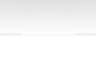

I want to model my now-defunct bathroom scales and started with the
glass pane - when viewed edge on, it should display a dark bluish green.
I used scattering media to achieve this (first attached image) but then
noticed that the media color almost disappeared when viewed against a
non-black background (second image). I tried to fix this by adding an
interior_texture (without reflection) to the material statement, but
then the media color was even less visible (third image).
What do I wrong? Should I try absorbing media instead?
See you in Khyberspace!
Yadgar

I'm not quiet sure how to fix this issue, but I think media will not
help here. Glass has no media inside. This seems to be more a issue of
refraction. The problem may be that POV cannot calculate different
refractions for different wavelenghts at once by default. IIRC there is
a work around utilising an animation and combing the results to a final
image for this issue posted by Ive (IIRC again) some time ago to
p.b.s-f. A search for "spectral rendering" should yield it (There were
more than one posting).
Best regards,
Michael

Think physics: Why does the effect you wish to model occur in nature?
You will find that it is not due to scattering, but due to absorption.
Now this would imply that you should definitely use absorbing media
instead of scattering media: While the latter does include an
absorbtion-like component (to model the effect that part of the light is
being diverted _to_ elsewhere), it also has an emission-like component
(to model the effect that light is being diverted _from_ elsewhere)
which you don't want.
That said, note that to model uniformly absorbing interior, the
fade_colour, fade_distance and fade_power keywords provide a more
efficient mechanism.
You certainly might. I am not sure about the physics of glass but maybe
it is a combination of scattering and absorption you need?

I would use fade_colour, fade_distance and fade_power for that purpose.
A side bonus is a much faster rendering.
If you absolutely want to use some media, then, absorbing media is the
kind that you want.

Am 09.10.2015 um 08:58 schrieb Thomas de Groot:
Nope.
There's virtually no scattering in modern regular glass - except maybe
for some dirt on the surface, but that's obviously not some interior effect.
Ancient glass did often have impurities that would scatter light, but as
a result the material would appear misty or even opaque at reasonable
thickness (because that's what scattering ultimately does to a medium).
