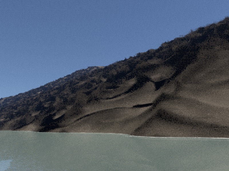

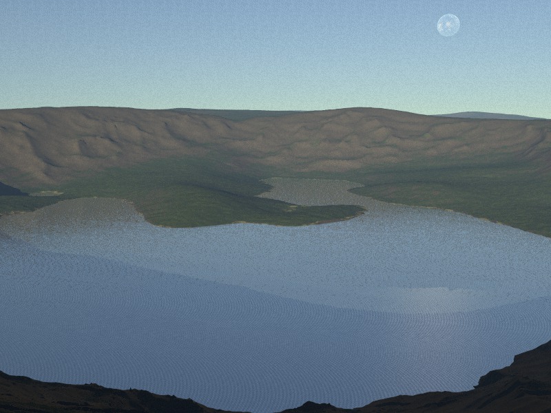

Here are some pictures of the moon.
This is the island of Jura, looking north. (Normally visible on the
north-west limb of the near side of the moon.) It's about 600km long,
making it about two-thirds the size of the British Isles.
This is a copy of a rendering I did a couple of years ago, but the main
interesting thing here is that rather than using a massive mesh for the
terrain, it's using the plugin code I posted to .general the other day
to read the data directly out of NASA PDS files (a 6GB data set!). There
should be some procedural noise overlayed on top, so it gets a bit bland
when you get up close, but it's working really well.
However, as you can see, I suck at media; the sky is dire. Last time I
made it work by brute force and ignorance, just increasing the samples
to about 30 and living with achingly long rendering times. I want to do
better this time.
(The weird stripe is an artifact of the *sky*, not the terrain. I assume
it's a sampling glitch of some kind. No idea what's going on there. To
prove it, I enclose another picture with the sky turned off, and you can
see the ocean is fine.)
My sky media is:
  media {
    method 2
    ratio 1
    samples 10
    scattering {
      RAYLEIGH_SCATTERING
      color 2.3 * Rayleigh_Colour / Atmospheric_Scale
      extinction 1
    density {
      function { Rayleigh_Density_Function(x, y, z).x }
The density function calculates atmospheric density with altitude.
Any suggestions?

From: clipka
Subject: Re: Moon rendering (prototype)
Date: 1 Oct 2015 04:08:34
Message: <560cea02$1@news.povray.org>
Am 01.10.2015 um 00:12 schrieb David Given:
> better this time.
Uh... wait - sky? ocean?
We are talking about the moon, as in, /our/ moon, right?
As for the media, for starters be advised that sampling method 2 is
generally considered the worst of all choices; depending on what you
want to achieve, you're typically better off with either method 1 or 3.
Also, when using method 3, make sure to use its adaptive sampling
feature, using "samples MIN,MAX" with low min and high max, and tweaking
aa_level and aa_threshold to your taste.
Now for the main course, the artifacts: The bad news is that whenever
your density function is non-linear, contrary to intuition you will
/always/ get banding artifacts as long as you aim for a smooth result.
You can crank up the number of samples like mad, but you will never get
rid of them entirely, and our perceptual system is very sensitive to
this type of artifacts.
The first step to solving the problem is to throw the goal of smoothness
overboard, and replace the banding artifacts with noise artifacts; even
if the total error between the ideal image and the actual output remains
the same, our eyes are much more forgiving if they can't find any
pattern in the artifacts.
Introducing noise to the sampling process can be achieved in a number of
ways; you probably only want one of them:
- Add a random element to the density function; for instance, multiply
with a function that gives a value between, say, 0.9 to 1.1, based on a
very small-scale granite pattern. Drawback: This does not play nicely
with adaptive sampling method 3.
- Use sampling method 1 with "intervals 1"; this always gives you an
entirely random distribution of media samples. Drawback: This is also
the slowest method.
- Use sampling method 3 with "intervals 1" and jitter (you may want to
be bold and try "jitter 1.0"); this will vary the distance between
sample points.
Now that you have converted your artifacts to noise, it is time to
reduce its amplitude by throwing more computing power at it; again, you
have several options:
- Possibly the easiest, grab a copy of UberPOV and use anti-aliasing
mode 3 ("+am3"); reduce the threshold parameter ("+a") if you think you
have too much noise overall; increase the confidence parameter ("+ac")
if you think you have too many stray speckles; increase the recursion
depth parameter ("+r", not actually recursion depth in mode 3, but still
governing maximum number of samples) if your results remain poor in some
regions, or reduce it if you think POV-Ray is spending an inacceptable
lot of time on some regions.
- Use standard POV-Ray with a little bit of focal blur; the effect is
about the same as UberPOV's anti-aliasing mode 3, with "variance" and
"confidence" settings taking the role of the +a and +ac parameters,
respectively. (UberPOV's "+am3" might be superior at avoiding stray
speckles though.)
- If you're using media sampling method 1, increasing the "samples"
parameter will throw more computing power directly at reducing the
noise, albeit in a less selective fashion.
- If you're using media sampling method 3, and using "jitter" to
generate the noise, possibly the most efficient way of throwing
computing power at the problem is to reduce "aa_threshold" and possibly
increase "aa_level".
From: clipka
Date: 1 Oct 2015 04:39:53
Message: <560cf159$1@news.povray.org>
Am 01.10.2015 um 10:08 schrieb clipka:
(As a side note, colour banding might even remain a problem if POV-Ray
could compute the media perfectly. In that case, banding would occur due
to colour aliasing in the output image generation. Again such artifacts
can only be avoided by replacing them with a tiny bit of noise, known as
dithering in this context.)

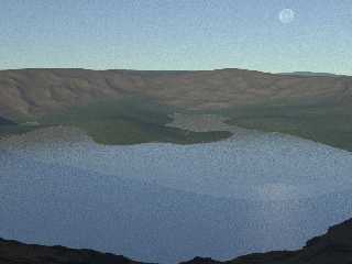

*facepalm* I forgot to mention the core feature here: the terrain is an
isosurface. So there are no polygons.
The last time I tried this was a couple of years ago, using a bespoke
tool to generate a LOD-optimised mesh based on the camera position
(using ROAM). It worked really well, but was very slow, mostly due to
I/O. Loading a 15 million mesh into Povray is a bit painful. I also have
a very neat piece of code called Propmaster that populates the terrain
with trees. The algorithm may even be novel!
See: http://cowlark.com/flooded-moon
(Sorry about the poor layout, it needs a rework.)
I enclose a couple of test renders of the mesh generation in action. You
can see that the amount of detail goes up around places that need it,
and the closer they are to the camera.
However, using an isosurface is, I believe, faster, and also means fewer

I enclose three more pictures; this is the same scene, taken from about
25km up, in twilight, dawn and daylight, respectively. They took a
drastically different amount of time to render; the daylight one was 235
seconds, while the dusk one was 1320.
These use these settings:
	method 3
	jitter 0.1
	ratio 1
	samples 3, 30
The jitter has helped with the banding, at the expense of some noise.
(The dark shadow in the dawn picture should be there; it's the planet's
shadow cast through the atmosphere. But it shouldn't be that grainy.)
Interestingly, in the dawn picture, it's the *sea* that's the expensive
bit --- presumably because of tangential rays from the sun (off to the
right). In the dusk picture, it's the atmosphere. In the daylight
picture, they're both cheap.
Unfortunately, UberPOV is largely out of the question, because I'm using
a custom patched POV anyway. (The DLL code.) So I'm going to have to
start playing with aa_level and aa_threshold, right? Although I hadn't
thought of fiddling with focal blur. I'll have to try that.
I know I can get good results by cranking up the power --- but I want to
do it *efficiently*, because my renders are slow enough as it is.
Imagine what it's going to be like after I drop a million trees onto the
landscape!

From: David Given
Date: 1 Oct 2015 19:10:20
Message: <560dbd5c$1@news.povray.org>
...incidentally, the weird stripe in the first image was, AFAICT, cause
by the bottom of the atmosphere brushing against the top of the sea.
Lowering the atmosphere a little made it go away. Very strange.

From: clipka
Date: 2 Oct 2015 16:04:24
Message: <560ee348$1@news.povray.org>
Am 02.10.2015 um 01:06 schrieb David Given:
> Oh, absolutely.
Hm... maybe you'd be faster off rendering it in a realistic fashion then ;)
JK.
Here's where one of the drawbacks of method 3 surfaces: You have to
specify an absolute threshold, but in dark regions our eyes are more
sensitive to absolute differences. So to reduce the noise there, you
also have to throw more computing power at the brighter regions where
it's not really necessary.
IIRC adaptive focal blur is based on the relative error, so that might
be a more efficient way of getting more oversampling in the darker regions.
Sounds like it's time I got me a fresh batch of round tuits and
integrated the most recent POV-Ray changes into UberPOV. I presume that
would allow you to integrate your custom patch into UberPOV as well.
The focal blur algorithm includes the best general adaptive oversampling
mechanism that is available in official POV-Ray 3.7, so the idea is to
introduce a /tiny/ bit of focal blur, in order to make that mechanism
kick in.

I'm actually having a great deal of difficulty getting the surface to
render cleanly after bolting on procedural noise; it goes all fuzzy
close up, which implies my isosurface doesn't have a well-defined
surface. (Enclosed.) I would suspect my multifractal routine, but it's
stolen from libnoise, and so should work...
So I'll stop fiddling with it and go back my old mesh code. Instead of
writing out a text file and loading into Povray I'll see if I can hack
in a dll-based callback interface, so my code can feed polygons directly
into Povray. That should be way faster.

From: clipka
Date: 2 Oct 2015 17:41:37
Message: <560efa11$1@news.povray.org>
Am 02.10.2015 um 22:54 schrieb David Given:
To me it looks fine, except that you're doing it wrong.
It looks to me like you're just perturbing your terrain function, using
something like:
    f(x,y,z) = f_terrain(f_noise(x,y,z))
when what you actually want is more like:
    f(x,y,z) = f_terrain(x,y,z)+f_detail(x,y,z)*detail_amplitude
Also note that if you just plug in some generic noise function as
f_detail, you are prone to turn your isosurface into some foam or "swiss
cheese", when all you really want is a radial offset of the surface; you
probably don't want caves, nor even overhangs.
To avoid this problem, you need to make sure that f_detail(x,y,z) is
constant along any ray from the center outward; you can achieve this by
defining f_detail as follows:
    f_detail(x,y,z) = f_detail_(x,y,z,sqrt(x*x,y*y,z*z))
    f_detail_(x,y,z,l) = f_noise(x/l,y/l,z/l)
Also, my personal suggestion is to not hard-code this into your DLL, but
rather define the detail function in POV-Ray, making use of POV-Ray's
pigment function feature and one or more of POV-Ray's noise-based
patterns (such as "bumps").

From: David Given
Date: 5 Oct 2015 19:05:14
Message: <5613022a@news.povray.org>
And here's another one (yeah, yeah, I know you're sick of these by now);
late afternoon at Kastner S, a crater on the eastern limb of the moon.
Don't believe me? Here's a Google Maps link:
https://www.google.com/maps/space/moon/@-8.0337004,85.465223,90856a,20y,270h,69.93t/data=!3m1!1e3
My procedural noise needs a *lot* of work, and there's something very
odd about the sea texture. As does the surface texture, for that matter.
Also there's supposed to be a forest down there...

From: clipka
Date: 5 Oct 2015 20:10:03
Message: <5613115b$1@news.povray.org>
Am 06.10.2015 um 00:45 schrieb David Given:
> Interestingly the slowest part of the
> process is Povray thinking about the mesh after I've passed it the data.
> Is it generating a bounding box octree? If so, it's working, because the
> rendering is amazingly fast...
That's indeed what happens (except that it's a KD-tree :))
From: clipka
Date: 5 Oct 2015 20:14:30
Message: <56131266$1@news.povray.org>
Am 06.10.2015 um 01:05 schrieb David Given:
No - actually, not at all.
I think the terrain looks gorgeous.
Waves pattern?
Moiree effect, I'd guess.
