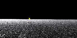

Following the little discussion in the thread Saturn's Greetings, I
started to explore the ring structure. This is a very first wip using 1
million discrete objects. Obviously, if I want to follow this approach
further, I shall need many more objects. Writing their positions (and
testing their visibility in the scene) takes most of the time. This
exercise too about half an hour. Very acceptable.
I have not taken into account the real dimensions of the ring. I should
provide for that too.

Ah yes! That is what I need in addition. Thanks! I was thinking of using
a media in combination with the ring particles but this would be much
better indeed.
Note that the particles are also traced into a ring pattern Ideally, the
isosurface should mimic that too.

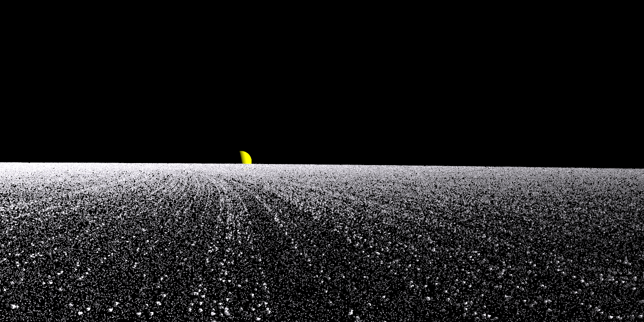

Next attempt.
Here dimensions are correct for Saturn's B-ring.  The onion pattern in
the function does not show in the fine structure. Maybe not too much of
a problem; the larger particles determine the concentric structure.

Subject: Re: Saturn Ring - a first wip
Date: 6 Jan 2015 08:17:19
Message: <54abe05f@news.povray.org>
The preceding image was rendered at a safe altitude of about 100 km
above the ring. Cautiously navigating downwards, we are here at about an
altitude of 10 km. :-)
Distance from Saturn's Centre: 100.000 km, which means still about some
17.000 km from the B-ring's edge.
Download 'complex.png' (824 KB)

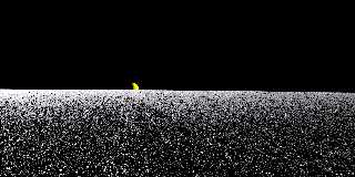

My pilot is reckless!
On our way to the rim of the B-ring, he plunged into the ring itself!
Media to simulate the sub-millimetre particles; reddish zone to indicate
where the "mountains" are going to be. Distance to there is about 500 km.
Download 'complex.png' (452 KB)

The yellow half-lit sphere looming over the rings' edge - is it meant to
be Titan? If yes, you perhaps should have chose a more orange hue...

With an unmanned probe carefully braking to adjust its speed to the
particles (which are in fact just tiny "moonlets" following Kepler's
orbital laws), such a photo should be feasible - small particles
diverted by collisions should not move faster than a few meters per
second relative to the probe and thus pose no risk, bigger ones could be
dodged automatically.
And then perhaps even do a sample return! Has anyone at NASA ever
proposed such a mission?
And for the occasional star peeking though the media: feel free to use
my customizable sky_sphere!

Regarding the isosurface function I still haven't fully figured
out how to apply a fine pattern to a coarse pattern (such as granite
structure on the crackle particles) without also generating "granite
fuzz particles". This is related to why you didn't get ring structure
on the fuzz. There is probably some smart way using min / max / select
but the things I tried didn't work as expected.
I have not delved really seriously into it either as I was concerned
with other issues that need ironing out. I shall though.
Still looking for improvements. This is the closest I could get
presently on a small scale (see image). On a large ring scale, it does
not look good/convincing at all.
Using the following code:
#declare f_particles =
function(x,y,z) {
   0.5 - f_crackle(40*x, 40*y, 40*z)
   + f_granite(x*0.1, y*0.1, z*0.1)
   - f_onion(x*10, 0, z*10)
isosurface {
   function { f_particles(x,y,z) }
   contained_by {
     box {<-0.50, -0.5, -0.5>, <0.5, 0.2, 0.5>}
   accuracy 0.0001
   max_gradient 1000
   texture {
     pigment {srgb <0.98, 0.98, 0.98>}
   translate 0.25*y
Download 'isosurface_functions_test.png' (179 KB)
Preview of image 'isosurface_functions_test.png'
Date: 11 Jan 2015 07:36:16
Message: <54b26e40@news.povray.org>
But this has better potential (see image) using as function:
function(x,y,z) {
     0.8
   - f_crackle(400*x, 400*y, 400*z)
   + f_bozo(x*100, y*100, z*100)
   - f_waves(x*100, y*10, z*100)
Download 'complex.png' (1092 KB)
Preview of image 'complex.png'
From: Christian Froeschlin
Date: 11 Jan 2015 10:56:46
Message: <54b29d3e$1@news.povray.org>
nice. you can also add some turbulence by adding a noise term
to the input parameters of the functions, e.g.
   f_waves(x*100 + f_bozo(x*100,0,0),
           y*10  + f_bozo(0,y*10,0),
           z*100 + f_bozo(0,0,z*100))
(offline sample, scaling likely way off)
From: And
Date: 12 Jan 2015 01:30:01
Message: <web.54b367c25558cbe0da787fe0@news.povray.org>
> function(x,y,z) {
> isosurface {
>    contained_by {
>    accuracy 0.0001
>    max_gradient 1000
>    texture {
>    translate 0.25*y
> Thomas
I like this. the method which combines two functions looks useful.
It seems there are a lot of techniques on building functions.
Date: 12 Jan 2015 03:19:00
Message: <54b38374$1@news.povray.org>
You should look up my Geomorph macros! ;-) The functions are so complex
that the the whole thing is hardly usable.
Date: 12 Jan 2015 03:21:04
Message: <54b383f0$1@news.povray.org>
Ah yes, thanks indeed! I wanted to add turbulence by adding another
function but that did not work correctly. This is more logical.
From: Paolo Gibellini
Date: 12 Jan 2015 05:39:58
Message: <54b3a47e$1@news.povray.org>
Thomas de Groot wrote on 11/01/2015 13.35:
> function(x,y,z) {
>      0.8
> Thomas
Nice. with a different texture could be used for a plower field too.
Paolo
Date: 12 Jan 2015 07:03:17
Message: <54b3b805@news.povray.org>
> Paolo
Yes indeed. Something to keep in mind :-)
