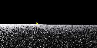

Following the little discussion in the thread Saturn's Greetings, I
started to explore the ring structure. This is a very first wip using 1
million discrete objects. Obviously, if I want to follow this approach
further, I shall need many more objects. Writing their positions (and
testing their visibility in the scene) takes most of the time. This
exercise too about half an hour. Very acceptable.
I have not taken into account the real dimensions of the ring. I should
provide for that too.

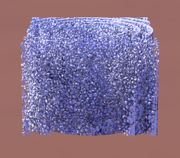

If that doesn't scale up you could try an isosurface such as
#declare f_particles = function(x,y,z)
   0.8 - f_crackle(400*x,400*y,400*z) +
   0.1 * f_granite(500*x,500*y,500*z)
isosurface
   function { f_particles(x,y,z) }
   contained_by { box {<-3,0,0>,<3,0.1,1000>} }
   accuracy 0.0001
   max_gradient 1000
   pigment {color rgb 1}
Download 'particles2_800.png' (474 KB)
Preview of image 'particles2_800.png'

Ah yes! That is what I need in addition. Thanks! I was thinking of using
a media in combination with the ring particles but this would be much
better indeed.
Note that the particles are also traced into a ring pattern Ideally, the
isosurface should mimic that too.
> better indeed.
> Thomas
Just add a wood or onion pattern to the function, or an image pattern to
get a beter control.
   0.1 * f_granite(500*x,500*y,500*z) +
   0.9 * f_onion(500*x,0,500*z)
Subject: Re: Saturn Ring - a first wip

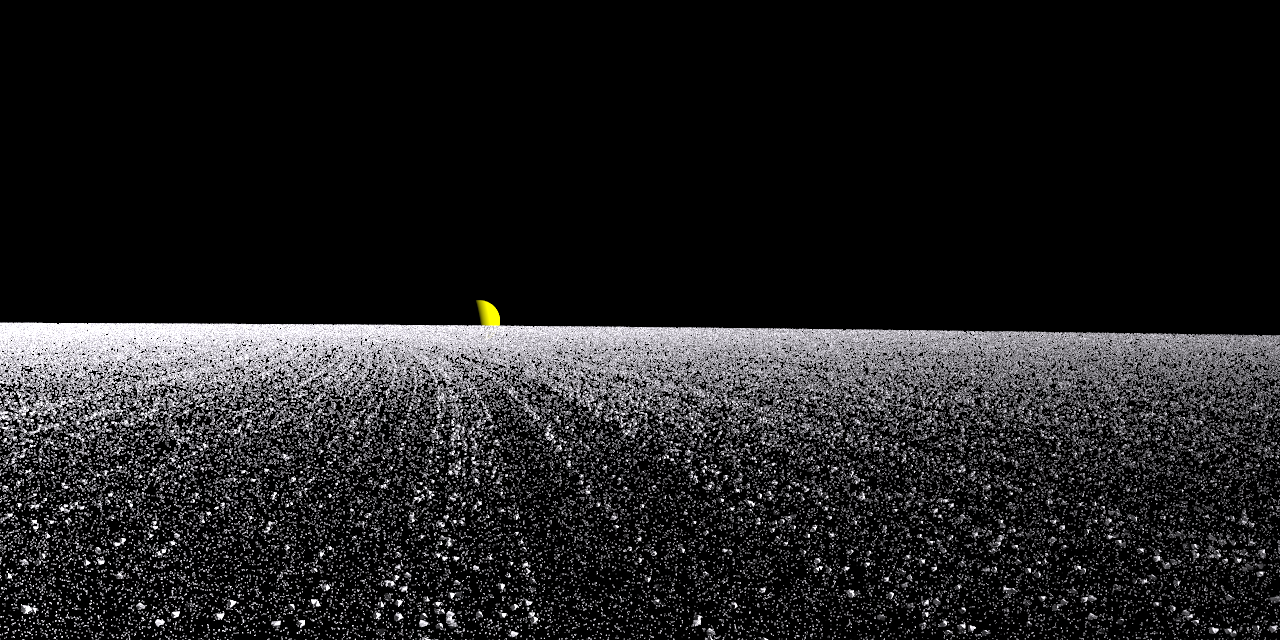

Next attempt.
Here dimensions are correct for Saturn's B-ring.  The onion pattern in
the function does not show in the fine structure. Maybe not too much of
a problem; the larger particles determine the concentric structure.

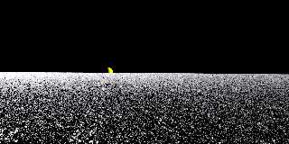

Date: 6 Jan 2015 08:17:19
Message: <54abe05f@news.povray.org>
The preceding image was rendered at a safe altitude of about 100 km
above the ring. Cautiously navigating downwards, we are here at about an
altitude of 10 km. :-)
Distance from Saturn's Centre: 100.000 km, which means still about some
17.000 km from the B-ring's edge.

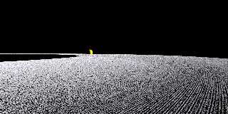

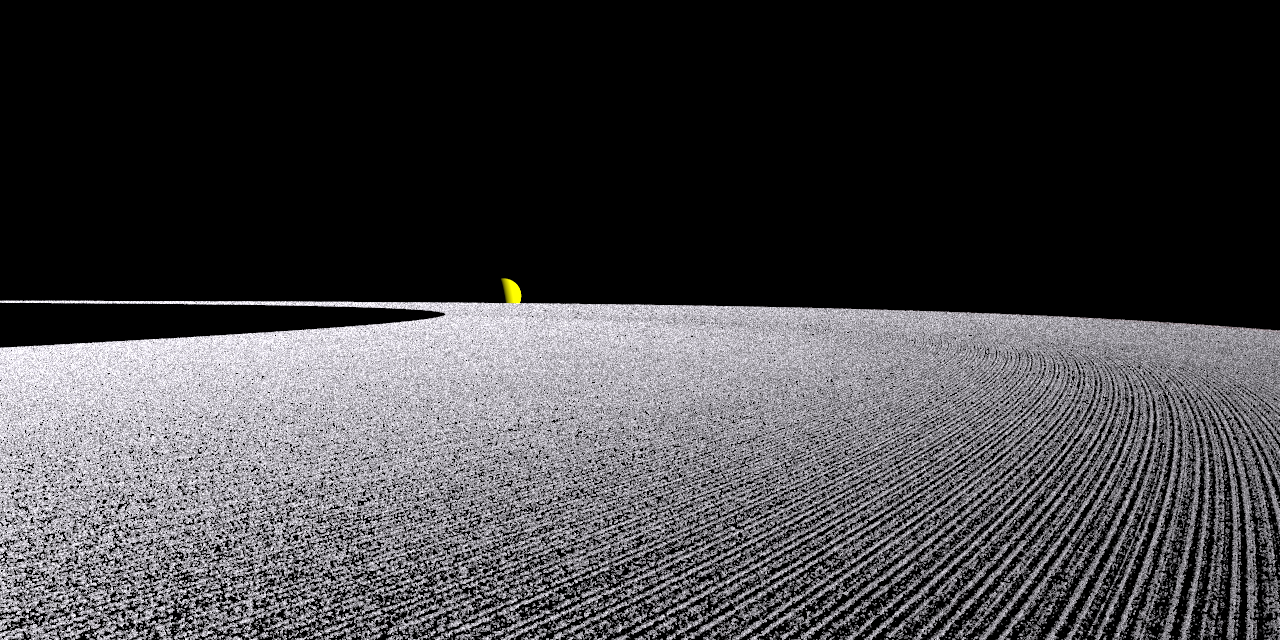

Message: <54ac057f@news.povray.org>
My pilot is reckless!
On our way to the rim of the B-ring, he plunged into the ring itself!
Media to simulate the sub-millimetre particles; reddish zone to indicate
where the "mountains" are going to be. Distance to there is about 500 km.
Download 'complex.png' (452 KB)
Preview of image 'complex.png'
From: Stephen
Date: 6 Jan 2015 11:21:58
Message: <54ac0ba6$1@news.povray.org>
Give him a copy of Elite Dangerous. :-)
This could be a screenshot albeit of a different quality.
Regards
     Stephen
From: Jörg 'Yadgar' Bleimann
Date: 6 Jan 2015 11:34:13
Message: <54ac0e85$1@news.povray.org>
Hi(gh)!
On 06.01.2015 12:51, Thomas de Groot wrote:
> Next attempt.
The yellow half-lit sphere looming over the rings' edge - is it meant to
be Titan? If yes, you perhaps should have chose a more orange hue...

> out how to apply a fine pattern to a coarse pattern (such as granite
> structure on the crackle particles) without also generating "granite
> fuzz particles". This is related to why you didn't get ring structure
> on the fuzz. There is probably some smart way using min / max / select
> but the things I tried didn't work as expected.
Still looking for improvements. This is the closest I could get
presently on a small scale (see image). On a large ring scale, it does
not look good/convincing at all.
Using the following code:
function(x,y,z) {
   0.5 - f_crackle(40*x, 40*y, 40*z)
   + f_granite(x*0.1, y*0.1, z*0.1)
   - f_onion(x*10, 0, z*10)
isosurface {
   contained_by {
     box {<-0.50, -0.5, -0.5>, <0.5, 0.2, 0.5>}
   accuracy 0.0001
   max_gradient 1000
   texture {
     pigment {srgb <0.98, 0.98, 0.98>}
   translate 0.25*y
Download 'isosurface_functions_test.png' (179 KB)
Preview of image 'isosurface_functions_test.png'

But this has better potential (see image) using as function:
function(x,y,z) {
     0.8
   - f_crackle(400*x, 400*y, 400*z)
   + f_bozo(x*100, y*100, z*100)
   - f_waves(x*100, y*10, z*100)
Download 'complex.png' (1092 KB)
nice. you can also add some turbulence by adding a noise term
to the input parameters of the functions, e.g.
   f_waves(x*100 + f_bozo(x*100,0,0),
           y*10  + f_bozo(0,y*10,0),
           z*100 + f_bozo(0,0,z*100))
(offline sample, scaling likely way off)

Ah yes, thanks indeed! I wanted to add turbulence by adding another
function but that did not work correctly. This is more logical.
