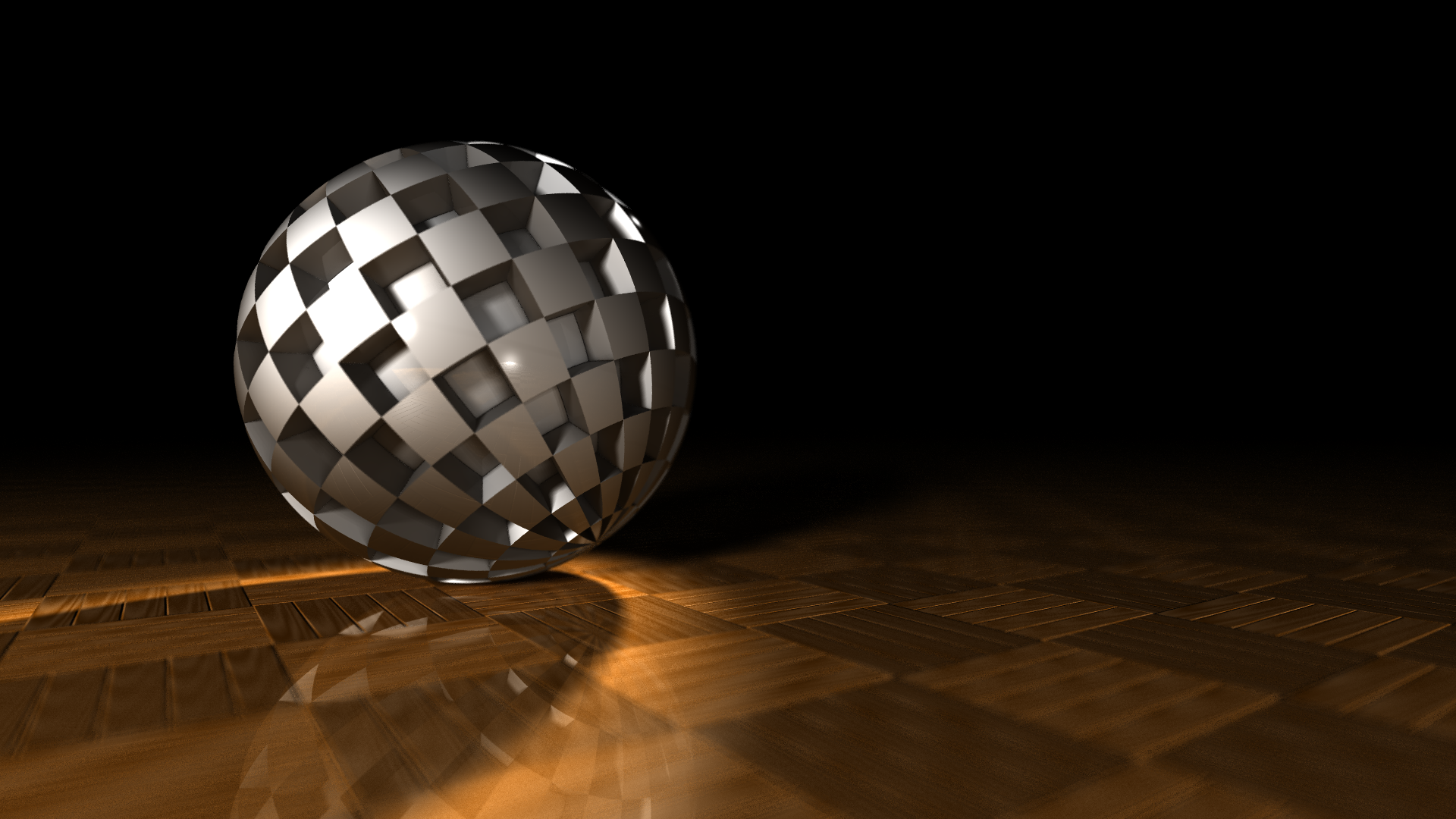

Part of a series of renderings I'm doing for my desktop backgrounds on
my work computer.
err.. rather an isosurface.
The checkering of the sphere was actually a pretty simple function
(using the contained_by shape to define the sphere.)
function {(sin(f_th(x,y,z)*13) * sin(f_ph(x,y,z)*13) * sin(f_r(x,y,z)*15))}
The isosurface is then rotated to the proper orientation. :)

From: Nekar Xenos
Subject: Re: A sphere over a checkered plane
Date: 10 Nov 2014 14:34:23
Message: <op.xo4jbkfrufxv4h@xena.home>
Beautiful

From: MichaelJF
Date: 10 Nov 2014 15:50:01
Message: <web.546124f2a4acebb07b7e0b710@news.povray.org>
> my work computer.
Nice work! You should consider an entry at www.cgsphere.com, but you have to
change the scene a bit due to their conditions.
Best regards,
Michael
From: s day
Date: 10 Nov 2014 18:45:00
Message: <web.54614ccfa4acebb0a47478650@news.povray.org>
> my work computer.
Great image, and a good choice for a desktop background. Aside from the very
interesting sphere the floor also looks great.
Sean

Nice work indeed. I take note of the function ;-)
From: Raiford, Michael
Date: 11 Nov 2014 07:09:07
Message: <5461fc63$1@news.povray.org>
>> my work computer.
> Best regards,
> Michael
Hmm... I might just have to give this a go as a submission. I've gotta
work the parquet floor in somehow, though ...
