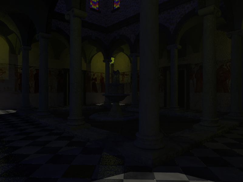

In parallel with Urbex, I am working now on a scene using an old model I
have had for ages: the 3ds Cloister model from Pieve di Cadore in
Northern Italy, modelled by Adriano del Fabbro in 1997.
In the past, I have used little elements from the model in other scenes;
this is the first time I fully work with it. I am busy making some
changes, some additions, but overall this is what the cloister looks
like now.
Download 'silentium.png' (453 KB)
Preview of image 'silentium.png'

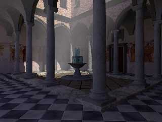

After a week of hard work, the next wip.
Download 'silentium_04.png' (547 KB)
Preview of image 'silentium_04.png'

   Nice improvements: the textures are way better. But I see something
weird with the checkered floor: looks like if the normal doesn't matches
the lighting. Also, the gap between tiles on the inside floor looks like
too big.
   Oh, and that nice cluster is really begging for a more dramatic
lighting (I think Radiosity_OutdoorHQ from rad_def.inc will do the job).
Jaime

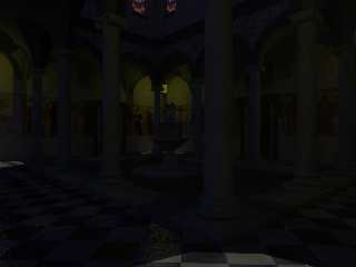

I have been wondering about that too. Only light source is the Sun,
shining directly into the cloister, and reflected from the outside on
the left side of the image, which is open to a garden in my model. The
normals seem indeed strange. The bump map is a blurred b/w image where
black is the gap + bevelling of the tiles and white the tiles
themselves; bump_size=10.
It seems counter-intuitive to me, but inverting the bump_size seems to
give the correct result (see image). Somehow, this is the inverse of
what I /read/ or /understand/ from what is said in Poseray.
> too big.
That is right. At first I interpreted it as a extra decoration, but
better would be to reduce the gap.
I'll try that indeed.
Download 'silentium.png' (546 KB)
> to give the correct result (see image). Somehow, this is the inverse
> of what I /read/ or /understand/ from what is said in Poseray.
   I remembered now that this happened to me once, and the problem was
that the mesh was inverted... maybe that's the case?
jaime

No, the true problem is that POV-Ray has been doing bump maps wrong for
ages, and it's somewhat random whether a positive or negative bump_size
gives you the desired results... or neither of them: There are cases
where the bumps look like the light would be coming from 90 degrees off
the true light direction.
This isn't trivial to fix, and although it kind of has been the first
item on my todo list ever, this probably requires some custom-tooled
heavy duty mil-spec tuits.

Subject: Re: Silentium new Wip
Date: 29 Aug 2014 07:23:08
Message: <5400629c@news.povray.org>
While Stephen and Christoph are fighting their way through the galaxy, I
have been quietly busy honing my scene.
A larger render this time the better to spot weak points.
Download 'silentium_08.jpg' (278 KB)
Preview of image 'silentium_08.jpg'
From: Stephen
Date: 29 Aug 2014 09:37:11
Message: <54008207$1@news.povray.org>
No. I've taken a leaf out of the Dutch book and am trading my way to
world domination. ;-)
I never been able to create a believable tiled floor with normals.
Regards
     Stephen
From: clipka
Date: 29 Aug 2014 09:54:36
Message: <5400861c$1@news.povray.org>
Am 29.08.2014 15:37, schrieb Stephen:
The various tiling patterns really help with this.
Date: 29 Aug 2014 10:16:02
Message: <54008b22$1@news.povray.org>
Which this is not ;-)
Date: 31 Aug 2014 07:11:55
Message: <540302fb@news.povray.org>
...and at night.
Download 'silentium_10.png' (393 KB)
Preview of image 'silentium_10.png'
