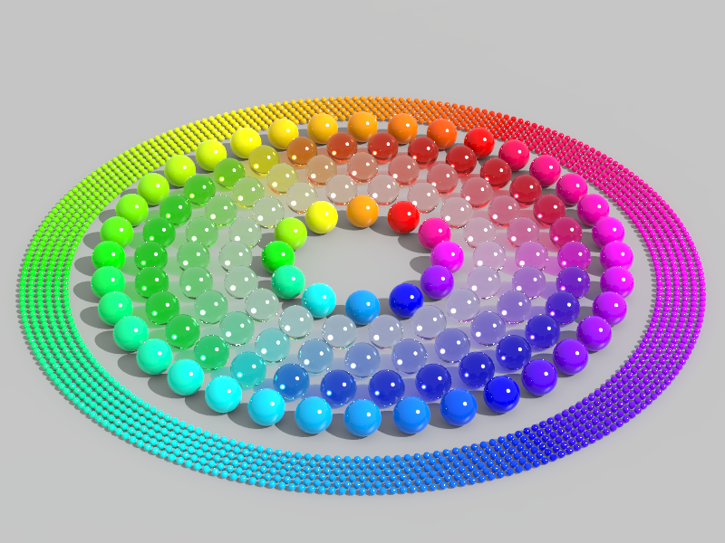

Fully-saturated RGB colours, shown on both opaque and transparent
spheres (the latter using fade_colour with varying fade_distance). Note
the strong shift towards the primary hues in the first image as
fade_distance decreases.

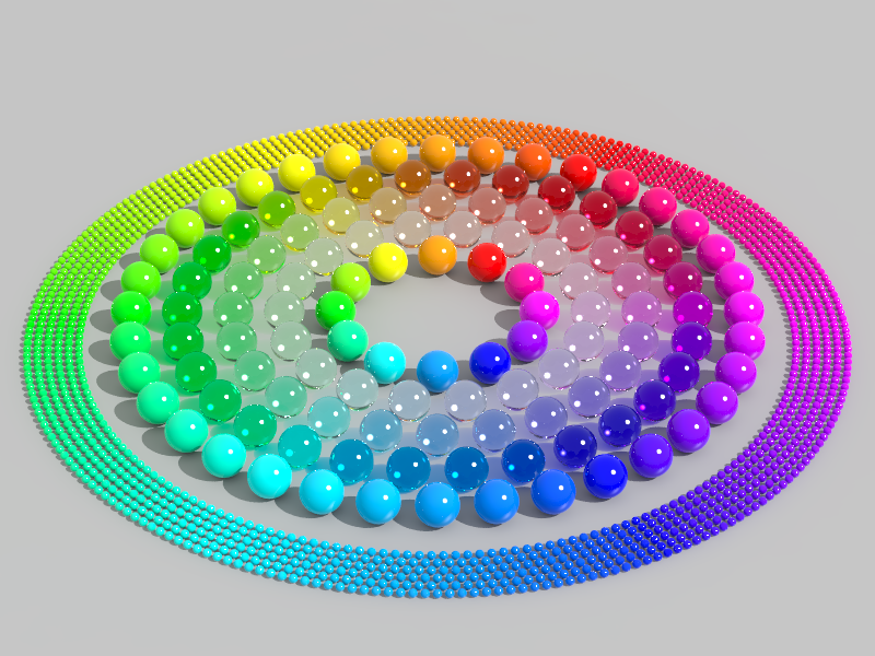

Second image shows the results of a 16-channel spectral rendering, using
automatic generation of absorption spectra to match the RGB colours.
Note how the shift towards the RGB primaries is somewhat lessened
especially in the warm yellows and the blue-to-cyan range. The greens
and purples don't seem to benefit that much; I guess some tweaking of
the spectrum generation might help there.
What sort of algorithm are you using?  What do the spectral curves look like?

From: clipka
Subject: Re: Going spectral
Date: 5 Aug 2014 02:23:48
Message: <53e07874@news.povray.org>
Am 05.08.2014 06:35, schrieb Cousin Ricky:
The run-time algorithm is pretty simple:
- If the colour is meant for a light source (or "emission" statement or
similar), convert to HSV, then look up & interpolate from a precomputed
table based on H and S for some standard V, and multiply to achieve the
desired V.
- Otherwise, convert to HSV, then look up & interpolate from a
precomputed table based on H, S and V. The resulting colour may be a bit
off (especially since for extreme S and/or V the precomputed table only
contains the nearest physically realistic colour), which is compensated
for by transforming the result to RGB, computing the difference to the
desired colour, feeding that difference into the algorithm intended for
light sources, and adding the result.
As for creating the lookup tables in the first place, that's a somewhat
kludgy iterative process, so it's poorly suited for SDL use. The
essentials are as follows:
1. Pick an initial guess. A grey will do.
2. Compute the mismatch between the guess and the target in some
arbitrary linear colour space (e.g. XYZ or RGB; I'm currently using the
latter).
3. Tweak all channels according to how well their nominal contribution
agrees with the mismatch; I'm using the dot in colour space as a basis
for this.
4. Tweak the colour to peak as high as the target colour. (E.g. for a
<1,0.5,0> orange you want some orange-ish channel to reach a value of
1.0. I'm using a simple uniform scale of all channels for this purpose.)
5. Trim all channels to the range from 0.0 to 1.0.
6. Repeat from Step 2 until happy or bored.
(The actual implementation also accounts for whitepoint issues, which is
neglected in the description above.)
Actually I don't even know yet. I've had a few glimpses at the raw data
of selected precomputed spectra, but I've yet to figure a way to
actually visualize them.
> Will there be some interface between the channels and the user?
Certainly, in the sense that the user will be able to specify their own
custom spectral curves.
To avoid various cans of worms I probably won't provide any interface
for accessing the RGB equivalent of a given spectrum, nor the
auto-generated spectrum for a given RGB colour.
I guess I'll use a spline- and/or function-based syntax for
user-specified spectra.
