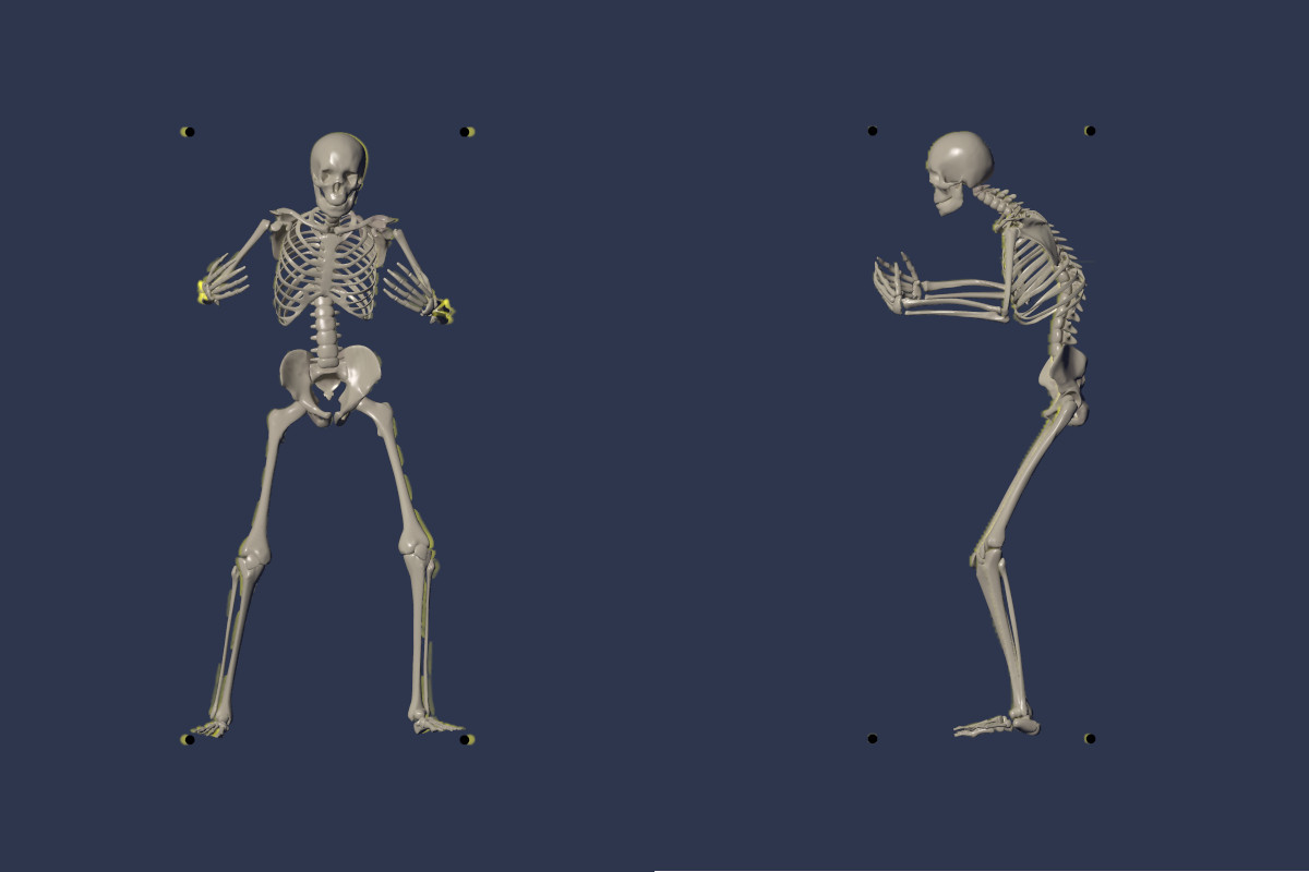

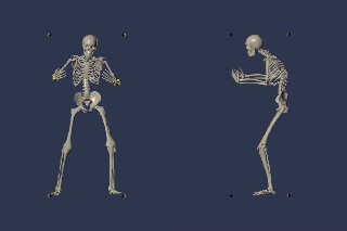

Now, how would you explain this?
I turned the models 90 degrees: we are looking along the x-axis of the
object to visualize.
Download 'gt_df3_test.png' (108 KB) Download 'makedf3object_.png' (40 KB)
Preview of image 'gt_df3_test.png'
Preview of image 'makedf3object_.png'

what is strange ?
The df3 describes a unit-cube, with distinct resolution along each axis,
but it is only a unit-cube.
So, with such model, you need a scale around 3 or so along the vertical
axis on the field to restore the kind of posture you had on the original.
Or did I missed again some red circle ?

Well, /that/ is exactly what I am wondering. Does the df3 /always/ scale
to the unit-sized box? whatever the bounding box of the object is? I
probably missed something but I do not remember having read this anywhere.
That puts my earlier observation of squeezing into another light...
No, more probably along the z-axis as that is visibly stretched out.
<grin> no.

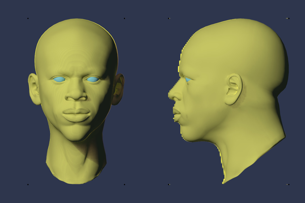

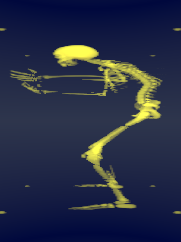

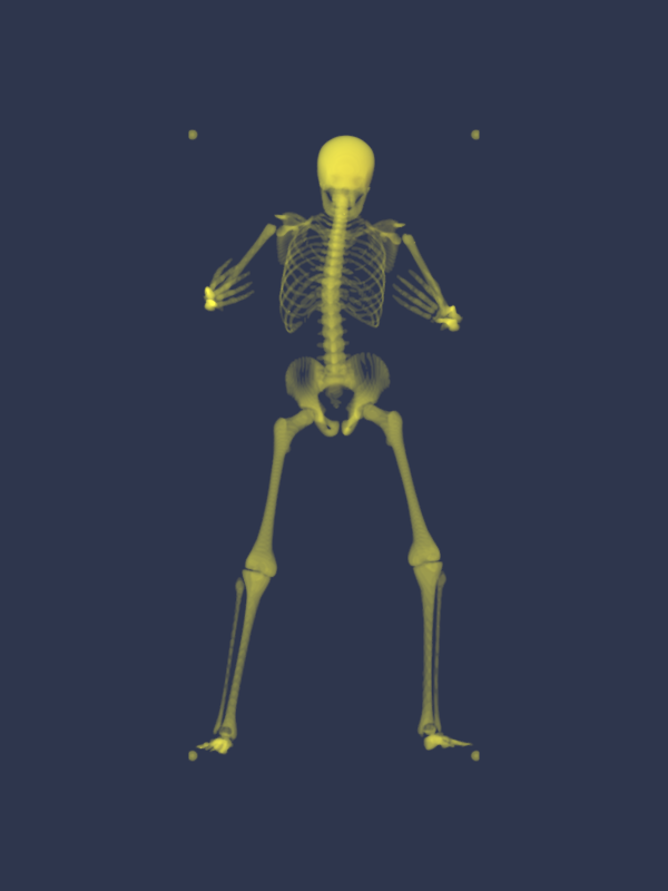

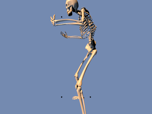

There is still something that I do not understand.
I have now scaled back the df3 files, using for a defined object Obj:
#local Min   = min_extent(Obj);
#local Max   = max_extent(Obj);
#local Size  = Max-Min;
Superposing the object and the df3 files, flipping the df3 files along y
(Gilles Tran), and resizing the df3 files, I note the following:
1) the x-axis needs also to be flipped! Visible especially with
asymmetrical objects (skeleton)
2) the skeleton df3 needs an additional x-axis scale correction: scale
<-3.0,-1,1>*Size
3) the head df3 needs a /different/ x-axis scale correction: scale
<-2.3,-1,1>*Size
The two images show orthographic views.
Question: If the df3 are made to a unit-sized box, why does the x-axis
need a correction different from object to object?
Download 'gt_df3_test_1.jpg' (54 KB) Download 'gt_df3_test_2.jpg' (73 KB)
Preview of image 'gt_df3_test_1.jpg'
Preview of image 'gt_df3_test_2.jpg'

A tentative answer to the question:
Could it be that the image format in which the tga slices are rendered
influences the final result? In other words, should objects be rendered
using a /square/ image format (1:1 ratio) in the first place? I blindly
followed Gilles Tran's advice to use a 1.33 ratio. This might be
irrelevant for clouds but not for other objects...

Do we have the sources of tga2df3 ?
From: Le Forgeron
Subject: Re: df3 strangeness
Date: 29 Sep 2013 09:46:46
Message: <52482f46@news.povray.org>
Le 29/09/2013 14:38, Le_Forgeron nous fit lire :
> Le 29/09/2013 14:27, Thomas de Groot nous fit lire :
>> Thomas
Oki, found in groups a source of tga2df3... it might be time to get
something like png2df3 because the expected tga format is rather limited
and unchecked: targa true color, 8 bits per channel, no alpha, and only
version 1
The pictures are processed as z (the further frame, the deeper),
top left/ top right to bottom right become <0,0>/<0,1> to <1,1> (hence
the -1 factor needed on y in scale for scene)
All pictures must be the same size, but ratio is irrelevant: the
resolution of the picture is transposed to the x,y resolution (or rather
precision) of the df3 file.
The pattern itself consider only the <0,0,0> to <1,1,1> cube, then
computes the cell(s) to use by applying the df3 resolution to get the
indexes on each axis. (some interpolation might wrap as an hypertorus on
the border of the cube: left side is connected to right side, top with
bottom and front with rear, for trilenear interpolation only)
What remains could be the sampling applied on the pattern.

Something else which I just discovered by chance. Scaling the container
in which the media is put to the original object's bounding box, reduces
dramatically the number of samples needed. Initially, I used a standard
box{-1,1} and needed at least 300 to 400 samples for the skeleton. Now I
used box{Min,Max translate Center} and only need 50 samples!
Download 'gt_df3_test.png' (58 KB)
From: William F Pokorny
Date: 30 Sep 2013 06:52:04
Message: <524957d4$1@news.povray.org>
On 09/30/2013 04:00 AM, Thomas de Groot wrote:
Makes sense, but I'd not thought to do it. Thanks for the tip.
Bill P.
Date: 30 Sep 2013 07:15:19
Message: <52495d47$1@news.povray.org>
Neither did I think of the implications. It came to me that reducing the
container to its bare minimum might help reduce render time but I had
not thought about the impact on the samples.
