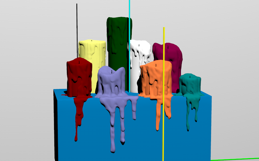

From: James Holsenback
Subject: Re: Continuing Blender-PovRay discussion
Date: 28 May 2013 08:48:13
Message: <51a4a78d@news.povray.org>
On 05/28/2013 05:11 AM, James Holsenback wrote:
> it /seems/ to be with how the object was built.
well now i'm not so sure about that anymore ... curious i did some
slightly more than casual tests. i'm starting to think it's how poseray
is exporting or how povray is parsing. the images are appropriately
titled, and the orientation problem doesn’t show up until i render the
output from poseray.

From: Stephen
Date: 28 May 2013 09:03:00
Message: <51a4ab04$1@news.povray.org>
It's not something silly like PoseRay's default export handiness is
Right handiness?
I generally only export the geometry and change the handiness to Left
handiness (PovRay default).
Regards
     Stephen
Date: 28 May 2013 09:39:59
Message: <51a4b3af$1@news.povray.org>
> Right handiness?
nope ... on the input tab reorient 3ds and dfx models is checked if
that's what you're talking about. i do however see flip options in
groups tab
From: Stephen
Date: 28 May 2013 10:01:22
Message: <51a4b8b2@news.povray.org>
On 28/05/2013 2:39 PM, James Holsenback wrote:
> i do however see flip options in groups tab
No, it is in the PovRay Output tab.
World axis orientation, again PoseRay scene (Right handiness)
I use PoseRay 3.12.2 as that is the highest version that Bishop3D will
import.
Regards
     Stephen
Date: 28 May 2013 10:11:45
Message: <51a4bb21$1@news.povray.org>
> groups tab
Yep. Typically a world orientation choice in Poseray's POV-Ray Output,
like Stephen said, right-handed vs left-handed. Same in latest versions
of Poseray.
