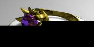

There seems to be a problem using sslt with area lights ...
The first image is after 24hrs render time, it has photons, sslt and
area light.
The 2nd image has same settings, with the exception of sslt turned off.
The photon map was loaded using the data generated from the 1st image.
The 3rd image was just with sslt (no area light, no photons) ... I ran
it only long enough to see the beginnings of the sslt effect.
The 4th image is with sslt and area light (no photons)
Download 'phandsslt.png' (78 KB) Download 'phonly.png' (89 KB) Download 'ssltonly.png' (89 KB) Download 'ssltandarea.png' (26 KB)
Preview of image 'phandsslt.png'
Preview of image 'phonly.png'
Preview of image 'ssltonly.png'
Preview of image 'ssltandarea.png'
From: clipka
Subject: Re: sslt and area light
Date: 7 Mar 2013 10:19:49
Message: <5138b015$1@news.povray.org>
Am 07.03.2013 15:47, schrieb James Holsenback:
> area light.
What settings are you using? (Size of the object, mm_per_unit setting,
subsurface translucency setting, ior, distance and parameters of the
light source)

From: James Holsenback
Date: 7 Mar 2013 11:11:20
Message: <5138bc28$1@news.povray.org>
On 03/07/2013 10:19 AM, clipka wrote:

From: clipka
Date: 8 Mar 2013 03:16:01
Message: <51399e41@news.povray.org>
With your settings to start with, I've managed to reproduce the problem.
It looks like it is a combination of three factors:
- area_illumination
- fade_distance & fade_power
- subsurface
Apparently the area_illumination code fails to respect the fade_distance
& fade_power settings when computing illumination for subsurface
scattering materials.

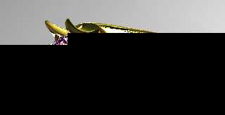

From: clipka
Date: 8 Mar 2013 04:00:12
Message: <5139a89c@news.povray.org>
Jim, you may want to test-drive change #5846.
Date: 8 Mar 2013 08:39:33
Message: <5139ea15$1@news.povray.org>
the bloom problem looks like it's fixed ... i'm anxious to see if the
photons show up properly on the subsurface area under the stone.
From: clipka
Date: 8 Mar 2013 09:37:34
Message: <5139f7ae$1@news.povray.org>
Am 08.03.2013 14:39, schrieb James Holsenback:
I'd be rather surprised - I don't recall having integrated photons with
subsurface scattering yet. But it's been a while, so let's just wait and
see...
Date: 8 Mar 2013 12:59:18
Message: <513a26f6@news.povray.org>
> see...
Your suspicion is correct ... besides some blending issues with the
gradient on the base and some tweaking with the area light (all on my
end) I'd say the bloom issue has been laid to rest. Should I log a
fly-spray reminder concerning photon/subsurface integration?
Download 'work.png' (311 KB)
Preview of image 'work.png'
From: clipka
Date: 8 Mar 2013 13:27:07
Message: <513a2d7b@news.povray.org>
Am 08.03.2013 18:58, schrieb James Holsenback:
>> see...
Don't - I'd close it right away as a duplicate of FS#6 :-P

base (subsurface) with the shadow on the ground plane (area light) ...
Just for the heck of it I ditched the area light from the back light
(fill light never was an area light), and added subsurface to the ground
plane. It /used/ to be a zero thickness box. The first run just sat
there and crunched for what seemed too long before it started the
preview, so I trimmed down the size of the box and gave it some
thickness (same as base). Interesting how some of the filtered light
from the stone made it into the subsurface on the base and ground plane
(no photons)
Download 'work.png' (536 KB)
