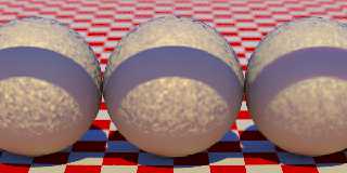

Just figured out how to integrate bump-mapping into SSLT:
Download 'sslt_bumps.png' (420 KB)
Preview of image 'sslt_bumps.png'

Am 08.01.2013 05:44, schrieb clipka:
I guess I should mention that this, once again, is a patch to POV-Ray.
(Not scheduled for 3.7.0, unfortunately.)

What do the various spheres represent? various scattering amounts?
I don't really see any bumpy surface in the part receiving more light,Maybe the
picture is too small. I do see scattering occur, but this is already the case in
current version, maybe the fact that there is normal perturbation at grazing
angle is what you mean? would it be possible to see it with less fresnell
falloff, so that the actuel lit part gets some normal bumps?
I would love to try it for character skins (but i'm patient). Maybe this means
that slope effect could be used for some peach fuzz as well?

Am 15.01.2013 16:58, schrieb Mr:
Yes. Leftmost one is without subsurface scattering.
I'm afraid I don't know what you're /not/ seeing there. The spheres
obviously don't look perfectly smooth, do they?
I guess it's the particular shader or lighting context, then: it just looked to
me as if the bright part with SSS was like media rather than a surface finish,
as if specularity was interrupted in that area. Then again it's probably
accurate, sorry. I have a few more question that I hope can be related:
-will this solve the problem of bright edges with SSLT giving characters a
wireframed edge? (maybe by allowing SSLT to really consider smooth a meshe's
edge when its normals are specified as such)
-Will the modifications allow to do some UVmapped tangeant normal perturbations?
(maybe using the slope map with a syntax to say that channels RGB corresponds to
XYZ/UVW)

Am 18.01.2013 15:03, schrieb Mr:
Not directly; but while working on the bump-mapping support, I also
tackled the related problem of those bright wireframe edges. (See my
latest posts in the "Young Teens 5" thread for a sample.)
> XYZ/UVW)
No. Such a feature is on my to-do list, but I haven't tackled it yet.
