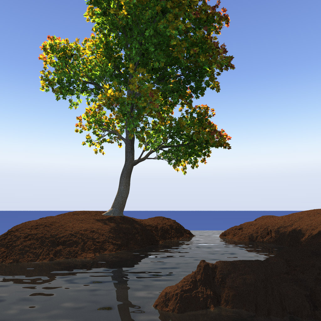

In between projects, time to experiment with a couple of things.
In March 2012, Norbert Kern explained how to make believable fall trees:
http://news.povray.org/povray.binaries.images/thread/%3Cweb.4f624250b5209546dc4ffc880@news.povray.org%3E/
Not using megapov, I took some of his suggestions and worked instead on
POVtree meshes, using a spherical texture to simulate the fall colours.
The present image (in my tree testing environment) is a credible result
I guess.
The use of this texture needs some careful tweaking in terms of scale
and translation, and also a strong warp turbulence to make a more random
distribution.
The following code is used, with the POVtree terminology:
//start code
#declare LAUB =
texture {
   spherical
   texture_map {
     [0.45 BOZO1]
     [0.55 BOZO2]
   scale 1015.11115	//scale according to POVtree output
   scale 1/50
   warp {turbulence 10}	//change according to need
   scale 50
   scale <0.5, 1, 0.5>*1	//change according to need
   translate 250.0*y	//change according to need and/or POVtree scale above
//end code
Download 'povtree_test.png' (206 KB)
Preview of image 'povtree_test.png'

Thanks Michael! Yellow leaves should not be too difficult in the present
configuration: just an intermediate pigment between green and red, and
some more tweaking on the texture_map. I have only explored a little of
the uv-mapping part of POVtree and that is where I want to try this
technique out too, one way or another. For instanc,e I was thinking
about layering the colours over the leaf image_maps, although that might
give unexpected results.
I am not too familiar with arbaro although it is gathering dust
somewhere on my HD ;-) For each application the approach might be different.

On 8-12-2012 18:06, MichaelJF wrote:
> Wonderful work. My first idea of a slight improvement is to have some yellowish
> leafs between the green and the brown ones, since most green leafs are turning
> yellow before turning red or brown.
Something like this.

That's all right. I have continued my investigations a bit:
Problem: POVtree does not export to mesh{} with uv-mapped leaves. There
is a bug in the program. A pity Gena disappeared from the web. :-( so my
idea to experiment with that comes to naught.
I am looking into Arbaro right now.
From: Norbert Kern
Subject: Re: Coloured leaves revisited
Date: 12 Dec 2012 15:20:00
Message: <web.50c8e63f6bb1705593fb87860@news.povray.org>
wn ones, since most green leafs are turning yellow before turning red or brown.
A wunderful approach to use the trick (not easy in reality).
I used 3 colors for mư main tree. In fact, after this wip I decided to go
further, otherwise it would've ended like so much other trials and errors...
Good luck for you,
Norbert
From: Norbert Kern
Date: 12 Dec 2012 15:25:02
Message: <web.50c8e7726bb1705593fb87860@news.povray.org>
 her the image...
Download 'early wip.jpg' (350 KB)
Preview of image 'early wip.jpg'
Date: 13 Dec 2012 03:13:39
Message: <50c98e33@news.povray.org>
>   her the image...
Yes, this is looking quite perfect to me.
I have not yet found a good way (for me) to tackle the uv-mapped
image_map leaves.I am investigating.

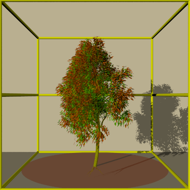

Date: 14 Dec 2012 08:09:07
Message: <50cb24f3@news.povray.org>
Using my simple spherical technique seems not to be so straightforward
as I initially thought.
Here I use it on a modified Arbaro tree with wider spaced branches. The
result is less than natural looking to me, although pretty.
Download 'povtree_test.png' (362 KB)
