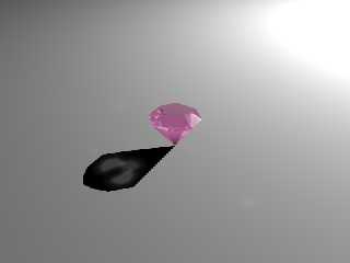

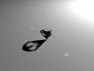

After /still/ having problems my amethyst ring I decided to isolate just
the stone and I think I've uncovered another bug. It appears that
filtered transparency isn't working with photons.
In the first image you can see the photons when I have srgbt <0.4980,
0.2902, 0.4235,1> in the material definition, and the second image the
photons aren't showing up when I have srgbf <0.4980, 0.2902, 0.4235,1>
in the material definition: that is the ONLY difference is srgbt then srgbf
The scene file is posted in p.b.scene-files
Download 'p_test1.png' (67 KB) Download 'p_test2.png' (44 KB)
Preview of image 'p_test1.png'
Preview of image 'p_test2.png'
From: clipka
Subject: Re: Another Photon Bug?
Date: 23 Sep 2012 09:34:33
Message: <505f0fe9@news.povray.org>
Am 23.09.2012 14:45, schrieb James Holsenback:
That's a negative. Here's an enhanced version of your image, showing
that photons /are/ at work.
Try using solely fade interior for the color; it's more realistic anyway.
Download 'p_test2_enhanced.png' (36 KB)
Preview of image 'p_test2_enhanced.png'

> Note that I do usually use 1cm = 1 POV-Unit and in this case
> fade_distance 1 works pretty well. You have scaled your gem much
> bigger so you have to adjust fade_distance to fit your scale.
> Attached is a quick lo-quality (90 seconds) preview render - not a
> spectral one - featuring your stone: from left to right emerald,
> sapphire and amethyst.
> -Ive

Err, sorry, this was out of my head and has the usual bugs. It should be
like this:
#macro M_Gem (Color, IOR, FadeDist)
    material {
      texture {
        pigment {Color filter 1}
        finish {
          ambient 0  emission 0  diffuse 0
           reflection {0 1 fresnel on} conserve_energy
      interior {
        ior IOR
        fade_power 1001
        fade_distance FadeDist
        fade_color rgb < pow(Color.red,3),
                         pow(Color.green,3)
                         pow(Color.blue,3) >
#end
Hopefully this time I've got it right ;)
And BTW the rgb (not srgb !!! because the power of 3 would give wrong
results) values I did use for the picture are
Emerald:  rgb < 0.7276, 0.9320, 0.8543>
Sapphire: rgb <-0.0044, 0.3702, 0.7609>
Amethyst: rgb < 0.8981, 0.8441, 0.8972>
and are calculated from the absorption spectral data. And yes, the red
components for the Sapphire is negative, it is an out-of-gamut value.
> Wow ... thanks for the macro and all the advise. I really appreciate it!
Glad to be of help and again, sorry for the errors in the macro.
-Ive
