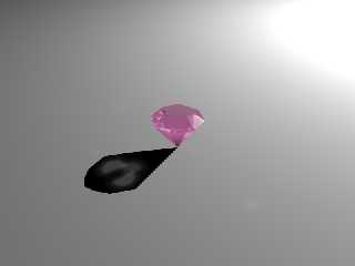

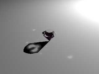

After /still/ having problems my amethyst ring I decided to isolate just
the stone and I think I've uncovered another bug. It appears that
filtered transparency isn't working with photons.
In the first image you can see the photons when I have srgbt <0.4980,
0.2902, 0.4235,1> in the material definition, and the second image the
photons aren't showing up when I have srgbf <0.4980, 0.2902, 0.4235,1>
in the material definition: that is the ONLY difference is srgbt then srgbf
The scene file is posted in p.b.scene-files

That's a negative. Here's an enhanced version of your image, showing
that photons /are/ at work.
Try using solely fade interior for the color; it's more realistic anyway.
Download 'p_test2_enhanced.png' (36 KB)
Preview of image 'p_test2_enhanced.png'
