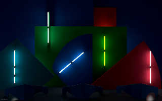

Based on the stage design by art director Yukimasa Okumura for the YMO
performance in 1981.
I used an aged video tape (recorded from Japanese TV) as reference but
have actually seen them life at Budokan in 1983 ;)
This image is basically the result of experimenting with Adobe-RGB (and
it's wider gamut compared to sRGB) as working color space for rendering
within POV-Ray. As my monitor fully covers the Adobe-RGB gamut I can
visually design the colors and push them to the limits.
The interesting and surprising thing is: I do even get more vibrant
colors and a better preservation of subtle texture details when
rendering within Adobe-RGB and converting the final image to sRGB (by
using ICC profiles) compared to defining the colors already within sRGB
and rendering within sRGB. This was something that I did not expect and
after having rechecked my color management pipeline I think that indeed
the diffuse radiosity bounces do produce more vibrant and maybe more
realistic results within the wider gamut.
Sadly the JPEG compression does make things even worse for this kind of
image but anyway here is the (into sRGB converted) JPEG version - quite
poor compared to the full blown 1920x1200 uncompressed Adobe-RGB image
that I currently use as desktop background.
-Ive
Download 'yellow magic (small).jpg' (180 KB)
Preview of image 'yellow magic (small).jpg'
looks great even in srgb ;) (and my monitor would be too old anyway)
Do I understand correctly that you define colors in adobe rgb,
manually convert them to "linear adobe rgb" (x^1/2.2), render in
povray using file_gamma 2.2, reinterpret the output using an
adobe rgb profile and then convert to srgb?
And that this gives significantly different results compared to
using "linear srgb" (for lack of better term) via "srgb x" (not
x^1/2.2) and rendering using file_gamma srgb?
Interesting ... but it may not be so surprising after all if your
input colors are at extreme limits. Consider a pigment of maximum
adobe rgb red <255/255, 0.0, 0.0>. If lighting causes the output pixel
to be <240/255, 0.0, 0.0>, it is still outside srgb gamut and may end
up with maximum saturation after conversion, whereas clipping the
input value to srgb yields an srgb output of <240/255, 0.0, 0.0>.
As a sanity check, have you tried rendering in adobe rgb but
using only input colors that are within srgb gamut?
From: Ive
Subject: Re: Yellow Magic
Date: 29 Aug 2012 01:42:55
Message: <503dabdf$1@news.povray.org>
Am 29.08.2012 02:20, schrieb Christian Froeschlin:
thanks ;)
Exactly! Better explained than I could - as usual. A minor detail is
that I did use OpenEXR output as always and did assign a linear
Adobe-RGB profile to it. Converting to sRGB was the last step when
writing the JPEG file.
Yes, in this case where under the strong "neon" lighting highly
saturated colors do result. And just to make it clear "srgb x" does not
mean the "srgb" POV-Ray keyword it just means rgb values that do assume
sRGB primaries and are manually converted from the original Adobe-RGB
values using a color space transformation - and as just linear gamma is
involved this boils down to a simple matrix multiplication.
No, but I really do not suspect any difference in this case.
But what I will try some day is using POV-Ray as spectral renderer :)
This could be done within an animation loop of e.g. 31 steps in 10nm
from 400nm to 700nm (I got inspired by Bruce Lindbloom who did exactly
this with his own self-made renderer).
Some spectral data for fluorescent tubes is already part of lightsys and
for the color definitions I can use my spectrophotometer and visit some
of my former business partners for real world paint samples that do
match the stage design.
Due the characteristic of fluorescent light sources (with its strong
peaks instead a continuous curve) I do expect some interesting results.
-Ive

From: Ive
Date: 29 Aug 2012 07:34:25
Message: <503dfe41$1@news.povray.org>
Am 29.08.2012 10:08, schrieb Thomas de Groot:
> This going a bit beyond my mental capacities, but I find it fascinating
> nonetheless. ;-)
Well, I'm not good in explaining, but all this is just about that within
the sRGB color space "only" 35% of the colors an average can "see" and
distinguish are represented. Within Adobe RGB this is already about 50%
and lets say a high quality art print covers up to 90%.
In practice the 35% of sRGB are not as bad as it sounds as mainly
high-saturated colors are effected and as long as nobody opens a
New-Wave nightclub in Gancaloon it shouldn't be much of a problem ;)
-Ive

From: Ive
Date: 30 Aug 2012 02:32:02
Message: <503f08e2@news.povray.org>
Am 29.08.2012 16:44, schrieb Thomas de Groot:
> On 29-8-2012 13:33, Ive wrote:
> I suppose one should be able to compare to see the differences. Could
> you show a smaller image with both techniques side by side? Would that
> be meaningful?
The image named "ymo - (Adobe RGB)" is the image where all colors are
defined within the Adobe RGB primaries and after rendering the image is
converted to linear sRGB (aka scRGB).
The one named "ymo - (sRGB)" uses already from Adobe RGB to sRGB
converted color definitions and no more color transformation on the
rendered output.
Both images did use linear gamma for color definitions and rendering,
output was 16bit IEEE floating point (using OpenEXR) and the final step
for both was reducing the bit-depth to 8bit/channel and applying the
sRGB transfer function.
To actually judge the difference it would be best to store them local
and use some image viewer that allows for browsing and setting a pitch
black background - I think.
I'm not saying that one or the other does look better (this kind of
scene makes it very hard to judge anyway) but it is interesting that
there *is* a difference.
My main goal was to render something for my own use and here it *does*
look much better - sadly I can share this only with people with a
similar high-end monitor but those will get cheaper and more common over
the years.
And I should also mention that using Adobe RGB as workspace for CGI
images IMO makes only sense when both monitor and graphics card do
support 10bit/channel as within the usual 8bit/channel color banding
becomes very prominent - the back-draw of the wider gamut. Not to
mention the need for appropriate software that does indeed support all
those features.
-Ive
Date: 30 Aug 2012 03:03:52
Message: <503f1058$1@news.povray.org>
Thanks Ive. There is indeed a very slight difference. A worthwhile
experiment; preparing for the future :-)

> except that metals are never saturated enough to breach the sRGB gamut.)
Except i.e. for some gold-copper alloy, in a white room, lit by a
fluorescent lamp ;)
-Ive
From: Cousin Ricky
Date: 4 Oct 2012 12:05:01
Message: <web.506db2f4c0f42cfa85de7b680@news.povray.org>
Ive <ive### [at] lilysoftorg> wrote:
> I suspect so, yes - but this does greatly depend on the scene and in
> most cases sRGB works pretty well, it has been designed in the way it is
> for good reasons ;)
I was under the impression that Microsoft and HP were trying to come up with
something reasonably similar to existing CRTs.  Or were CRTs the way they were
because they worked pretty well (sort of a Darwinian selection thing)?
One thing that frustrates me about sRGB is that it's impossible to get a good,
rich cyan with it--although, looking at the PDF you referred me to last year,
the other color spaces probably can't do much better.
It just occurred to me that with our sensitivity to 380 nm and 700 nm so low,
those might not be practical values.  Does an Adobe Wide-Gamut RGB monitor
actually exist, and if so, how do the blue (violet?) and red phosphors work out?
> And you have absolute no visual control when you design your scene
> within a color space your monitor is unable to reproduce.
Yeah, I thought about that.
From: Ive
Date: 4 Oct 2012 13:17:26
Message: <506dc4a6$1@news.povray.org>
Am 04.10.2012 18:01, schrieb Cousin Ricky:
>> for good reasons ;)
Do not underestimate good old CRT's. Even my almost 20 years old EIZO
CRT monitor was better in terms of color reproduction than my current
high-end TFT - and for that I really miss this heavy 45kg monster.
An important design issues for sRGB was to get maximum quality while
using only 8bit/channel for encoding - color banding gets already much
more prominent within Adobe RGB and 8bit encoding.
Also sRGB takes an "ideal" viewing condition into account i.e. dim
daylight surrounding and images viewed on a dark gray background - what
Firefox meanwhile does but Thunderbird, Chrome, IE still do not.
Well, as mentioned I can meanwhile switch to 10bit/AdobeRGB and do so
e.g. for viewing all the shots taken with my digital camera (always
using raw format output). And for some kind of images (e.g. a series of
night-life-shots taken in Tokyo) it makes a huge difference, especially
in the green-cyan to green-yellow range.
Not to my knowledge. But I might be a bit out of business and do not
know the current state of e.g. OLED technologies - not using phosphors
at all ;)
-Ive
